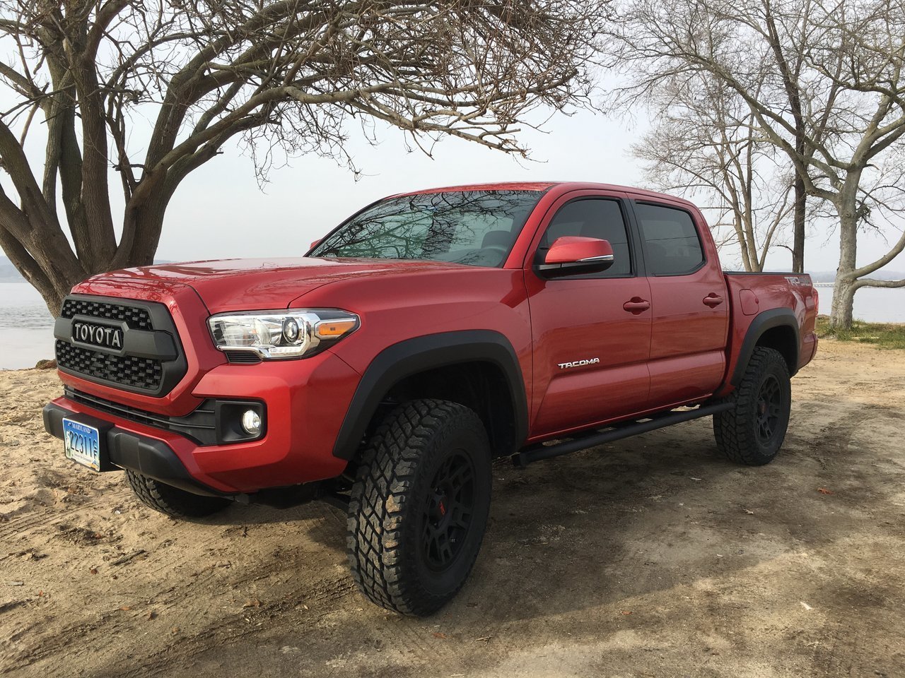

    Gents,
    My 887 are great and my 5100's in the front really made the truck sit up nicely. I did the ICON AAL and left in the helper spring in the rear. I figure i got about 2.5 in the rear and a solid 1.85-2.0 in the front. Love it!
    I purchased 285.70.17 NITTO Ridge Grapplers. They are superb.
    HOWEVER, I would like an extra 1/4 to 1/2 inch in the front. Should I do a 1/2 inch spacer or should I got to the #1 position on the 5100's which says it adds .65 of inch?
    If I go to position #1 can I keep my 887's?
