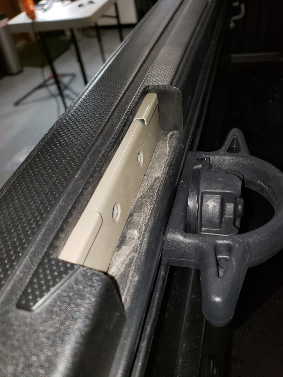

    Purchased OEM tonneau from someone on CL and have all latches and supports but no bolts or front plugs. Does anyone know these bolt sizes? I also figured out very quickly that I have non Tonneau cover bad rails therefore the cover will not work. Does anyone know the part numbers for rails and front plugs and cost? I am sure I could just cut into existing rails but if the right rails are reasonable I would prefer to just order them.

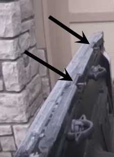

    I think those bedrails are like $200. Just cut them. Someone priced out the hardware. It’s not cheap either. Search function for the thread. If I find it will link it for you. Hope you got a good deal on it.

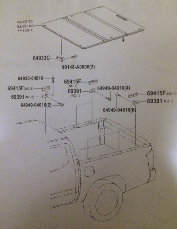

    Here are the part numbers. Good luck
