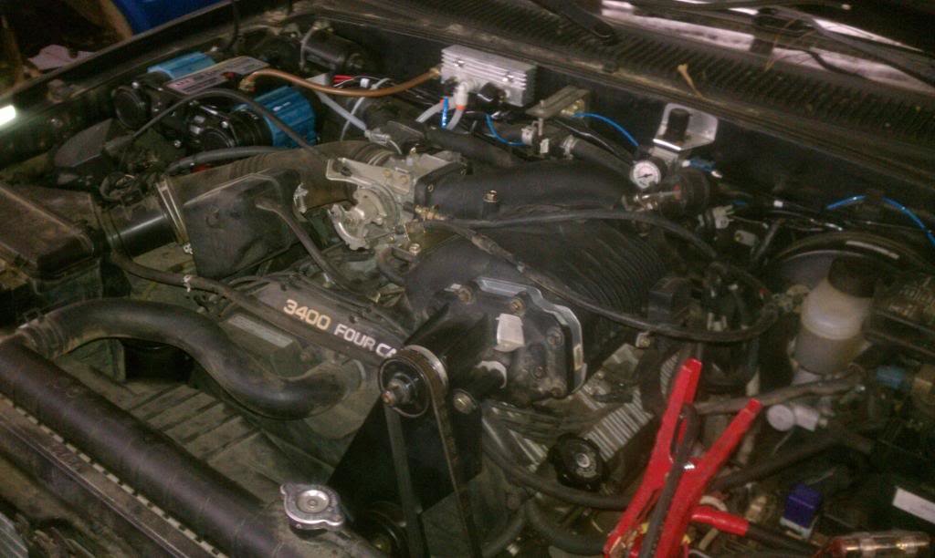

    Look...it's a bird! It's a plane! It's... SUPERCHARGER!
    She is all snuggled up and ready to be worked out. Of course when that wobble hits you just don't want to drive it any faster. Acceleration is acceptable from a start, but yeah, you for sure will want to take the truck to the dealer to get the ECU flashed for the supercharger. I can't take her on the roads obviously, but a few short back streets behind the shop have allowed me to verify engagement and operation. She is a bit louder than I expected, but I have not heard another SC Tacoma for comparison.

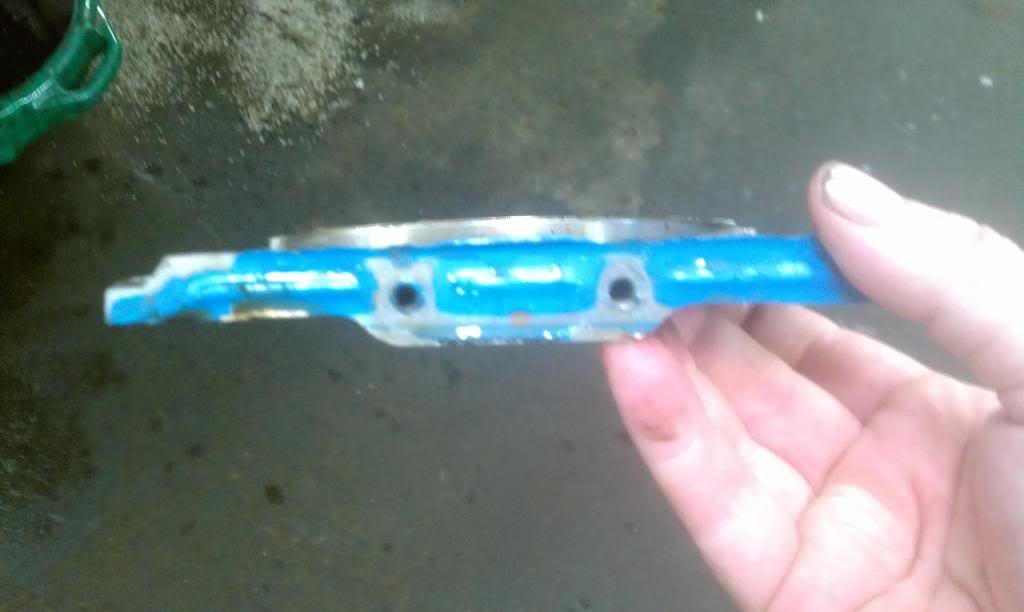

    Rear seal oil leak appears fixed. The seal itself was hard, and cracked on deflection. Also the seal housing was not sealed up well and added to the leak.

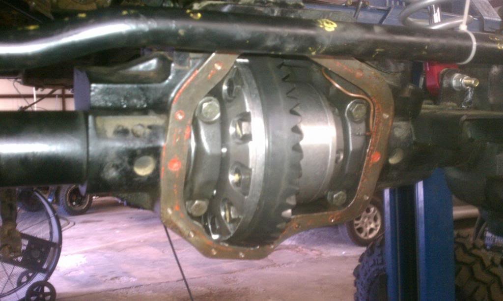

    Zip locker installed in the front:

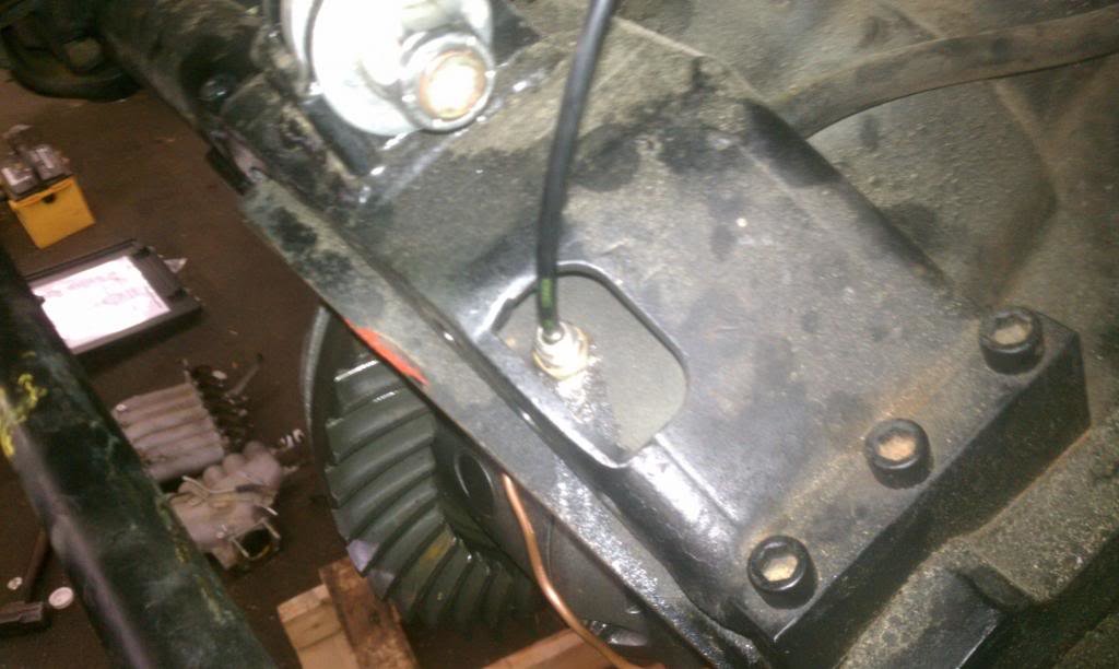

    The current thing that I see right now is the air line that supplies air pressure to the front lock solenoid's pressure regulator keeps blowing off when compressor pressure builds up above I believe 150. It is a similar connector the the one that goes from the control solenoid, but is for the larger blue hose that came with your ARB compressor I believe. I am not sure if it has to do with the underhood heat or not. I am looking at this while we wait for you to be able to come down and pick her up. Also, I was right on the rear leaf springs. I swapped then left-to-right and that really bad lean is no longer there. It still has a slight lean, and measurements indicate some of that is due to a torqued bed, but it looks NOTHING like it did when you brought it down. I hope you will be quite happy with the results of everything we have done here.
