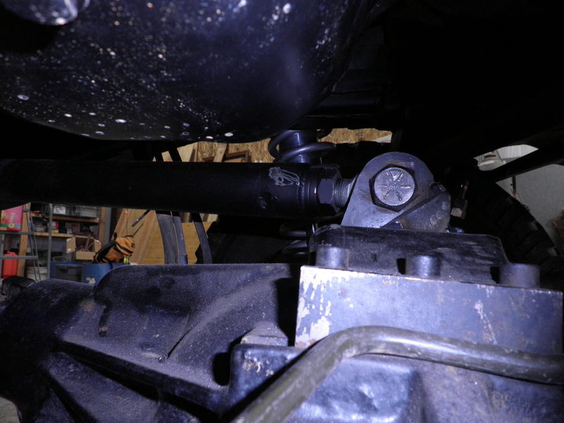

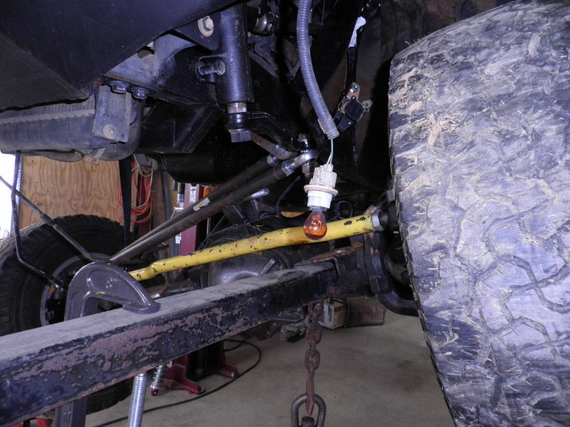

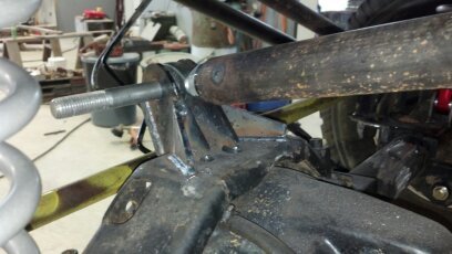

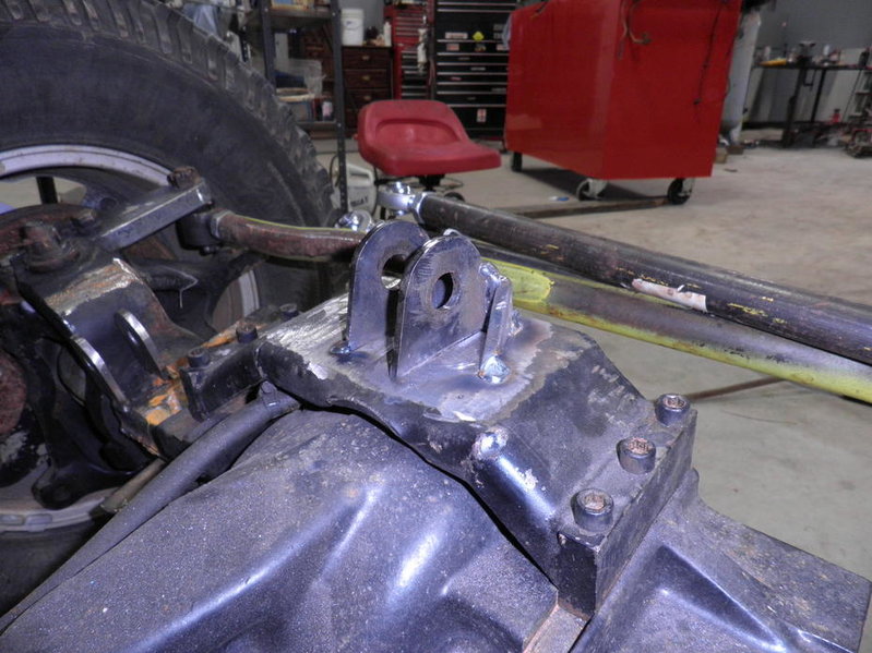

    Got back up there and did a little more on the truck last weekend. I remade the upper link mount...stuck it in the chop saw and cut about an inch an a quarter off of it. It clears the panhard and oil pan better now.

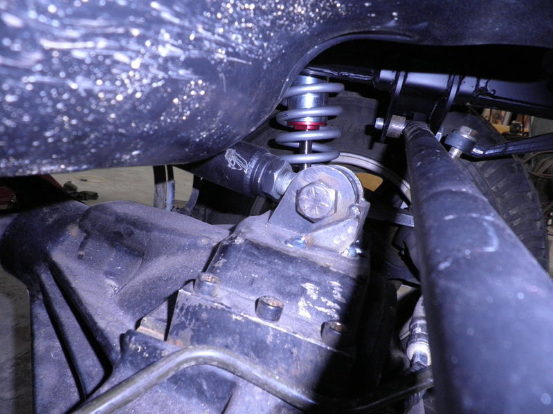

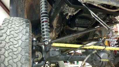

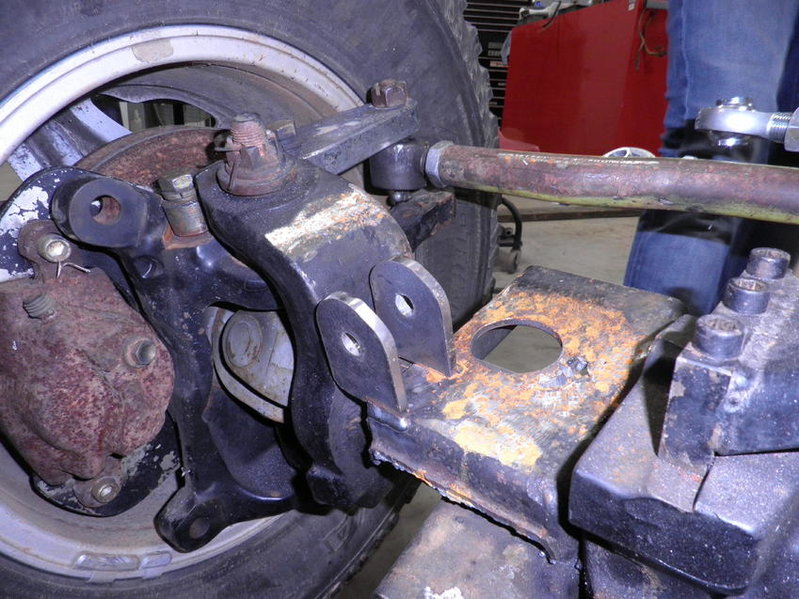

    Had to move my lower shock mounts,the shock was binding at full droop. Moved it about 3/32 back and angled it a few degrees now it cycles without binding.

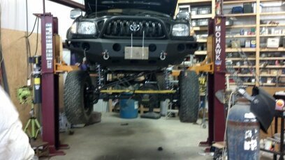

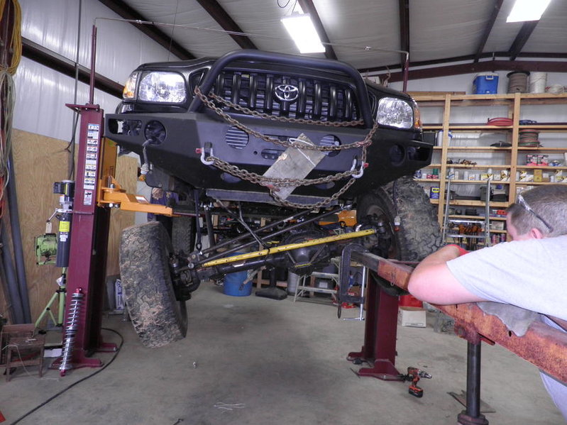

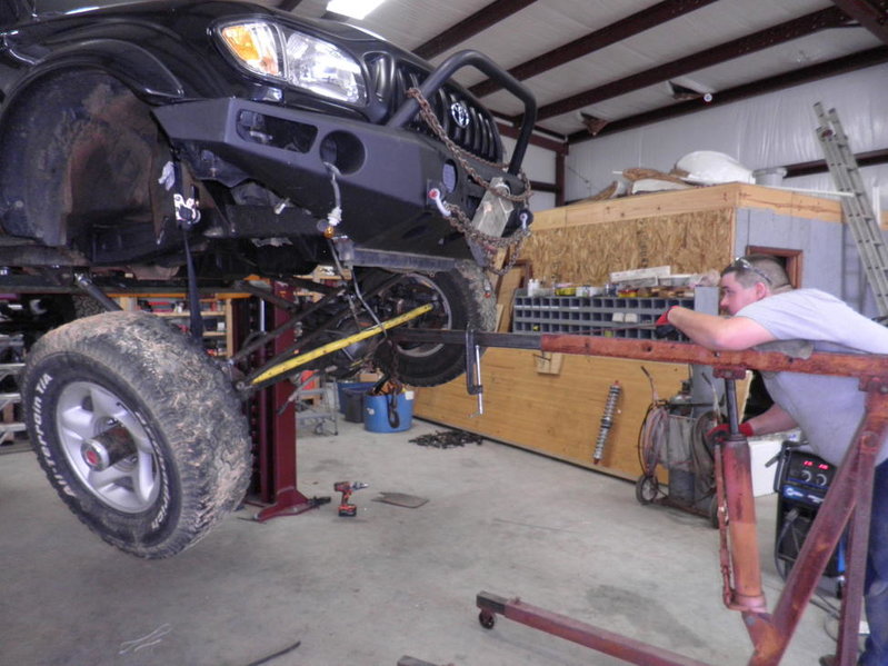

    A few pics of us cycling the front to check clearance. The last two are sitting flat on the floor. Only have about 4 inches of up travel with it set where it is but that's with the least amount of lift you can set it at. How much up travel do you other sas guys run? Right now my frame is at about 22 inches but that's with 31's....

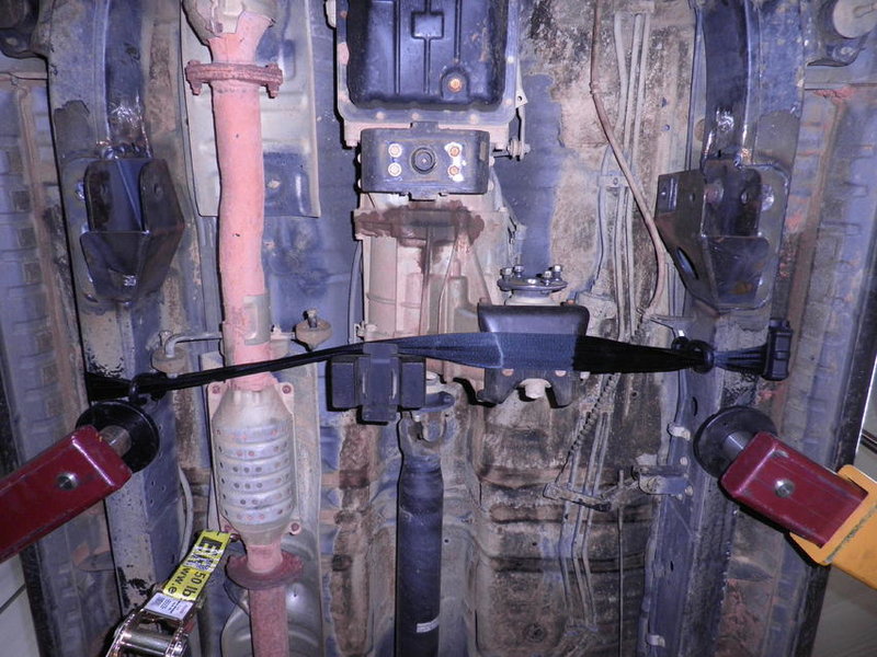

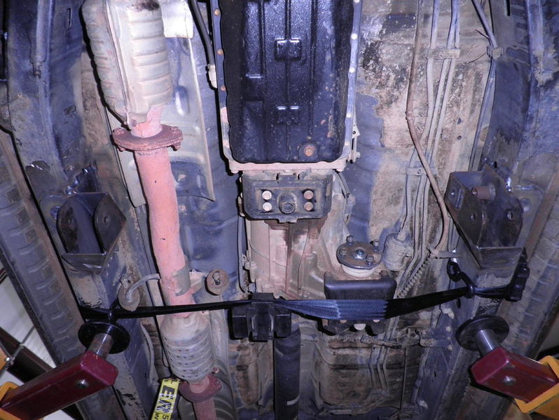

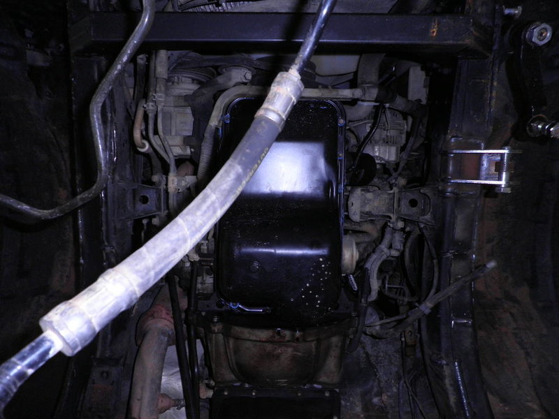

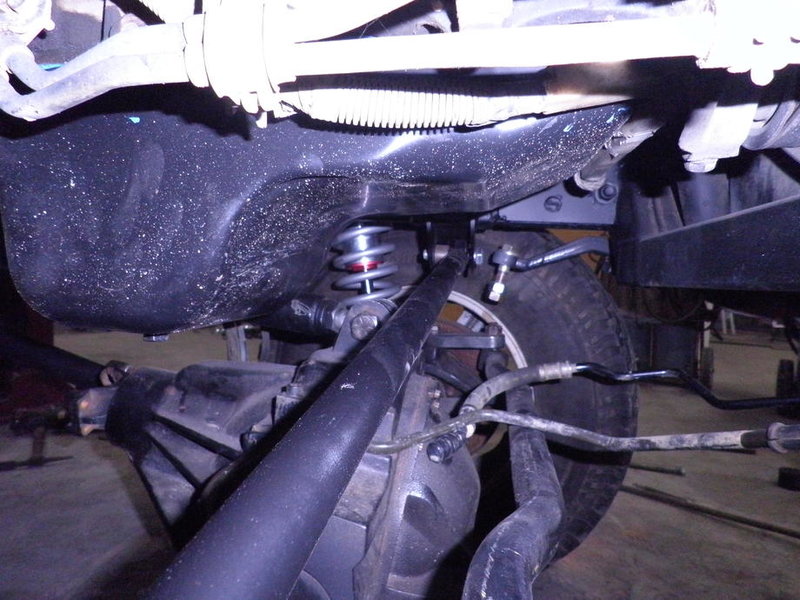

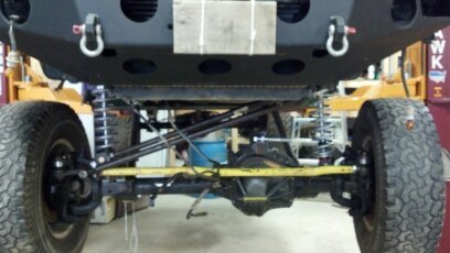

    Here is a few pics of the underside of the truck if anyone wants a reference pic to see how everything is laid out under there. How you like that high tech ratchet strap crossmember? I ordered one from FROR today,I was going to fab one myself but screw it I'm ready for this thing to be done. Oh yeah and a big freaking rock balanced on top of two more.
