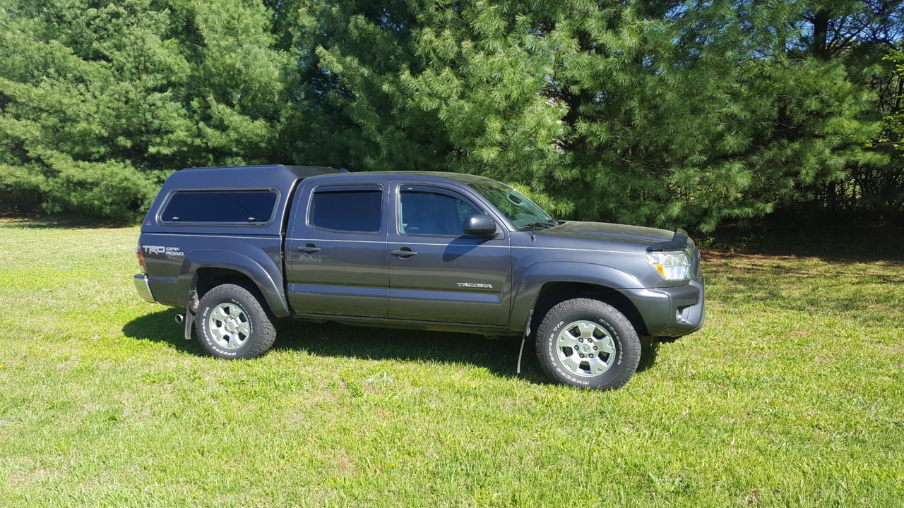

    I think you will need sensors from a 2nd gen truck... my understanding is that 3rd gen sensors will not work on 2nd gen trucks.
    I put 2018 TRD OR wheels on my '15 TRD OR... I used the original sensors off the '15 factory wheels. They work fine.
    -Bear

    I went from this...
    I just swapped the old sensors into the new wheels.
    -Bear
