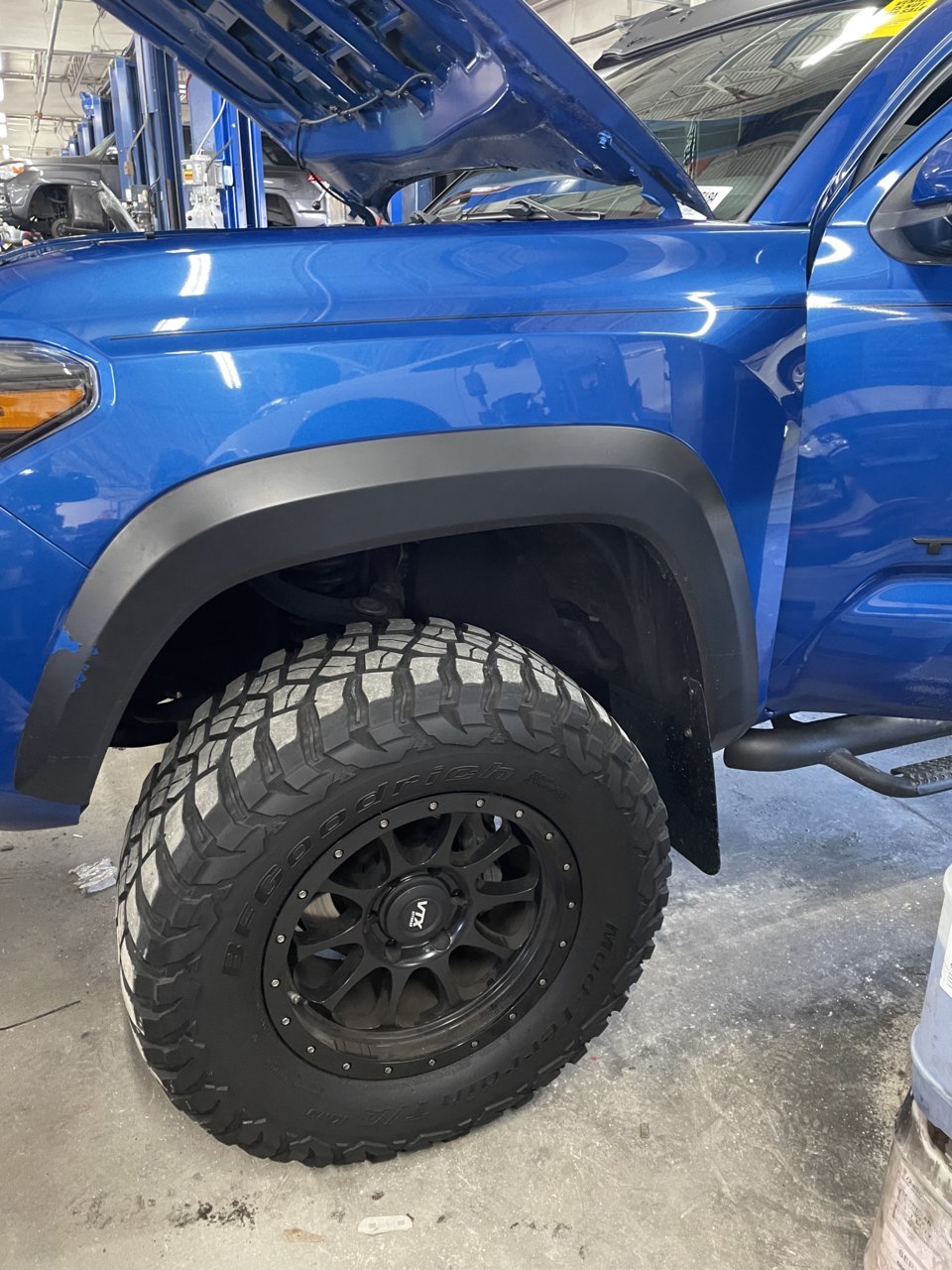

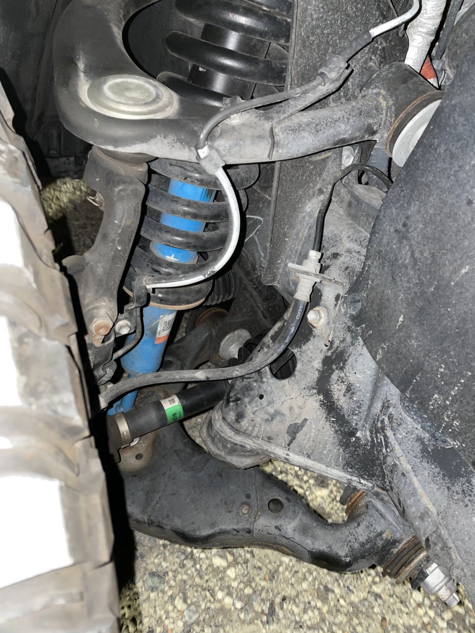

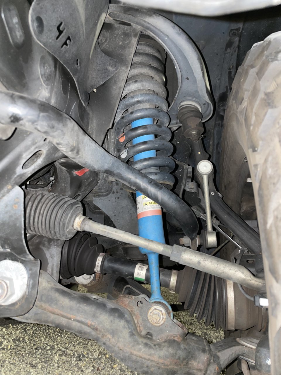

  9. Feb 15, 2022 at 5:30 PM
    lboswell3
    lboswell3 [OP] Active Member
    Feb 15, 2022
    #390248
    26
    Logan
    2018 Tacoma TRD sport 4x4
    This is front

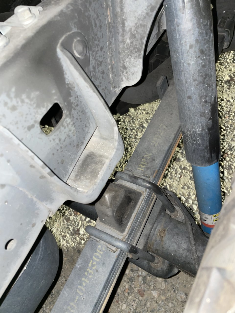

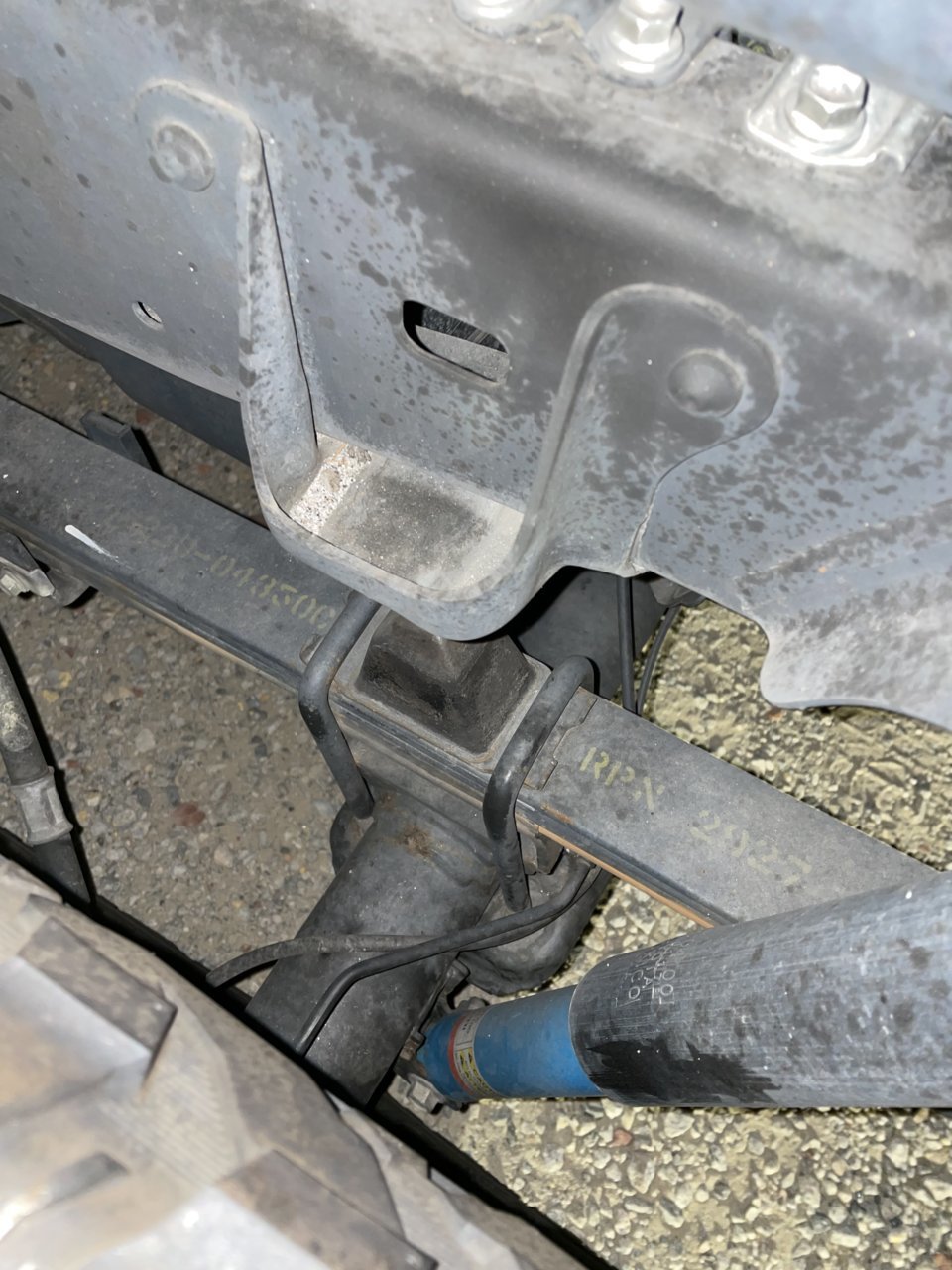

  10. Feb 15, 2022 at 5:31 PM
    lboswell3
    Feb 15, 2022
    #390248
    26
    Logan
    This is back

    Kings, Dakars, SPCs, 33's, Mobtown Sliders, TRD Skid
    That all looks stock, but I can’t see the places where the spacers would be. We need to see a picture of the top of the front coil overs where they connect to the frame.

    Lots of dust and custom dents, Check Build
    Sure looks like a block in the back, and most likely a spacer in front.
    OP, we need pics of the leafs taken closer to the axle, and the top of the front coilovers?
