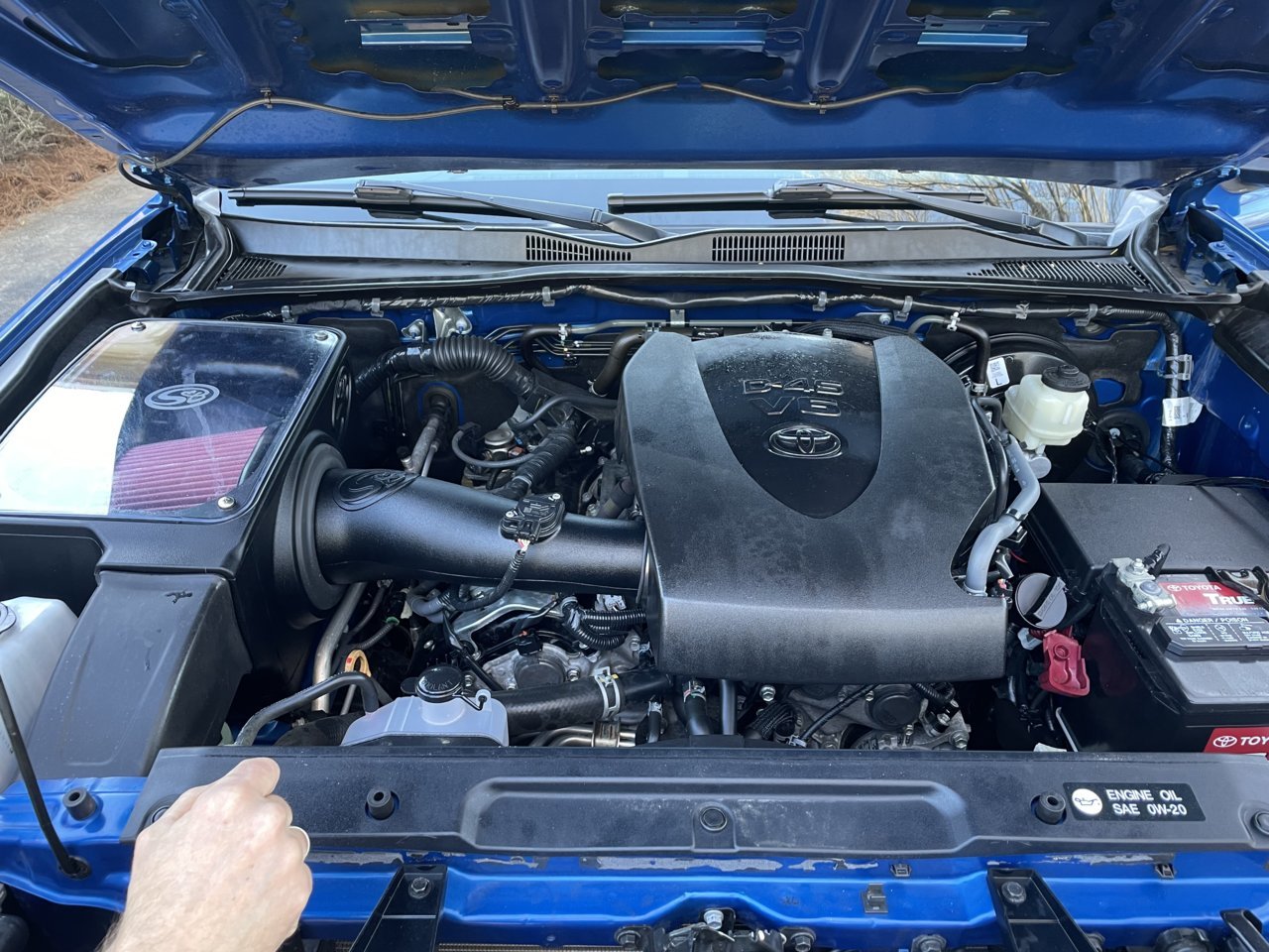

    Would this be it?

    That's actually a decent intake. Basically, this helps the truck take air into the motor better. Simple as that. It's heavily debated if these actually do anything besides make cool noise, but hey, who doesn't like cool noise!

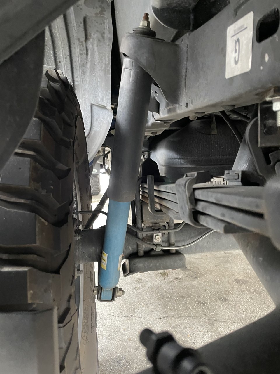

    OP, the block will be sitting on the axle. Take a picture of where the leaf springs meet your axle, then we'll know for sure.

    No, if the ECGS bushing were the fix, you would be vibrating in 2wd, and the vibes would go away when switched to 4wd, but vibes would still remain when switched back to 2wd. Next place to look would be the tires. BUT, if you're claiming you have no vibrations at all now for some reason, and the issue somehow fixed itself, I think we'd still be leaning towards you had a tire out of balance, maybe from a big rock wedged in the tread somewhere and it finally dislodged itself, caked on mud on the wheel, or who knows. If you're satisfied with the way it drives now, great! If you still get vibrations/steering wheel shake only at certain speeds, have the tires balanced. Otherwise, enjoy the truck and feel free to ask questions!
    The leaf springs are these:
    If you have a "block" lift to lift the rear of your truck, it would look similar to this:
    Exactly as it sounds, a block of metal or hard plastic/rubber that sits underneath the leaf springs, on top of the axle. Its easiest to see this from underneath the truck looking from the back of the truck towards the front. The thickness of that block is the amount of lift you have in the rear of the truck. If you don't see a block there, and the leaf springs are sitting directly on the axle, you may not be lifted in the back. Its not uncommon for people to have "leveling kits" installed, meaning they're just leveling the front of the truck with the rear (because the rear is a little bit higher than the front when its stock- thats called "rake").

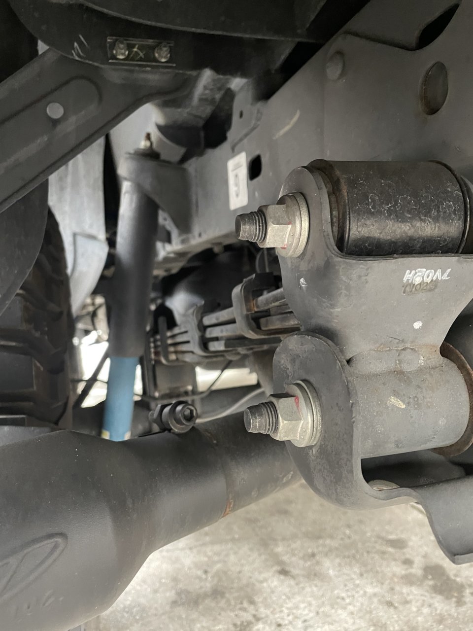

    Feb 15, 2022

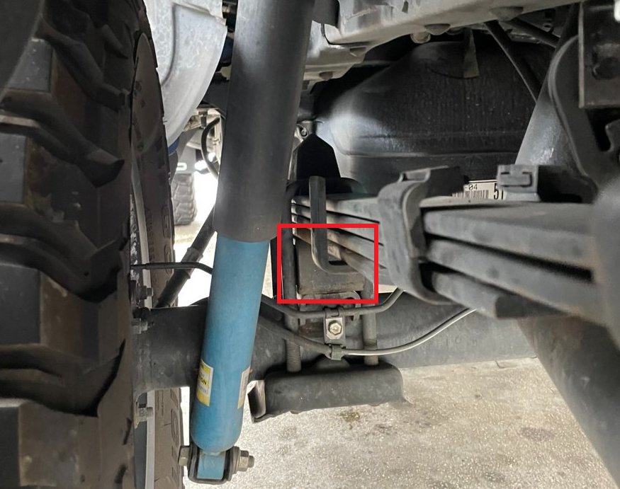

    There's your block for the lift..
