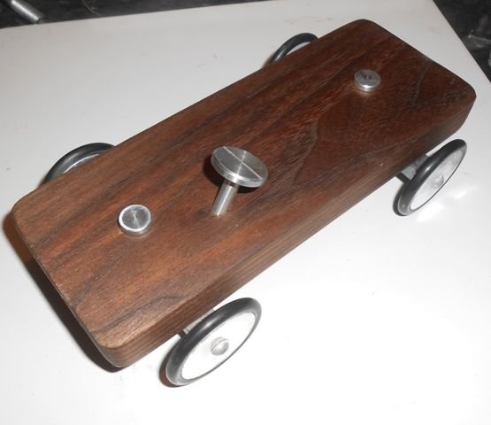

    As I suggest to anyone that misunderstands the alignment concepts what appears to be a toy is the best demonstration tool that shows the effects of improper alignments -
    I remember arguing with someone over alignment angles and what causes it because there was a time that I thought much like you. The guy grabbed the car and a piece of paper and the argument was over because you can see in black and white (literally) the effects.

    Toe and camber both cause alignment wear. Caster is the only measurement that does not directly cause wear but it can impact cupping because it impacts the vertical movement of the tire.
    We are on the same page with my resistance comment but I half-assed it and didn't phrase it right - the force against each tread block experiences is not the uniform all the way around the rotation. As a block comes into and breaks contact, in the case of taller blocks that have larger gaps between them, the leading and trailing edges experience larger changes in force that more rapidly cause the uneven wear. The outside blocks are the least supported (and protrude more on AT/MT tires) and thus show it much worse than typical all-seasons would. This all has nothing to do with alignment or even suspension, it's just the nature of these tires.
    Also that toy is an abomination and is a bullshit device the big chains use to "inform" people incorrectly. It doesn't demonstrate anything but toe and it only does that half-assedly even if it's one of the better ones.

    Samurai Tech
    Samurai Tech Well-Known Member
    Feb 12, 2017
    #210363
    58
    2017 Tacoma SR5 Dbl Cab 4X2
    That wooden block with the o-ring tires was a sales tool for the service advisor to demonstrate how a vehicle would track if the front or rear toe in was out of alignment. It may have been supplied by Hunter Engineering. Haven't seen one of those in years. The four brackets the wheels attached to would move independently so you could demonstrate say a vehicle was "dogtracking", or the excessive rolling resistance of a vehicle with excessive front toe-in.
