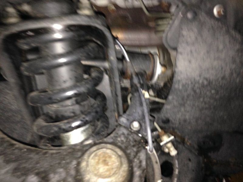

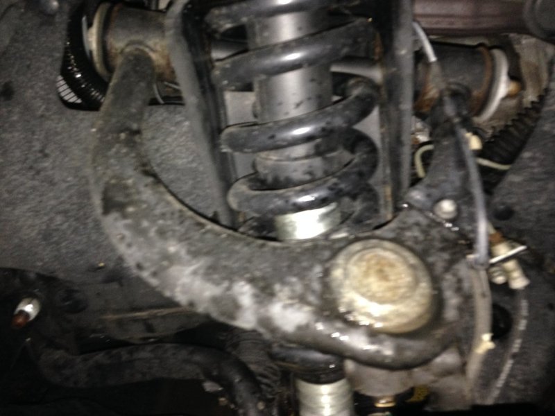

    I'm surprised nobody mentioned this already, but sounds like your spring perches are mounted upside down.

    You know...now that you mention it I think his spring perches might be on upside down ?

    Yep there upside down ,,,will this screw my truck up ?

    There on the 2nd ring

    Not all the way up

    Ok so if I flip them over and put them all the way up what size block in the rear ? It was a bitch to get level already went from a 2 inch block to a 3 inch

    Sure does look like there are two rings exposed which means you are on the 3rd. You basically turned it into almost a 4" lift and that collar is weak that way. Your OE suspension can't go higher than 3" ( really 2.5 ) and have any decent geometry left IE: alignment. You will gain some ride quality back when you flip it back over but you will need to get another alignment too....then lower the back end, ditch the block and get an AAL

    Shit ,,,

    Grrr I had my mechanic install the shock and when I originally did it I had a 2 inch block in the rear and the truck was nose high and I had him replace the two inch block with a three inch now it sits perfect so now I gotta go in reverse and figure out what block for the rear ... Grrrrr

    I hope my springs are ok they are so compressed for like 6 months now
