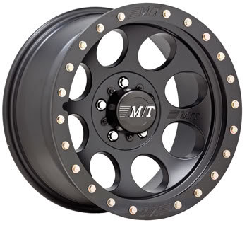

    So Im ordering these Mickey Thompson Classic Lock's in black. The only 17" of this rim they sell is a 17x8 with a 4" back spacing. I want a 3.5 back space but will a 4" look good, does it make that much of a difference?? And i DONT want wheel spacers...Im smarter than that. But Let me know what you guys think about the MT's

    What size tire are you planning on running?
    Do you have a lift? If so how much?
    EDIT: NM on the lift. See in your avitar u have 2.5" kings

    I have the 2.5 kings set at 1.5" in the front

    Ok. But what size tire do you plan on running? That's the real question that needs to be answered.;)

    I would like to try and squeez a 285 in there. If not just gonna stay at 265. Im still deciding.
    EDIT: Not 17"....I ment to say 16" in the thread title. My bad.

    The sweet spot for 285's for your truck is a 4.5" BS. Anything more and you'll rub the frame/sway bar. Less BS pushes the wheel father away from the hub. With a 4" BS you'll clear all the internals just fine, but you're going to rub into rubbing issues on the front fender and the cab mounts. Both are completely fixable with a grinder, zip ties and a big fucking hammer though.
    Do some searches on cab mount chops.
    EDIT: Damnit I can't type today. You'll have to trim the fender LINER, not the actual fender.

    Will do. Thanks. Have you done this to a 2nd gen or just ur 1st? Sick truck BTW. Gotta love 'em KINGS they have never let me down.

    At a 4" BS you will for sure have to clip the fender liner. If I were you, I'd bring up your kings to 2.5-3". You might be able to get away with not doing the CMC, but it's pretty easy if you have access to someone with a welder and gives you extra clearance in full lock/compression situations.
    I'm very happy with my kings in the rear and the fox's up front. :cool:
