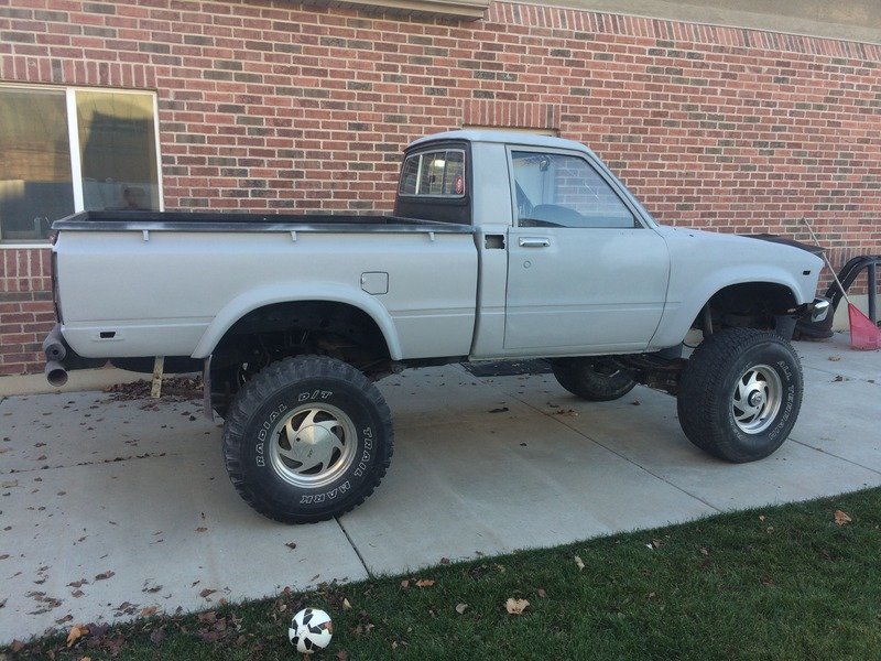

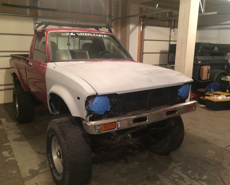

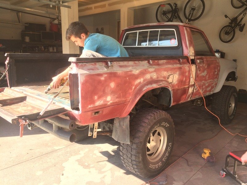

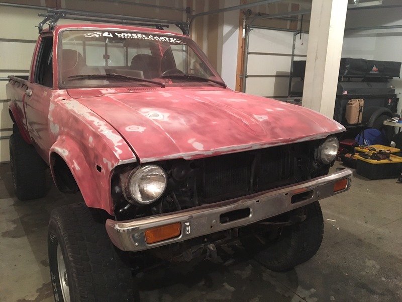

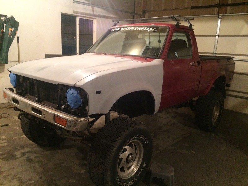

    Making some progress. The deeper we get into this truck the more evidence there is that it's been "well used" and will never be a candidate for a show truck. But we weren't after that in the first place since it will be a first car for my 16 yr old and I'm sure will not only get used on trails but probably get tagged a time or two by careless drivers in the high school parking lot.
    Hood and fenders and roof are sanded and primed, trimmed the front fenders since we removed the lower valence.
    Cleaned up and did some fixing of the biggest dings etc on the passenger side and got it sanded and primed. Bed is getting wire wheeled in prep for some monstaliner. Hoping to get the driver side to this same point this week.
    Windshield is getting replaced on Friday.
    We're having unusually nice weather here this week and it would be awesome to be able to get paint on this thing this week, but I don't know if I can pull it off. I leave on Saturday for the Baja 1000 with Canguro Racing so we'll have to see how the week goes.
    943CA7B5-ECC5-4AB6-8D63-57E22324F0CF_zps_f4f1058555d569b2a7109aa907fc95de9ab7776b.jpg
    ABA6EF69-DB57-4DB0-814C-EF0EB48B920A_zps_c461e716ae0a400876216e3a842249ba77abb01e.jpg
    1C55823A-9264-4B0A-BFC0-93BB86BD0815_zps_de6c94b5a5d77ce827364a9b354da0f36eb97ab0.jpg
    7A9CD342-1FFA-4AF7-BB6F-47560EC70383_zps_03d8feb56a5c695fd02c9091f5f671f4119dfef6.jpg
    6364B9BE-20E9-42A6-BAA6-C3C60DFD557C_zps_e3431923b371c85c10b792f16511141788389563.jpg
    738E93D6-1EDA-4B69-B6D9-3AD5523B8551_zps_a44b810945a1db94992a801f489ca5f58ca17d13.jpg
    739C4134-597B-497E-B6D8-6B734D5D32A9_zps_cb2460eb656a9763ff12d786471d21b9fae019bb.jpg

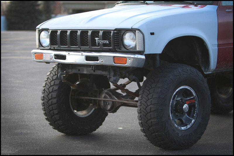

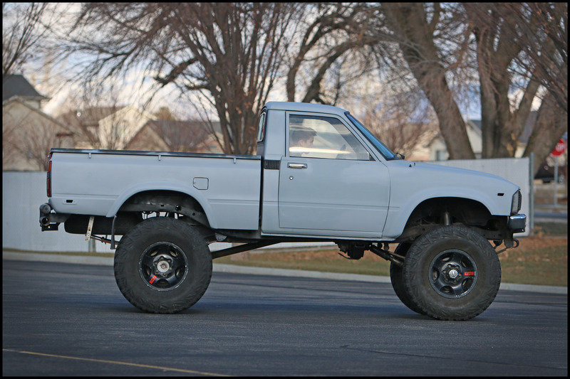

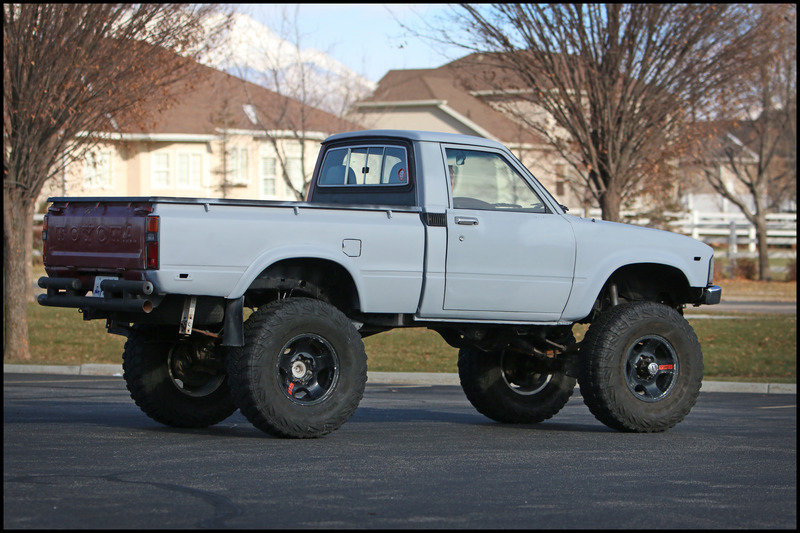

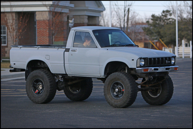

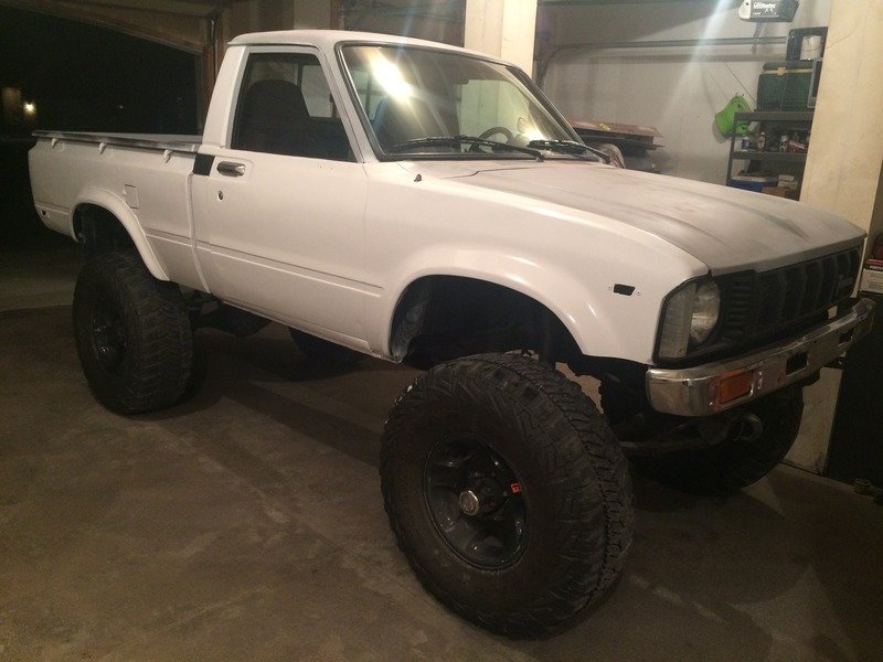

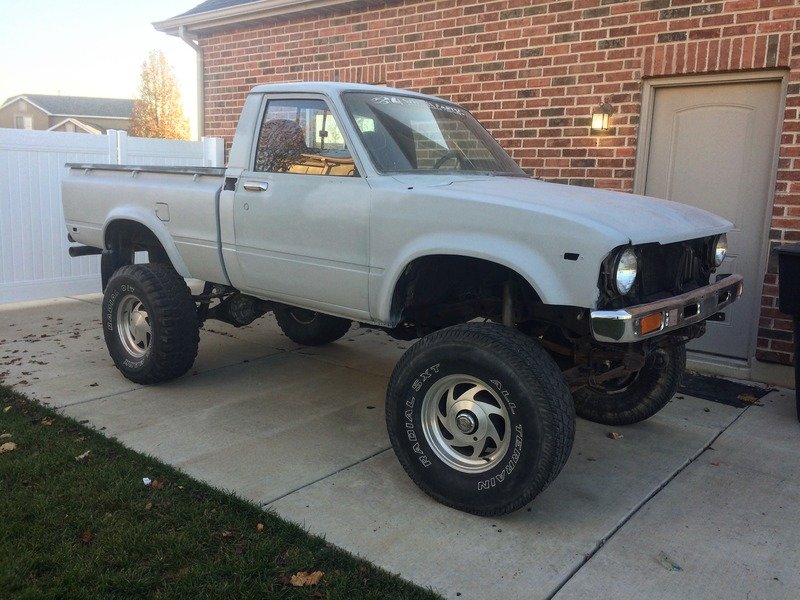

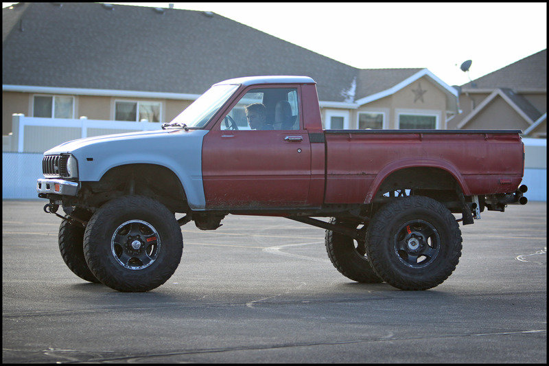

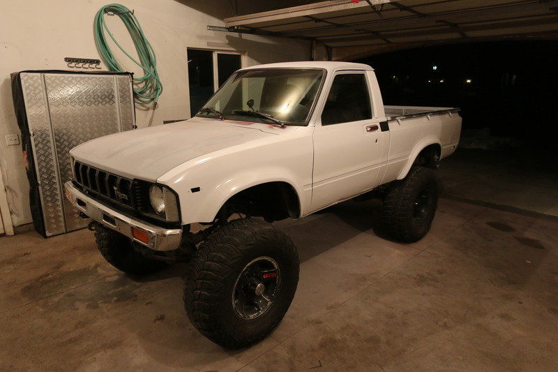

    Not much time to work on this these days with the holidays and family stuff happening almost every day it seems. But I did get a few hours over the weekend to do a couple things.
    Got the MTRs pulled off my 80 and mounted back on the factory 80 wheels. The 80 wheels are still a bit chewed up from their last trip, but we'll get them cleaned up and repainted soon. But we got them swapped out with the stupid wheels and 33's that were on the Hilux.
    The 35's look so much better IMO. We still want to get the lift a couple inches shorter. The 63" chevies in the rear should work well and I'm looking at pulling one of the leaves out of the front Skyjackers to see if that drops the height a bit and also rides better. take a look at the thick 2nd leaf in those front packs. :confused: Anyone think the main leaf will have problems toward the eyes without a leaf adding support farther out?
    Obviously we're still working on body work. I was able to get the tailgate cleaned up and prepped after these pics were taken so we're down to the driverside door and bedside and it will be ready for paint.
    Here's a little better shot of how we modified the grill. We kept the outer edges of the old grill (gills) to fill the gap between the headlight buckets and the narrower '83 grill. Works ok IMO. This is a better view of that 2nd leaf in the front too.

    How does the truck feel with the larger tires?
    Your front leafs have a good arch to them. Do they flex well or are the leafs too thick for good flex?

    Drives great with the big tires, other than it's still manual steering.
    All of the springs are garbage. We'll be using some 63" Chevies in the rear (already have them), and either pulling a leaf out of the front or swapping them for something else. Trying to get it about 2" lower. I have some killer 12" travel shocks for it for when we get the springs dialed. Should ride and flex really well at that point.
