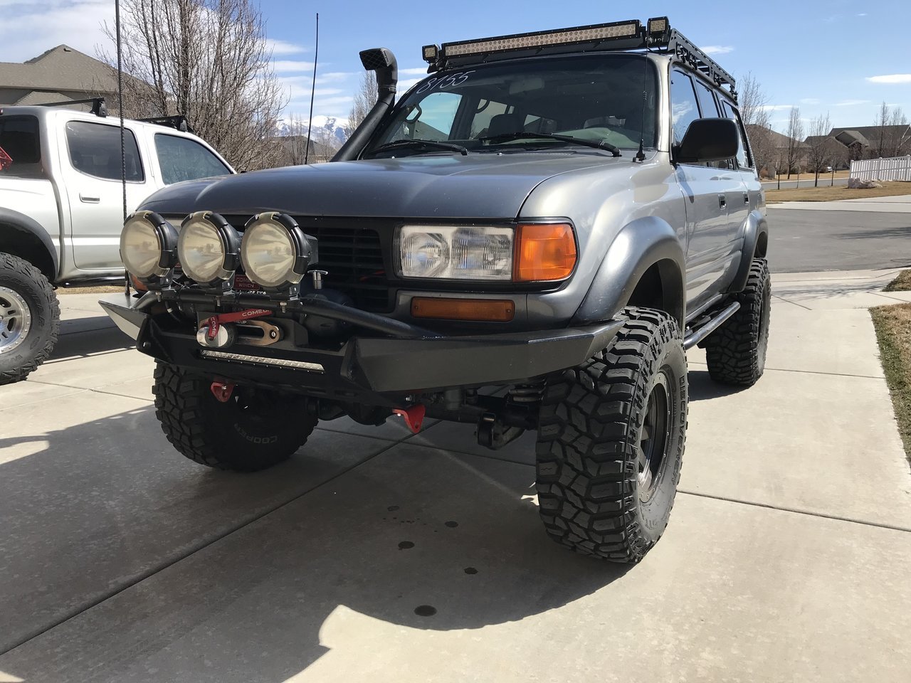

    [​IMG]Untitled by Adam Tolman, on Flickr

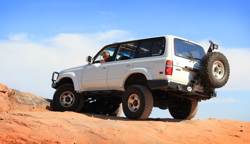

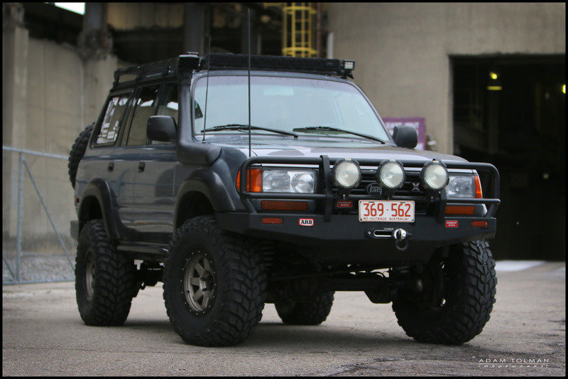

    Here's my old 80 to give you an idea what stuff will come off of it.

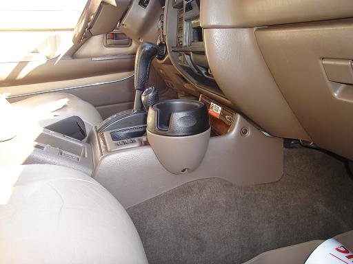

    Starting out big with the mods. :) Everyone knows that 80s are in dire need of cup holders. So I picked up one of the popular Land Rover Discovery cup holders to add to the truck after I pick it up on Saturday.

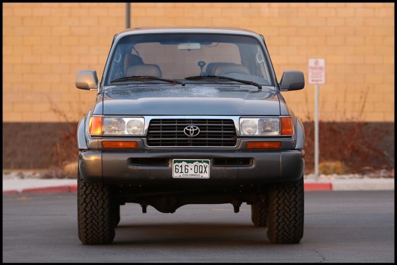

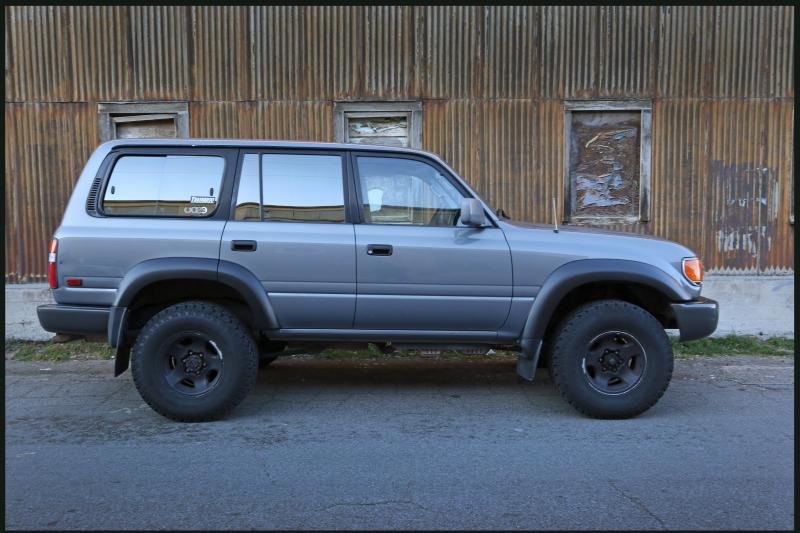

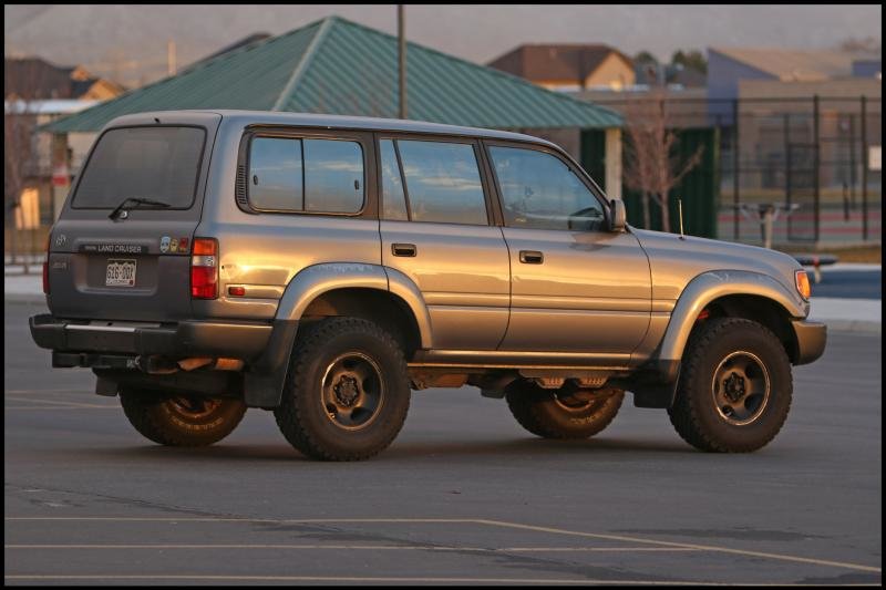

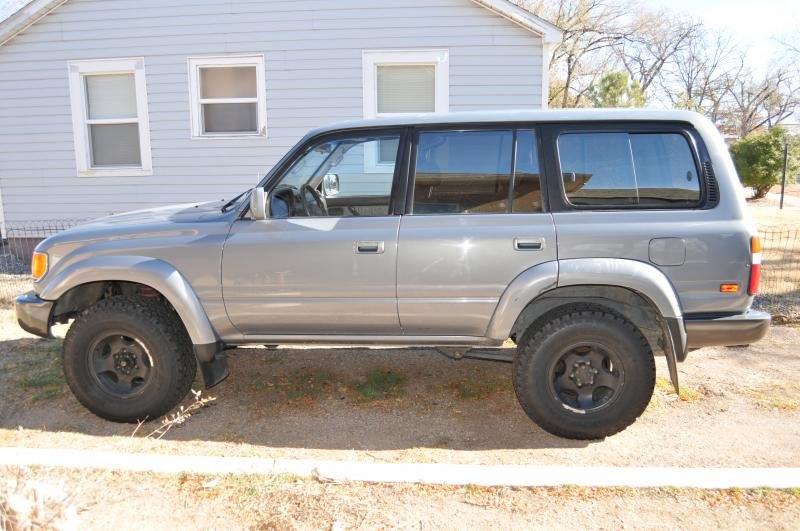

    Got the 80 over the weekend and we got it home last night.
    There are a few dings etc consistent with what you'd expect from a 20 year old car. Like a lot of 80s the front seats were trashed, split leather and bad foam. Before going to get the truck I got a lead on a pair of front seats in decent condition that were at a shop there in GJ. I arranged to go take a look at them after I bought the truck. It worked out great. It was a shop I'd never heard of called Metric Offroad that specializes in Cruisers. They had 20-30 trucks in the yard at the shop and the owner said he had another lot with another 40 trucks. A whole range of trucks from 40's to 80s and some 4runners and minitrucks too. Really cool guy and the seats he had were pretty dry but the leather was fully intact. We worked out a good deal on them with my new bad seats as partial trade. So the worst thing on the truck was fixed before I even got it home.

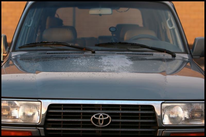

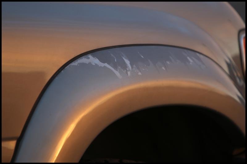

    The rest of the issues with the truck are mostly cosmetic. The clearcoat is peeling on the hood, roof and flares. The front axle needs to be serviced and a couple other minor things looked at but it runs great and everything works. Even has lockers. The drive home was nice and it felt soooooo good to be back in an 80. The plan is to swap everything from my '93 over to it in the next few weeks. I'll use my OME J spring suspension, bumpers and sliders. I've ordered a set of 345/75R16's to go on the OEM wheels. So it should be ready to rock within the next month. My old 80 will get the suspension from this truck and keep the 315's that are on it and get the stock bumpers and then get sold cheap.

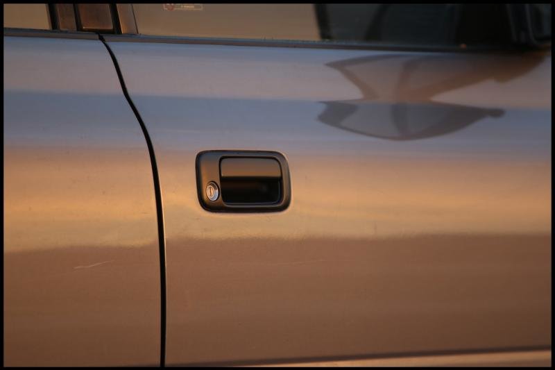

    I already started cleaning up a few things. I painted the handles and the flares black and it is looking much better. I didn't get pics with the flares done yet so all you get is the handles.

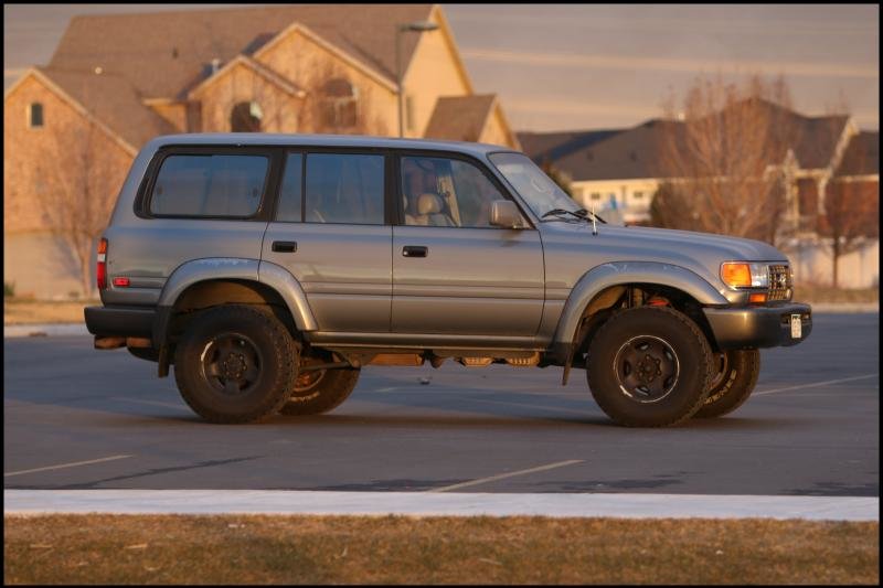

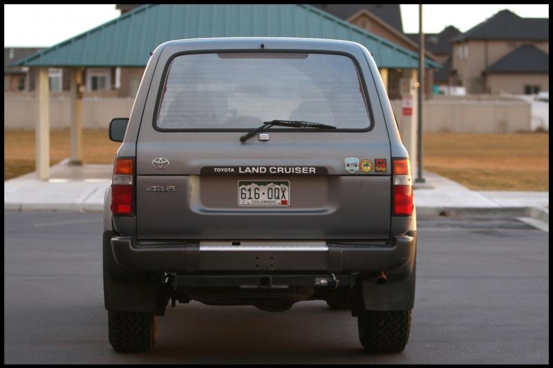

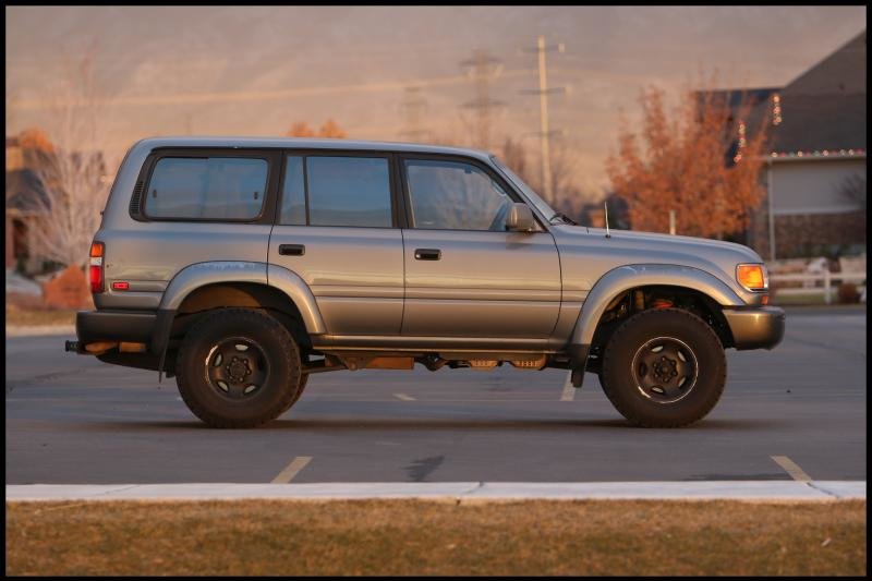

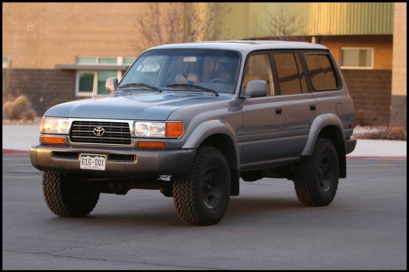

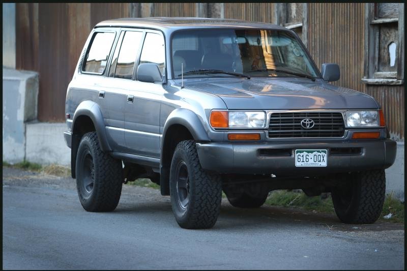

    Here's some pics from tonight.
    blacked out handles
    peeling flares
    peeling hood

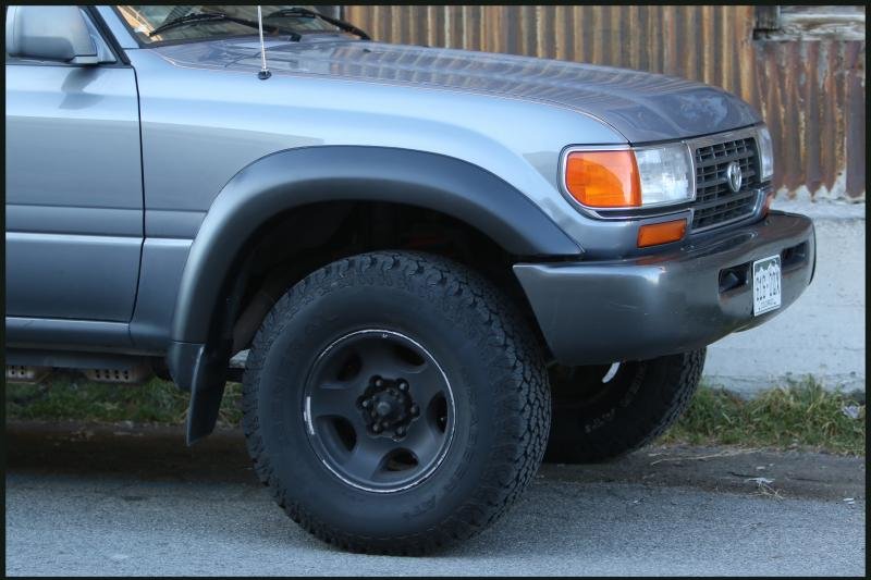

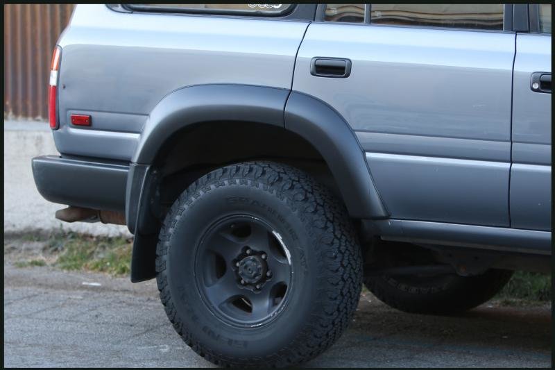

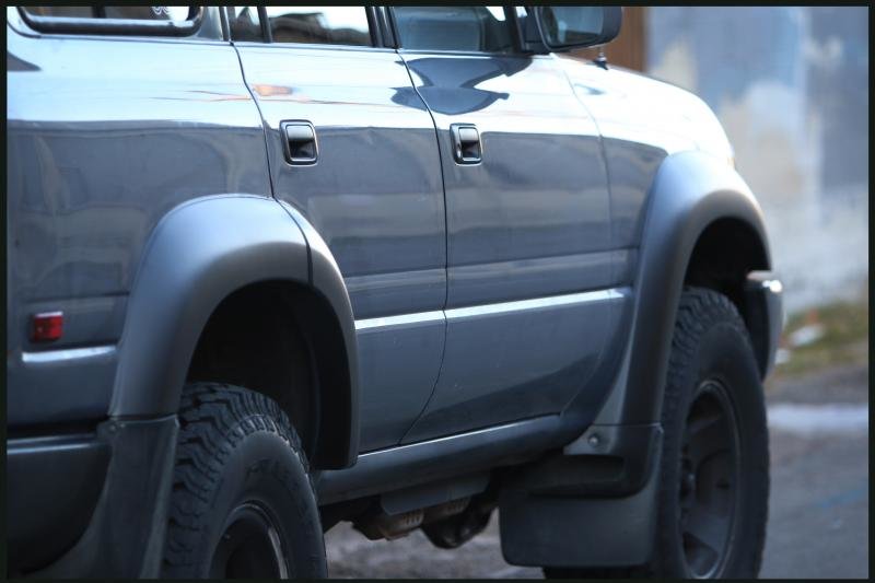

    Was able to get a few pics this morning of the painted flares and a few other small things I've been able to address since getting it home on Saturday. The flares cleaned up nicely I think and look good with the black handles. There are a few interior shots too to show the seats. First off the flares.
    Before:
    After:
    Before:
    After:

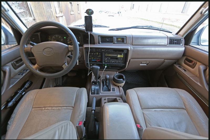

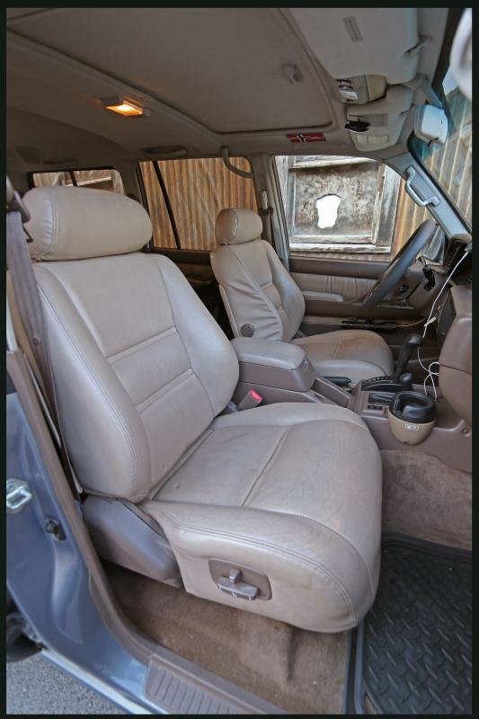

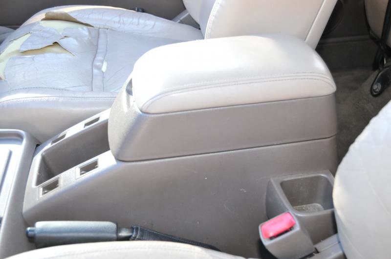

    Now the seats. This is the only photo I have of the original seats. Both front seats were similar condition. The leather was torn and the foam was deteriorating badly.

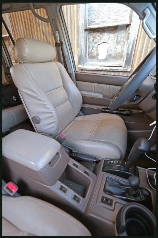

    These are the seats I was able to replace them with. They came out of a '97. Like I said they are pretty dry right now, but I'll try to soften them up with some conditioner over the next few weeks. Power features work perfectly and they clean up the interior feel quite a bit.

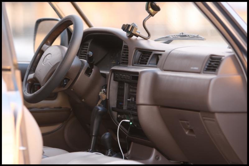

    So a bunch of small things for now. Like the cupholder, cover for the steering wheel and some new floormats. I've got a crazy week this week so I'm not sure exactly how much time I'll have to start tearing stuff off of my '93 and getting it onto the '95 but I hope to find some time. One other little hiccup is that the 345 KM2s are on backorder so I may need to wait a bit for those.

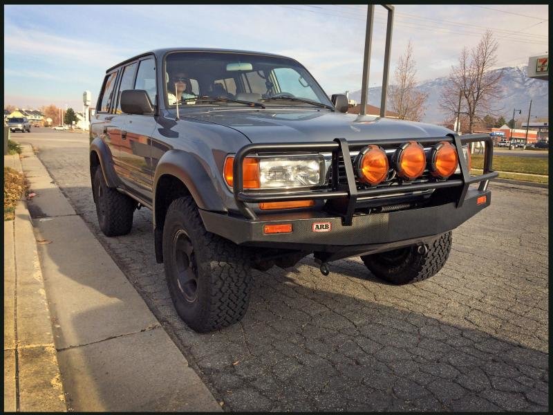

    Looks like everyone all over the country is out of the 345 KM2s so I've had to change plans on tires. Decided to go with some 315/75R16 Goodyear MTRs for now. They'll be a bit more driveable for now until I get the gears done then I'll look and moving up to 37's. The MTRs should be here right around Christmas time so it will likely be the first of the year before I've actually got them on the truck.

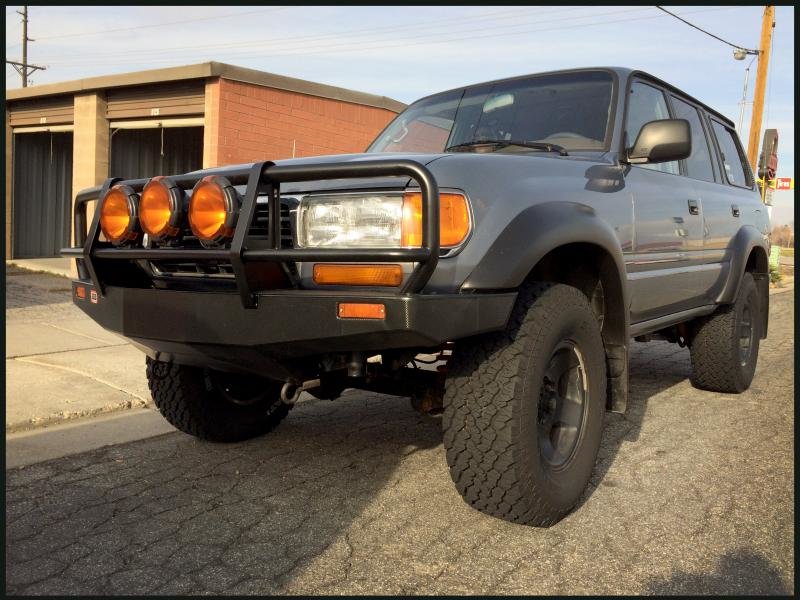

    I did however, get the ARB bumper off my '93 last night. The bumper has definitely seen better days. For starters its a modified bumper with all the lower skirts cut off. I like the better clearance it has. It's been well used on my '93 for more than a decade so it's got a couple of little dents and tweaks. Also since it's been sitting on the side of my house for a couple years the weather has been working on it and there were some rusty spots. I got it pulled off a couple nights ago and cleaned up. Sanded it down to bare steel and rattlecanned it with Rustoleum Satin since it has a finish that looks similar to the original powder coat. I got it mounted to the new truck this morning and moved over my HIDs from the Tacoma. It's starting to look a bit more like a real cruiser now.
