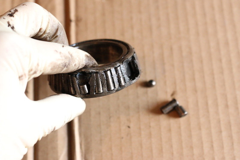

    Do you think this bearing is ok to reinstall? ;)

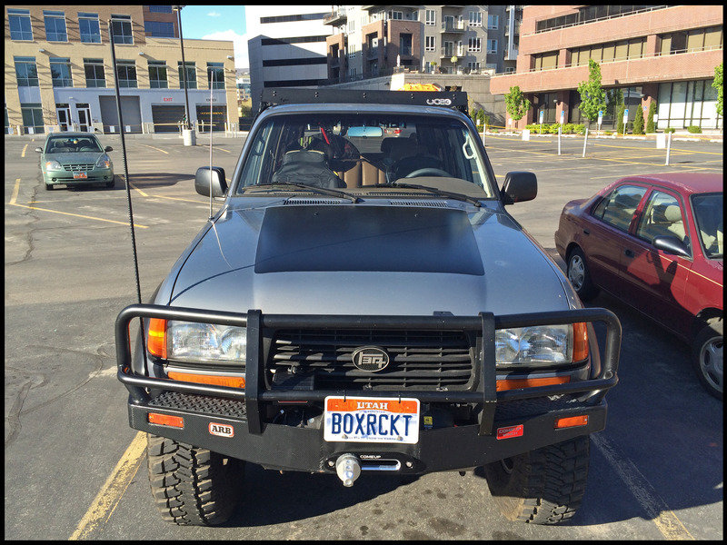

    No cover plate at the moment. The bumper had been modified heavily by the guy I bought my old 80 series from (bumper came with that truck). I'll fab up some kind of cover soon to protect the winch line.
    The license plate is permanent. It's bolted to the front of the bumper using the lower plate holes. I don't think the zipties are necessary, I just threw a couple on there in case it wiggled enough to rattle against that center tube of the bumper.
    Edit: The bearing is the outer wheel bearing. I'm in the middle of a full front axle rebuild.

    Done on my schedule is a bit of a joke right now. Been working 12-14 hr days 6 days a week so finding the time to get this crap done is tough. Obviously needed to be addressed before I head to Moab in a couple weeks.
    The bearing was definitely growling a bit but honestly I was shocked to see the bearing was fubar'd that bad. I would have thought it would have been MUCH louder than it was. Cruisers are tough muthas.

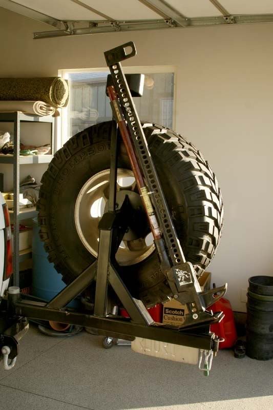

    Also do you have any more pictures of how you have this rear light set up? I always like that you had these utility movable lights on the back of your rigs. If i could get some more info on this that would be great. Thanks.

    It's nothing fancy. Just a simple "work" lamp that helps out at campsites at night. There is just a tall "post" welded to the top of the tire carrier. Right now there's just a switch on the dash, but I'll be changing it up to use a switch by the light instead. It's easier to turn it on back there since I'm usually outside the truck already when I need to use it.

    Here's a pick of the backside of the tire carrier (when it was on the old truck) that shows the post for the camp light.

    Thanks for the Picture. i thought it was portable for some reason.

    It will rotate so I can point it where I need it but it's not portable.

    cool thanks. I may do that this week. Is it just an inexpensive light? I have some spare KC rounds

    Yeah you could do some fancy LEDs or something but I just used something I had on hand. Cheap will work just fine for what I need since it's mainly just used to light up the trailer when I pull into camp at night.
