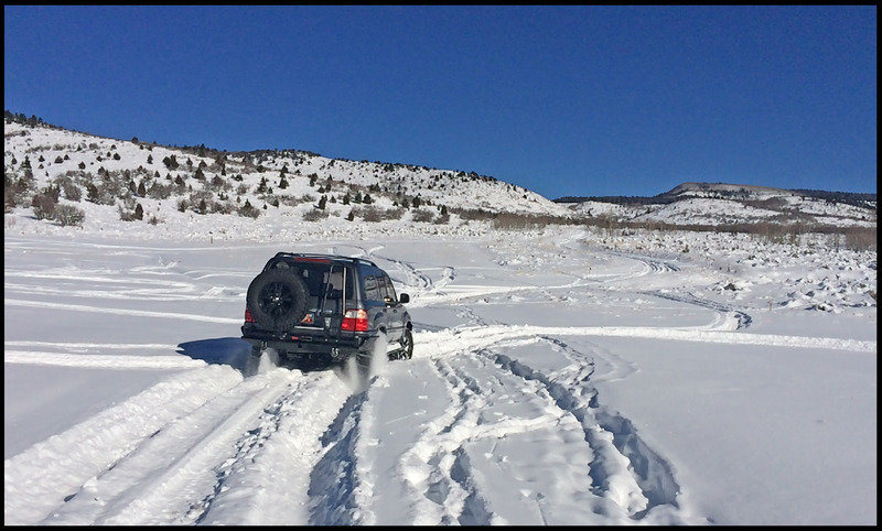

    On a lighter note I did get out for some fun in the snow on New Years Day near the family cabin. MTR's did great in the snow which was nice since my snow chains are a little short to fit the 35's.
    My BIL's LX470 did great in the snow too. He is unlocked but had chains in the rear and was unstoppable.

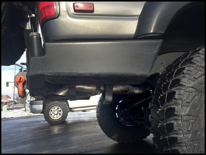

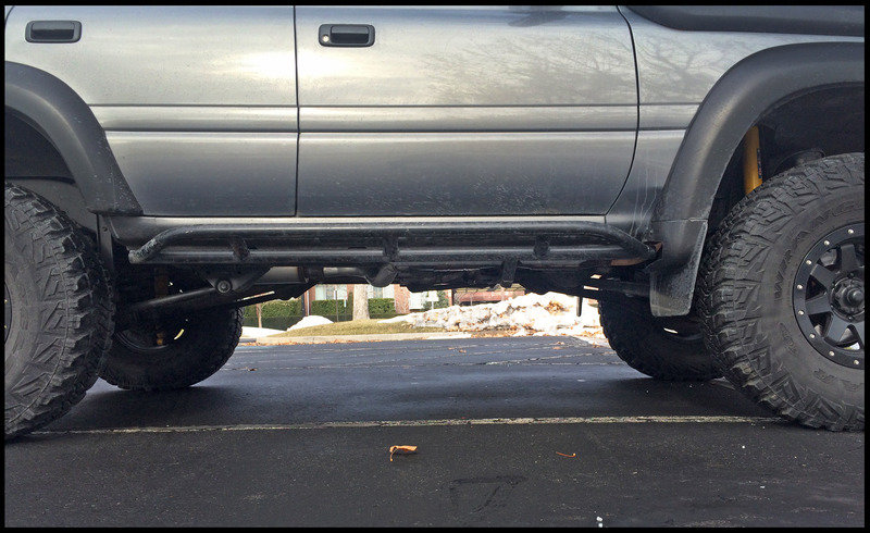

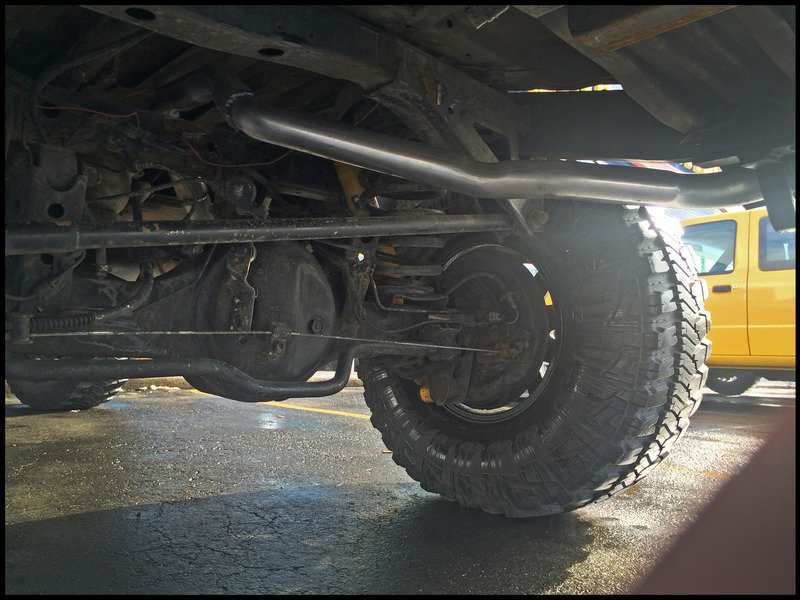

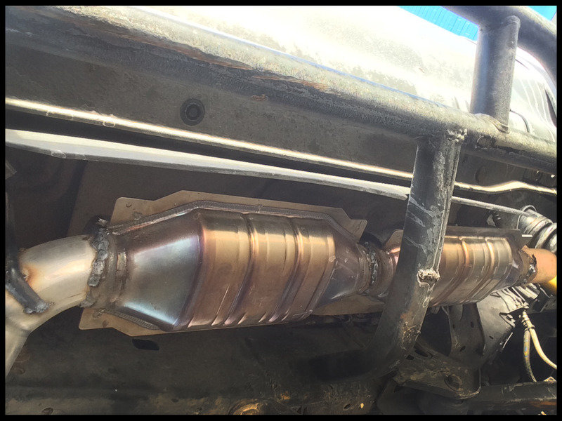

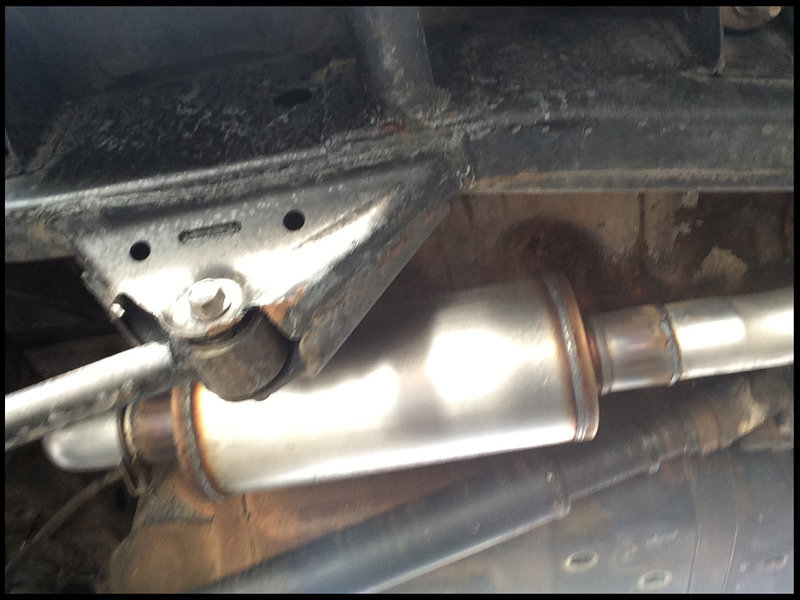

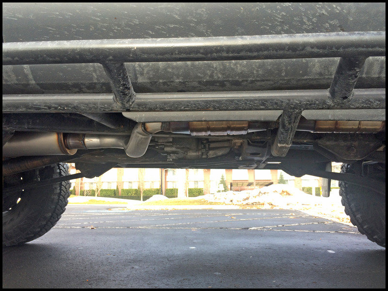

    I replaced my exhaust yesterday. I had a leak at the Y-pipe and at the flanges for the cats. There were several broken hangers and both stock cats were bad and clogged up so it gave me plenty of reason to just redo the whole thing. I ended up using dual Magnaflow high-flow cats in the stock location but rotated and tucked up above the frame for better clearance. Also used a Magnaflow muffler and ditched the resonator at the tailpipe. All tubing is 2.5".
    As for the routing it's more or less the same as stock but tucked up as best we could. This means it still passes under the frame behind the cats which isn't ideal but not something I'm worried about.
    As for sound, it's louder than stock but not overly obnoxious. Definitely a more "throaty" tone through the entire range. It's very quiet at idle and while it's clearly audible at cruising speeds inside the truck it doesn't drone. Throttle response seems to be slightly better with my "seat-o-the-pants" analysis. Haven't had a chance to see if there is any mpg change yet.
    Overall, pleased with the result and definitely a improvement of clearance at the cats which was my main complaint with the stock system.
    Sorry for the crappy phone photos. Yes, I know I have a rear axle seal that's bad (fixing it tonight). Also you'll hear my starter clicking at the beginning of the video. It's also getting replaced (since I know someone will bring it up).
    Magnaflow cats
    Blurrly Magnaflow muffler
    Much better clearance at the cats

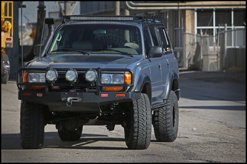

    Adam any pics of the light bar on the Prinsu?
  12. Mar 7, 2016 at 10:26 AM
    #412
    Box Rocket
    Box Rocket [OP] Well-Known Member
    Mar 1, 2010
    #32389
    7,184
    Adam
    Syracuse, Utah
    1995 FZJ80 Land Cruiser
    3xLocked, lifted, well used

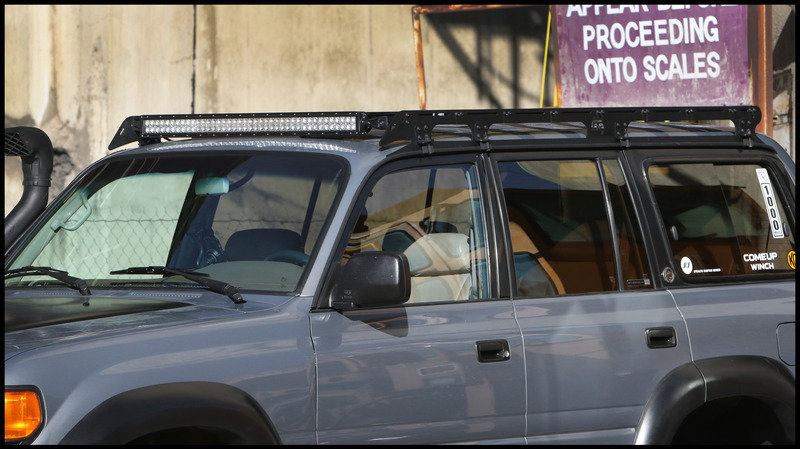

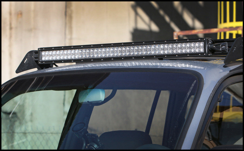

    Yeah. This may not be the most elegant solution since the way I did it completely eliminates the wind deflector but it's worked fine and I've only noticed a very small increase in wind noise. The reason I did it this way was because I wanted the lightbar to not be any higher than the rack. If you don't care about that, you could mount it a bit differently and possibly keep the wind deflector (would probably need to be notched for the lightbar). So I removed the forward-most crossbar that the deflector is attached to. The next crossbar is usually mounted on an angle or horizontal like the rest of the crossbars. I turned this vertical and used two of the flat t-slot "nuts" from the wind deflector to attach the lightbar to this crossbar.
    Since my rack is 1" shorter than the production ones it put the lightbar very close to the roof in this configuration. I put a strip of foam weather stripping on the bottom of the lightbar and it just barely touches the roof. It's been really solid and no noise against the roof.
    Hope that helps.
