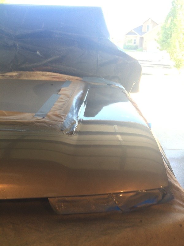

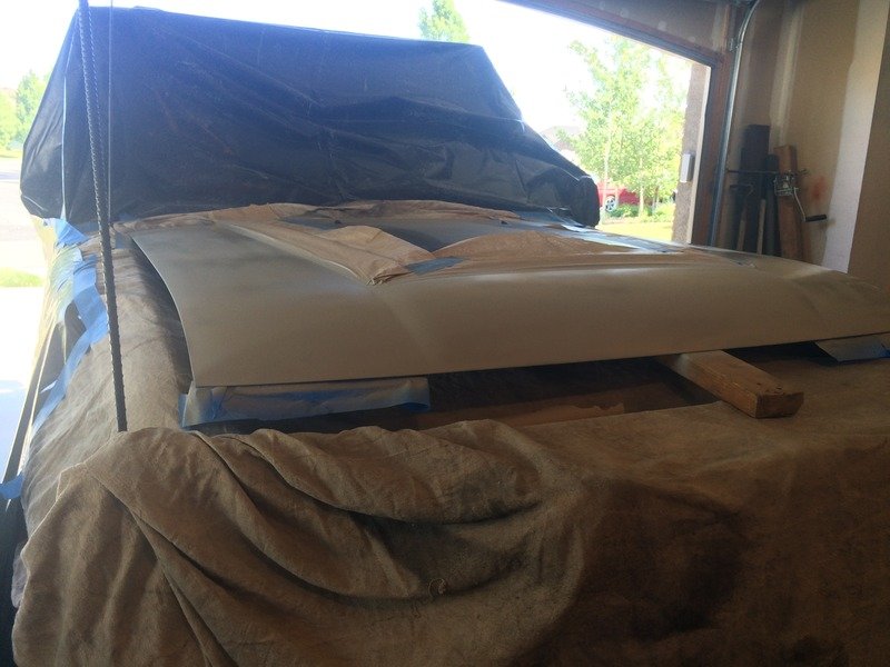

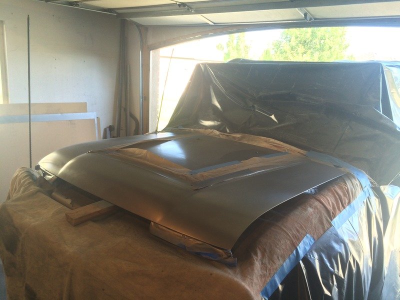

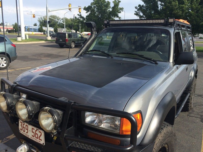

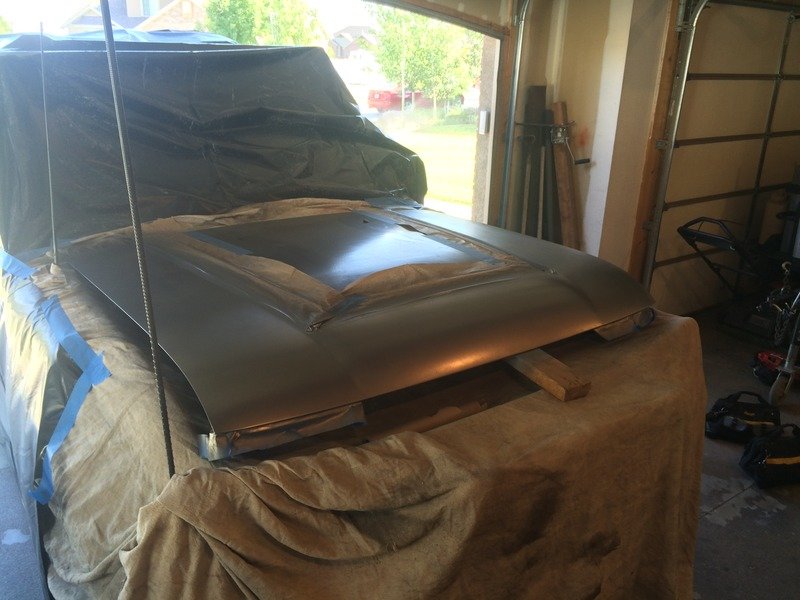

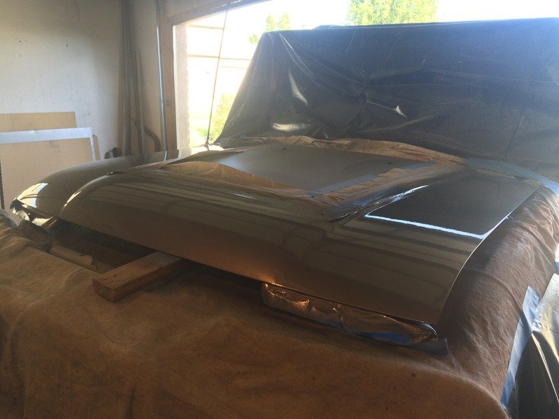

    I worked on a bit of body work yesterday. The hood on the cruiser was in rough shape. The clearcoat was pitted and flaking all over it. This was one of the reasons I blacked out the center section, to cover the worst of the peeling. But the sides of the hood were also bad so I sanded them down and repainted them. I had some 1A6 color mixed up and put into rattle cans. I did a primer, base coat and clearcoat. Turned out pretty good for being rattle canned, and the color match was quite good.

    Are you doing any sanding or buffing between coats? It amazing how this looks in the pictures. Does it look the same in person?

    No wet sanding or buffing. Just sanded the surface prior to painting, then sprayed 1 coat of primer, wiped it with a tack cloth, sprayed the base coat, wiped again with tack cloth and then sprayed the clear. That's it.
    it's most definitely NOT show quality but it turned out really nice especially for rattlecan.

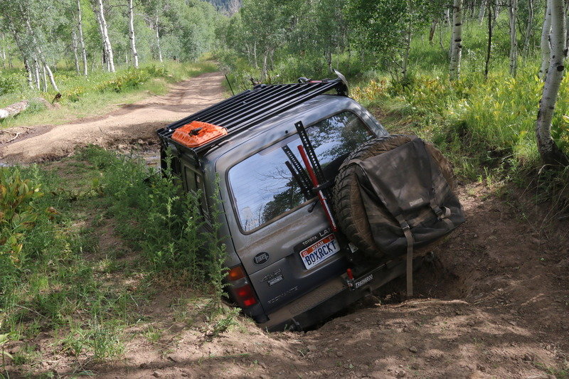

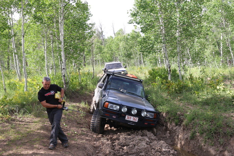

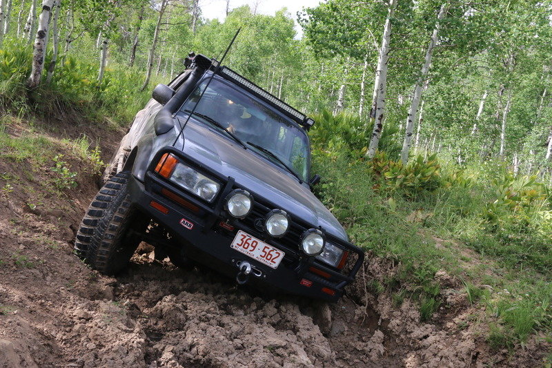

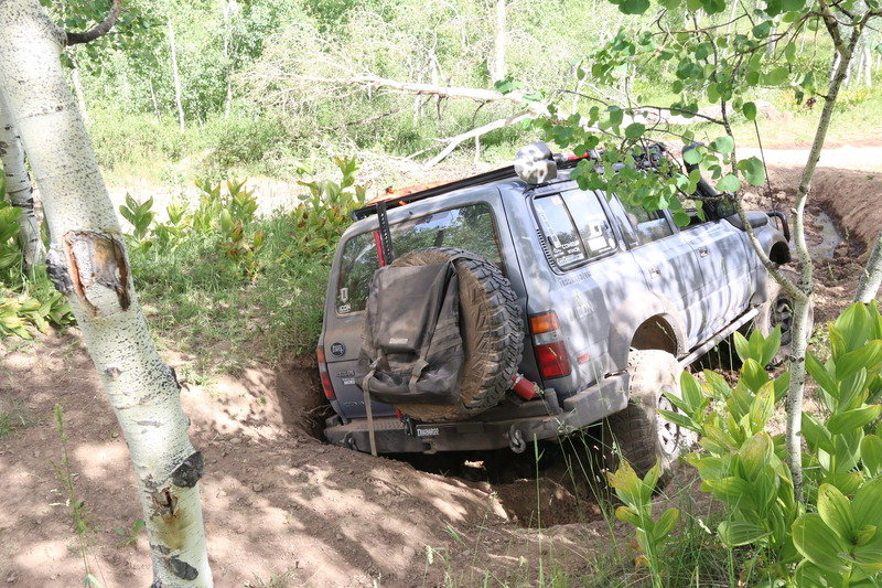

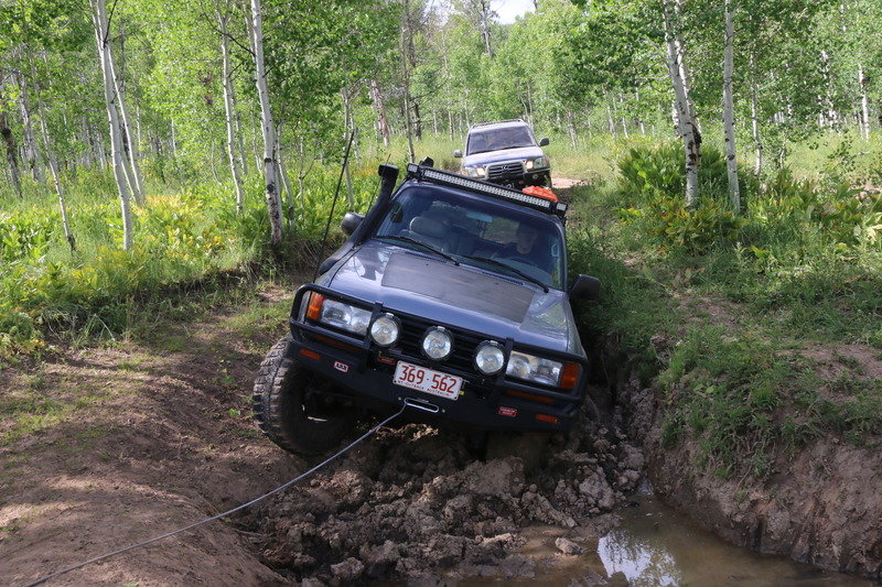

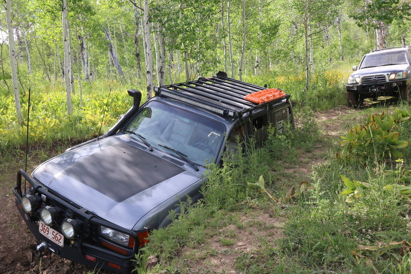

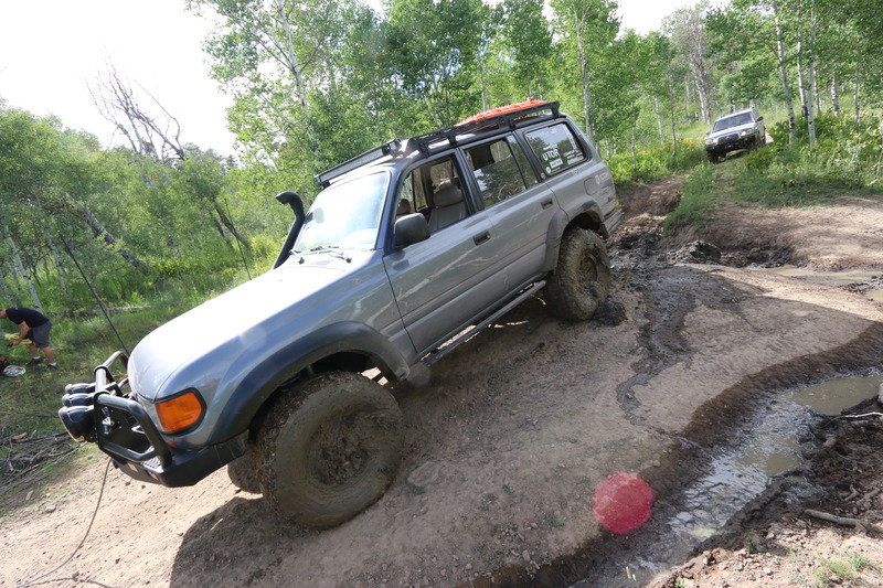

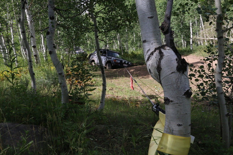

    near the end of the route I dropped the 80 into a hole that turned out to be deeper and softer than it appeared and swallowed the driverside. The drop in was a vertical ledge about 3' high and the rear bumper was hung up. Between the rear bumper being hung up (keeping the rear tire from touching the ground) and the slippery clay in the hole, I wasn't able to drive out immediately. So a used the COMEUP winch to pull the truck about 12" to free the rear bumper and then was able to drive out on my own. Fun little challenge.

    you just love mud adam
