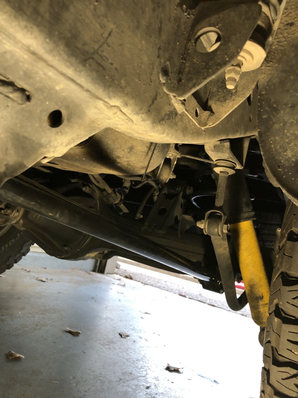

    Just went DeltaVS and OME adjustable panhard on mine. I had pro help getting it all installed. Haven’t tested it out yet.

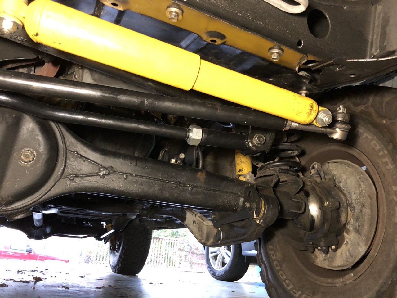

    I’m going all in on this OME set up. New UTA, LTA on the rear and new Panhard on the front with a Marlin Crawler steering upgrade kit. All nice and tight. No more clunks.

    Cool. When those caster bushings come apart, replace them with OEM rubber bushings and caster plates, you'll be glad. The OEM bushings will last longer and flex better.
    Which rear control arms are you using? Steering stuff and panhards looks good

    It’s all OME. Here’s the UTA. https://www.metaltech4x4.com/ome-80-100-series-land-cruiser-adjustable-upper-trailing-arms/
    I’m still learning about all the suspension stuff on the 80. It’s different than anything else I’ve owned.

    Cool. The Metal Tech arms are good. Sorry, you maybe confused OEM and OME. I was talking about the Factory Toyota rubber bushings. The Old Man Emu will work fine for a while but for rigs that get flexed a lot the Poly bushings don't flex as well and will tear apart quicker. When they start to come apart you'll get some wandering on the road since they are also what is handling the caster correction. Probably feels pretty good now since they're new. You've got some time before you'll have to worry about it but its just something to consider when the time comes.
