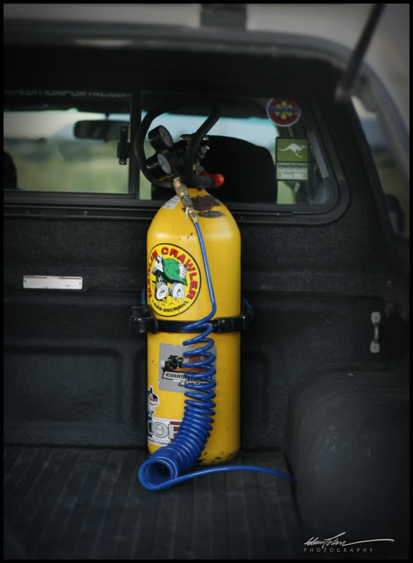

    Not if you do like Adams in this truck. How I'm doing mine.

    If you're talking about like this?
    I can't mount it there because of my toolbox.

    Right. But can go like that anywhere else in the bed..

    I thought you wanted to use the large quick fists.

    Yeah, and mount that the same way Boxrocket has his tank mounted except in the back corner near the tailgate.

    Yea that I know won't work. The quick fists will sit to far back. The bracket that Adam and I have mounts flush with the bed rail.
    Make sense??

    Large quick fist do not fit a 20lb tank. FYI I know because i bought one. Ended up buying a mounting bracket from a oxygen shop.

    It's not that bad. How often do you expect that you're going to be using it? It's usually just once at the end of the trail ride to air back up. You'll spend WAY more time standing there waiting for the tires to fill than it takes to unclip the bracket and stand the tank up.
    Not sure what you mean, the rack is just bolted to the bed so it is removeable.
    ^This. I have two of the large quickfists and they fit up to 4.5" diameter and most tanks are 6.5" diameter or a bit more. The large quickfists will work great for a fire extinguisher though. There is also a "Super" quickfist that is even bigger and it should actually work but I haven't used one.
    PcBuilder, if you plan to mount your tank (especially a 20lb) with a quickfist, I would highly recommend some why to anchor the bottom of the tank. If you only use a single quickfist mounted to the bedrail, the mount becomes a pivot point and the bottom of the tank could easily slide out while on the trail and let the tank flop around. So somehow you'll want to secure the bottom part of the tank, either with a second quickfist, or a ring bolted to the bed floor to keep the tank from moving around.

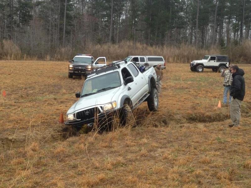

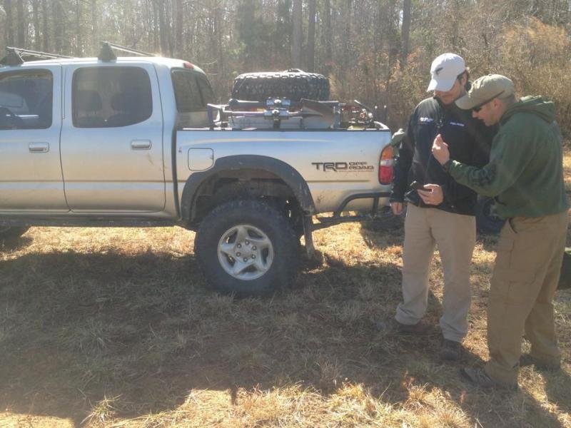

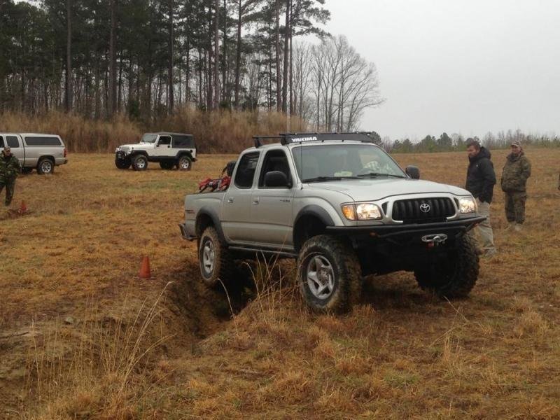

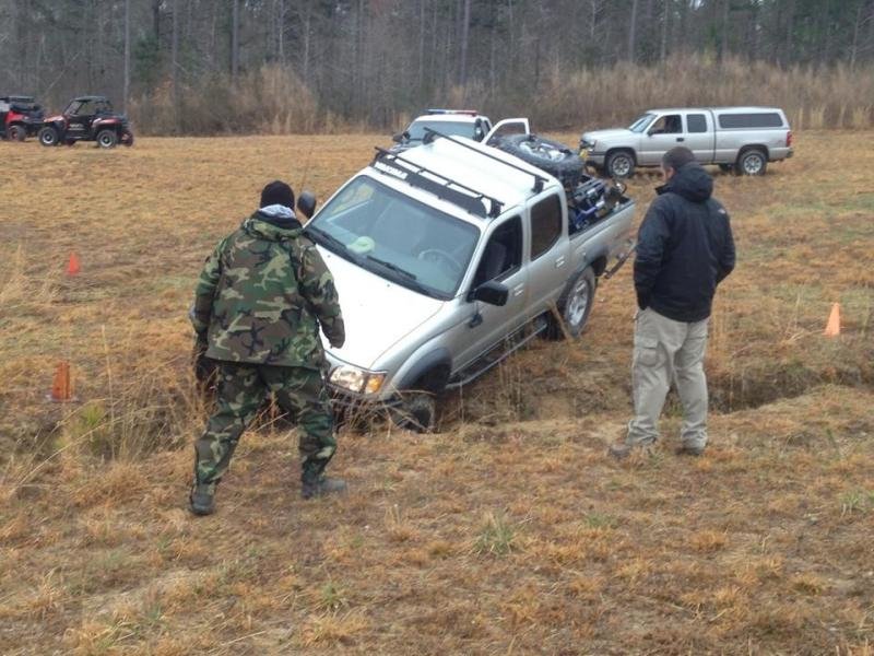

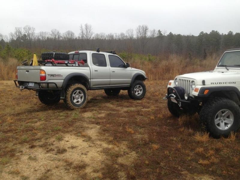

    Few more pics of a customers rack in use. This guy uses his Tacoma and Jeep to train Narcotics Enforcement officers how to drive offroad. The rack has become a nice addition to his "tool chest" for training.

    now thats pretty dam cool!

    That sounds like an awesome job!
