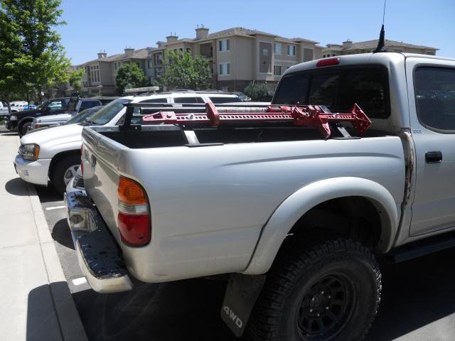

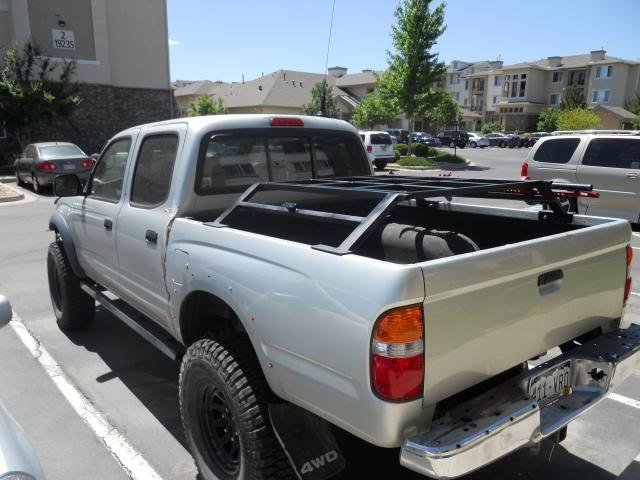

    So I've tweaked the design slightly. Not doing 3 legs anymore. It makes for a much heavier rack to have the 3rd leg and full length feet. So I've gone back to 2 feet/legs and added another spreader on each side the connects the legs and provides a mounting location for the shovel bracket and for the hilift.
    I built this one for the Raffle in Moab with this new design and I think this is a better setup. Thanks to Poorboyota for the pics (he's the one that won this one at the raffle).
    Shovel bracket side (bracket is not installed but you can see the change in design.)
    Other side is identical with mounts for the hilift.

    I like it better too actually. Nice.
