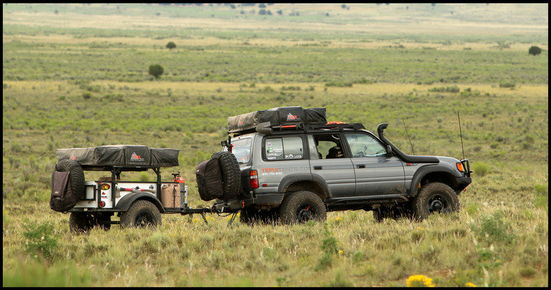

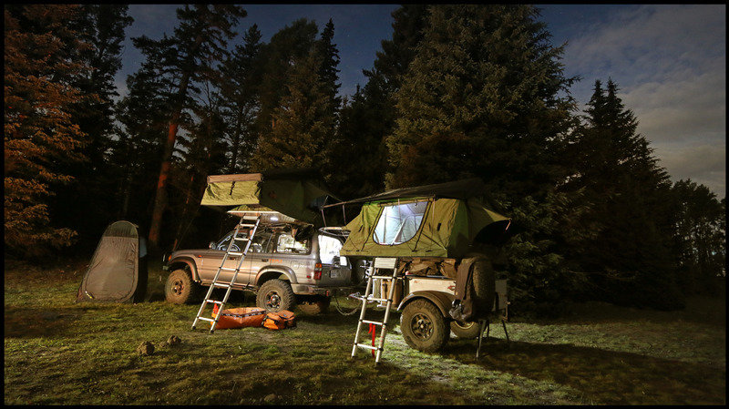

    A few pics from our last outing.
    HoustonMS3 and ian408 like this.
