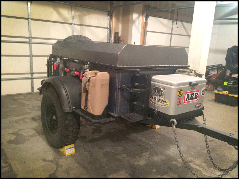

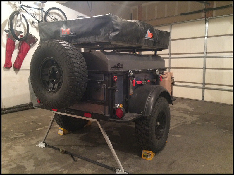

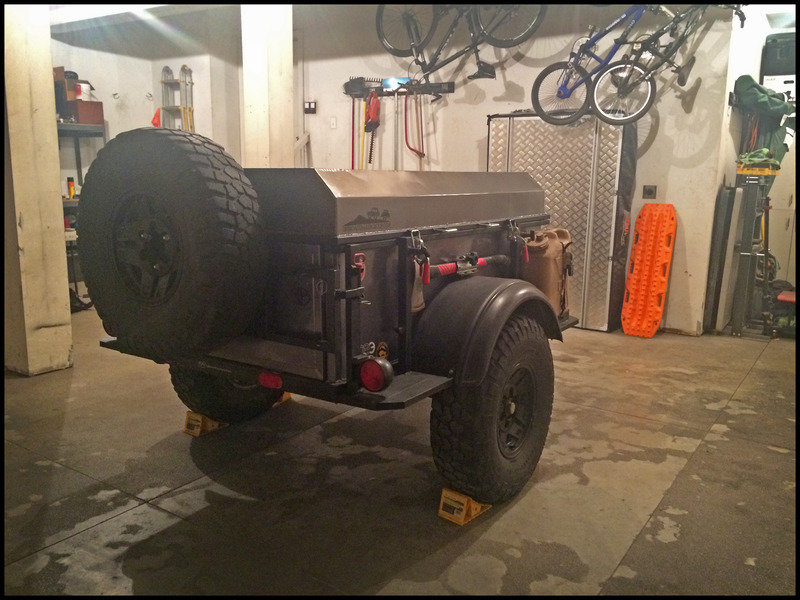

    Couple of grainy iphone photos of the completed lid. I'll be building the tent rack tonight. I am still waiting on gas struts and the weather stripping, but it's getting close.

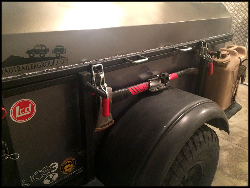

    Great work as usual Adam looks good, they really did miss it by just a hair on that paint :eek:. On a side note, what type/brand of brackets to you have for mounting you shovel an axe?

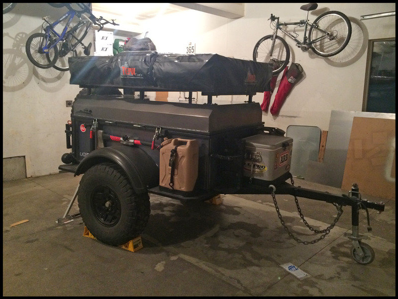

    finished up the tent rack and got the tent back on the trailer in time for the weekend.

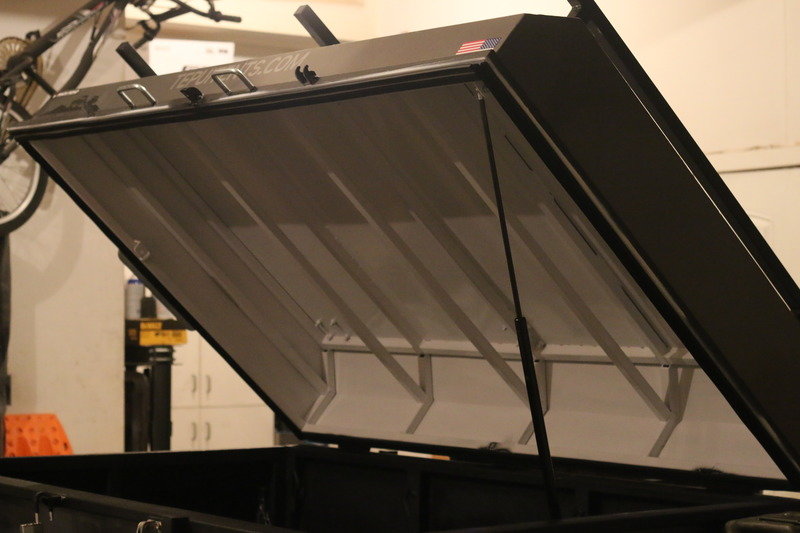

    Anywho, I was wondering if that new lid you rigged up opens easily with the RTT on top. I'm sure it does, but I think I speak for everyone here when I say I'd love to see some action shots of that lid opening and closing with the RTT.

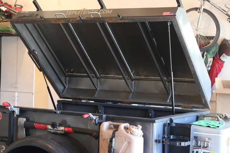

    Yes the lid opens fine with a tent mounted. I don't have "action" pics at the moment but this is what I have. There are two 250lb gas struts for the lid. I only use one of them if the tent isn't mounted and add the second one when using the tent and it opens the lid easily.

    Here's a completed shot after the inside of the lid was painted white and the seals were added.
