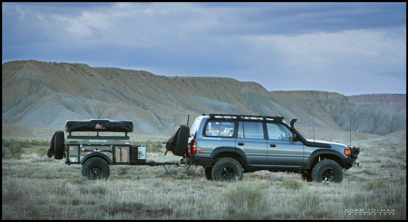

    That's a nice picture you should frame it and hang it up in your garage if you haven't already.

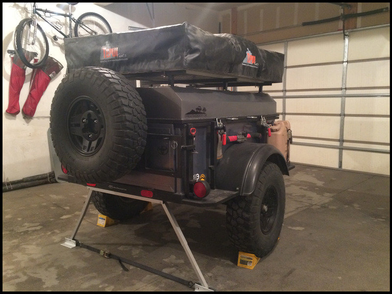

    Do you have stabilizers in the back when you camped?

    yes,

    Is this welded/ bolted on. I'm at a point of how I want to set mine up. Stabilizers can get pretty big, and in the way. I'm currently sitting about 24.5-25" from ground to bottom of my trailer.

    No it’s a very simple contraption I got at Camping World for like $20. This is what it’s designed for. It folds up and fits in a bag about 18” Long. I just keep it in the trailer. Nothing permanent to hang down and get caught/bent on rocks etc on the trail. When the trailer is hoped to the truck or when the tongue jack is down and the stabilizer is in place it’s really solid.
