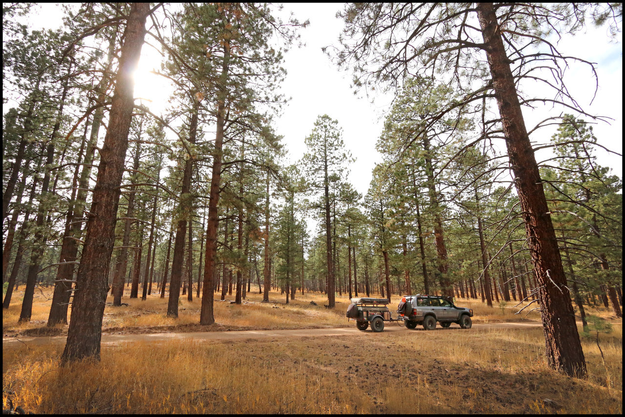

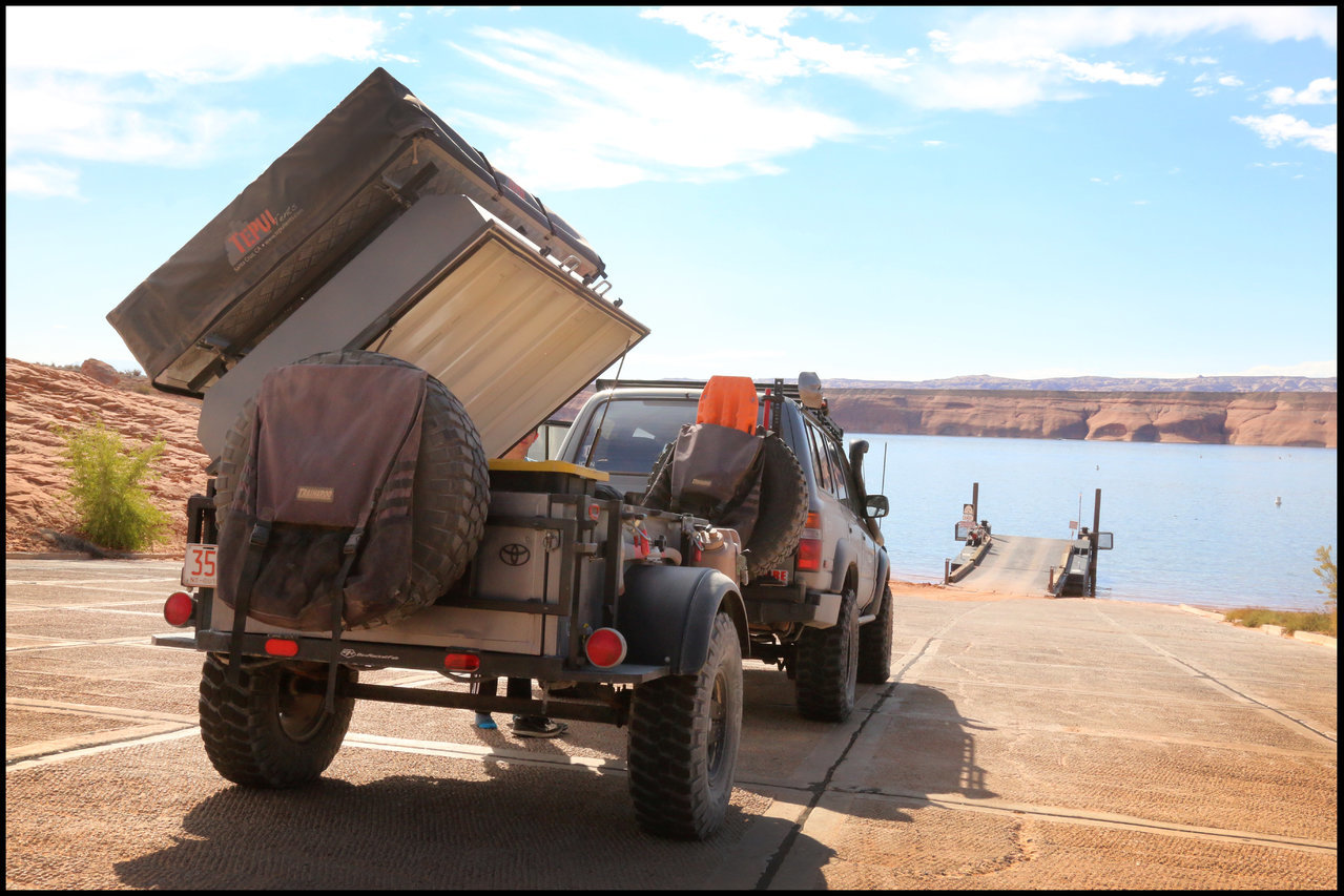

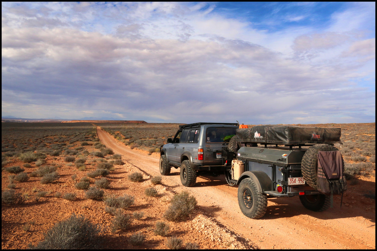

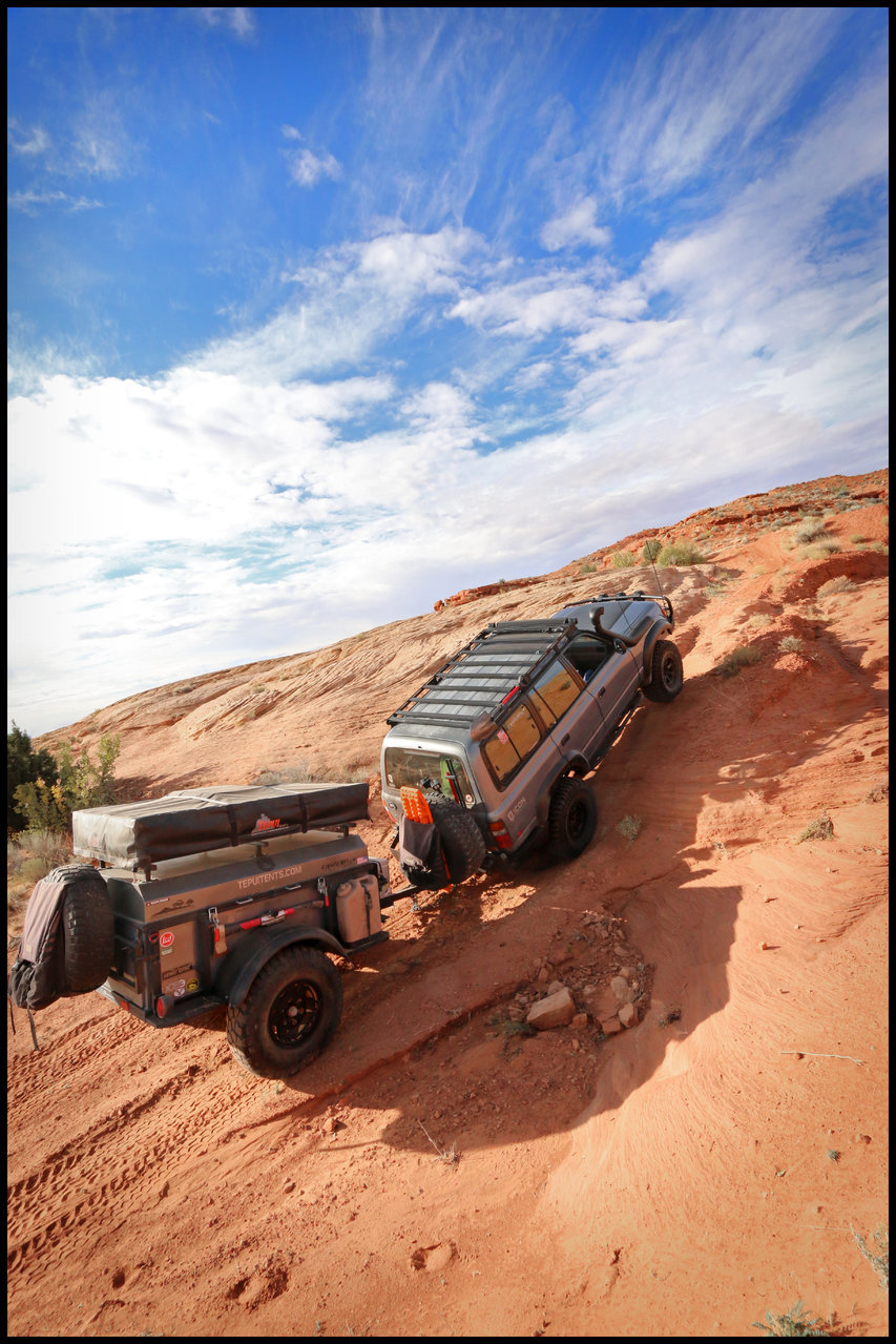

    A few recent pics from the last couple trips.

    Adam, what length stroke are your pistons for the lid? also, where did you get the latches?
  3. Mar 21, 2018 at 6:46 PM
    #243
    Box Rocket
    Box Rocket [OP] Well-Known Member
    Mar 1, 2010
    #32389
    7,184
    Adam
    Syracuse, Utah
    1995 FZJ80 Land Cruiser
    3xLocked, lifted, well used
    Pretty sure they are 24" stroke. The latches are Destaco latches from McMaster-Carr

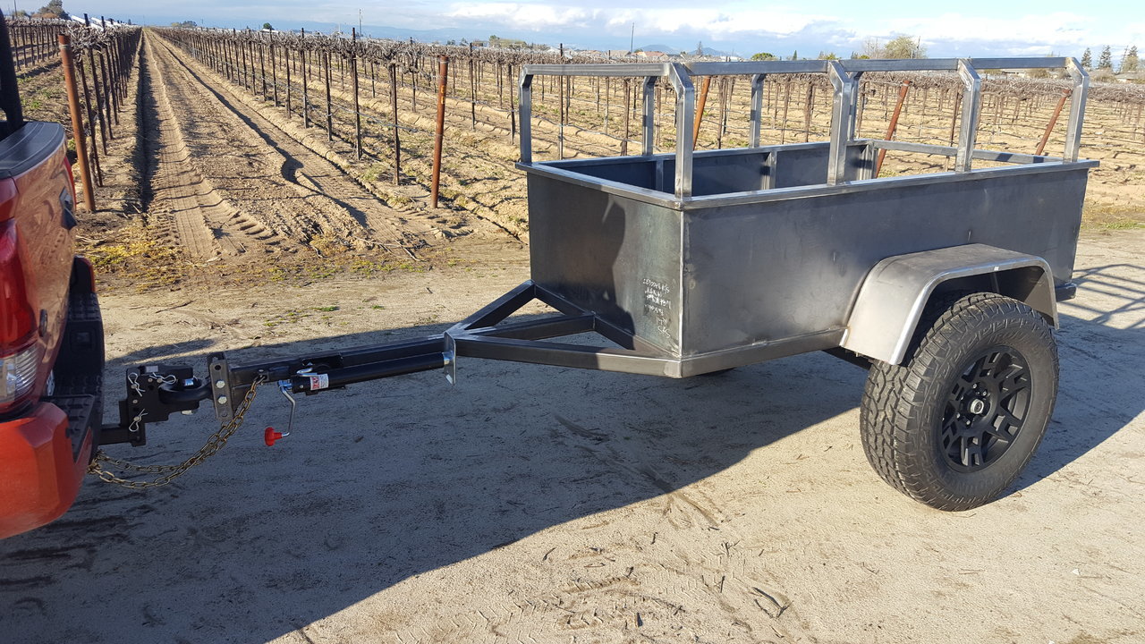

    My build is still in the finishing stages, but mine will have the pintle.20180315_173212.jpg

    Not sure what you mean by "plated the trailer", but I assume you might be referring to the lid? I had always planned on a lid at some point. Also the telescoping rack was used initially because I had a Tepui Autana with an annex and wanted to have the full use of the annex. I haven't had a tent with an annex on the trailer for the last year or so which meant I didn't need the telescoping rack. Since the rack needed to come off to build the lid it was a good time to change the rack style to a fixed one on the lid.
    I've used a pintle. They are simple and they work. I would highly recommend a rotating pintle if the one on your trailer is not one. The last thing you want is for the trailer to get off camber and and max out the rotation of a fixed pintle and pull the truck over. Pintle's can be pretty noisy and personally I don't like the semi-loose connection. It's not really a risk of the connection coming apart but it's just movement in the hitch that I don't like. I definitely prefer a more solid connection from a multi-axis coupler like a Max Coupler or LocknRoll. I've had both of those two and the Max Coupler has been my favorite. But there is nothing "wrong" with the pintle on your trailer and it will do the job.
