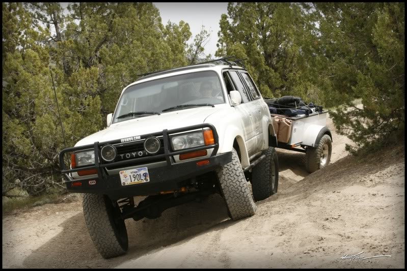

    When I built the trailer I didn't have my Tacoma yet so it was designed around towing it with my 80 series Land Cruiser. There's some wiggle room on the ideal track width, but generally its nice to have a track width slightly wider than that of the tow rig. On the flip side if you can keep the track width close to the same then the trailer will be better at following in the same tracks as the tow rig which can be extremely helpful on tight or technical trails.
    So I decided on 64" WMS to WMS. That is .5" wider than the 63.5" track width of my Land Cruiser. It works great with the Cruiser and even though it's a little wider than the Tacoma is has been pretty successful there too.
    I don't know the track width of your truck (2010 right?) but I would guess it's pretty close to that.

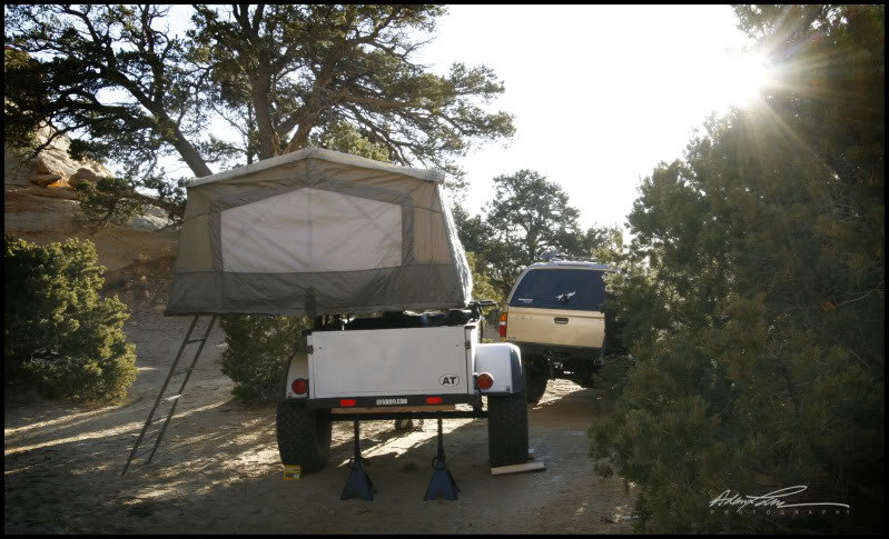

    beautiful build. what kind of tent do you use?
  15. Jan 11, 2012 at 3:22 PM
    #35
    Box Rocket
    Box Rocket [OP] Well-Known Member
    Mar 1, 2010
    #32389
    7,184
    Adam
    Syracuse, Utah
    1995 FZJ80 Land Cruiser
    3xLocked, lifted, well used
    The one in the pictures is a first gen Mombasa. It's an entry level tent but has worked well when I've used it. I'm trying to save for an Eezi-Awn or Maggiolina.

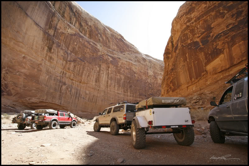

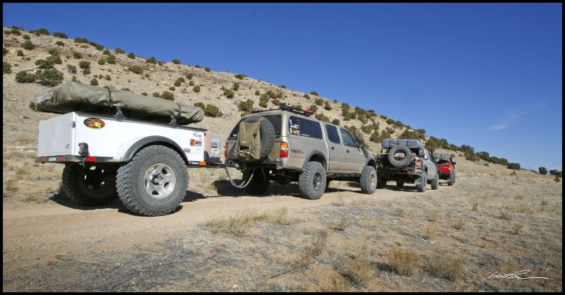

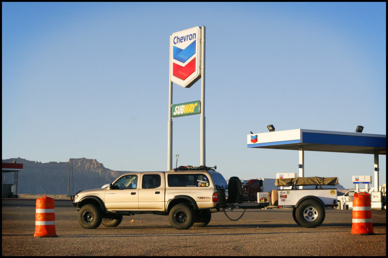

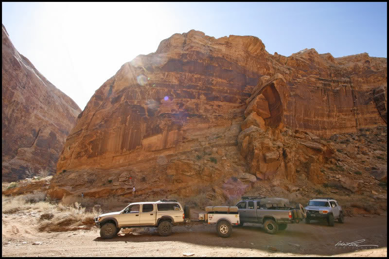

    Took the trailer out for some fun in central Utah last week. Good times.
