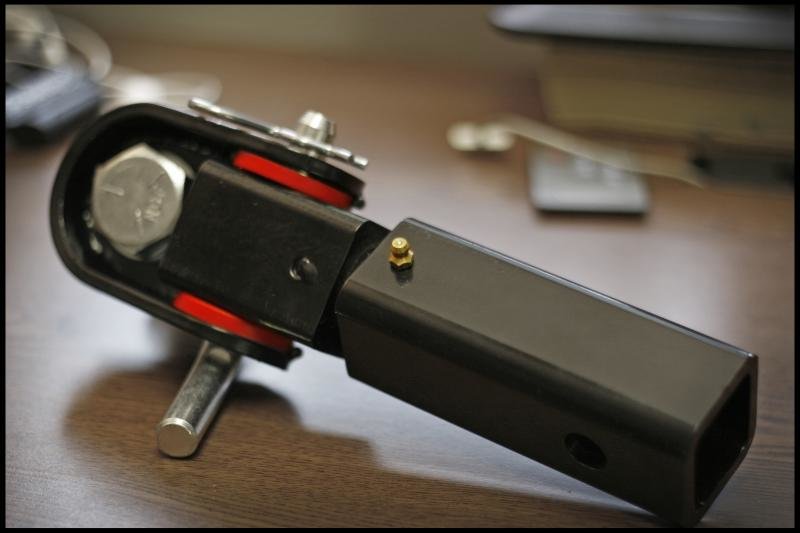

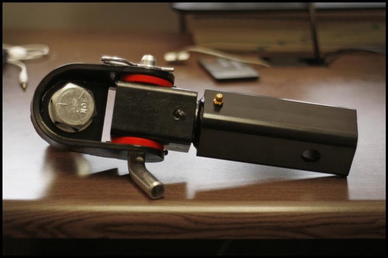

    On my last trip I managed to bend my Lock-n-Roll hitch so I ordered a replacement today and I'm going a different route this time just so I can compare the two. Got this new Max-Coupler today. Really looking forward to trying it out.

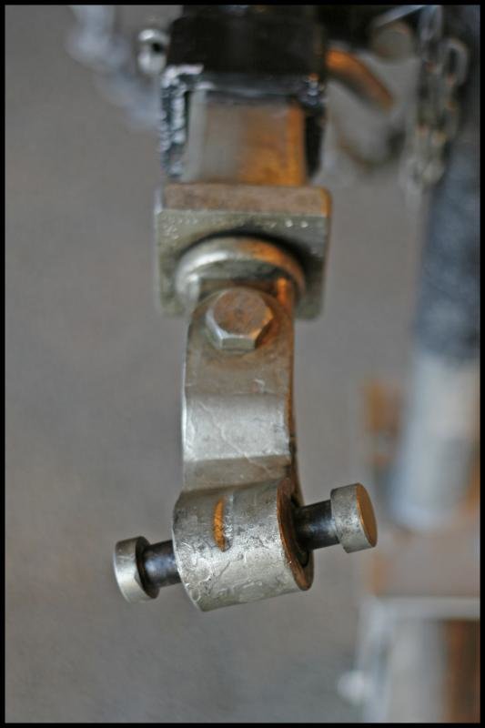

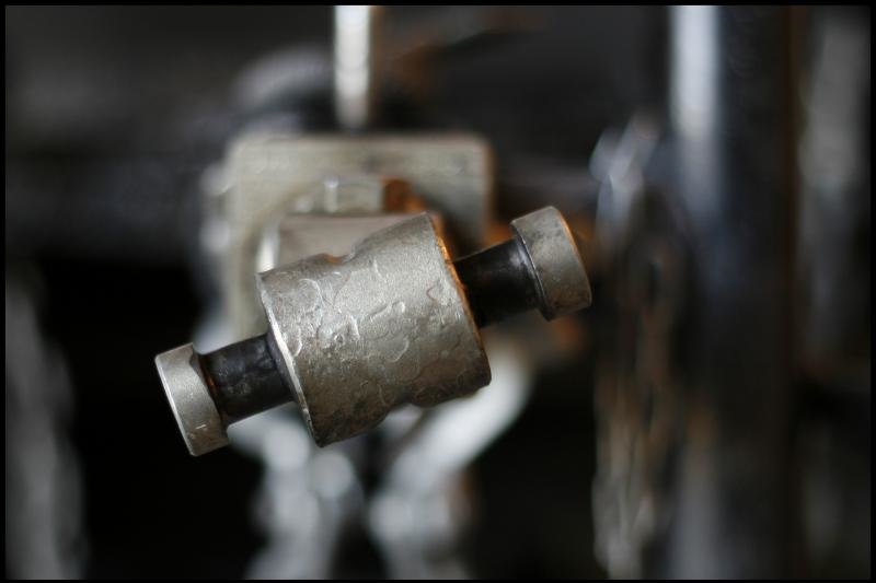

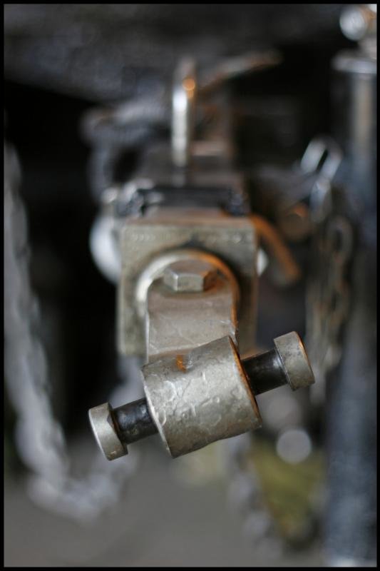

  15. Sep 16, 2014 at 6:16 PM
    #155
    Box Rocket
    Box Rocket [OP] Well-Known Member
    Mar 1, 2010
    #32389
    7,184
    Adam
    Syracuse, Utah
    1995 FZJ80 Land Cruiser
    3xLocked, lifted, well used
    Here's the pics of my bent Lock-n-Roll. It isn't *too* bad and I was still able to tow just fine with it but the side to side rotation is definitely binding slightly when towing with this bend.

    Wow that's definitely tweaked lol

    Yeah there's only certain situations where it can happen. Basically, if you are backing up and sharply turning the trailer, the coupler will want to rotate upward at the connection point with the truck. When/if that happens it makes it so the side to side rotation joint is bound up. If you continue to back up, something has to move and since that rotation is bound up it twists that section of the coupler.
    It's a rare occurrence and kinda takes a perfect storm of steps to make it happen but it can happen. Lock-n-Roll has beefed up that section of the coupler on newer ones so that it will resist the twisting if the coupler does bind like that so I have not heard of too many cases of it happening in the last couple years.
