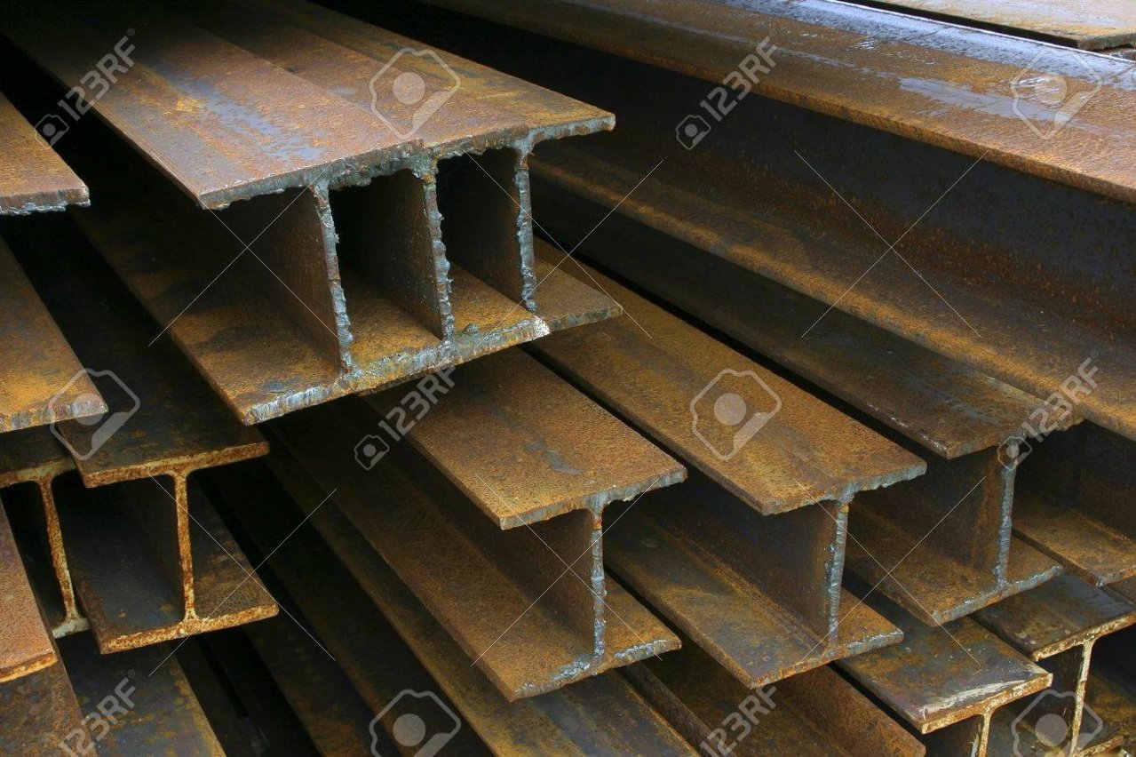

    Start messing with the frame and you end up with this

    Wow.....best Redneck Limo I’ve seen.

    Yeah, looks like he used a steel frame from the building supply.

    Boxed or C Channel?
    :stirthepot:
    mac_2_nite likes this.
  18. Feb 3, 2019 at 8:24 AM
    #38
    Grossomotto
    Grossomotto Complete 3rd Member
    Mar 13, 2018
    #247175
    8,446
    39.9526° N, 75.1652° W
    2017 4WDV6LB6MT
    Maybe “I” channel?
