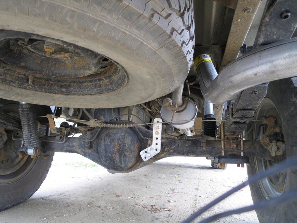

    Anyone install this bpv bracket on there truck ?
    Does it actually help ?
    :confused:

    It brings the brake proportioning valve to a point where it can function like it should...when you lift the rear but leave that in the stock location, it doesn't function as well as it should and can have a negative effect on your rear braking ability. Nothing major but doing this mod helps a bit.

    Someone can probably explain it better than me but that's the gist of it....I ordered mine from Wheelers but it didn't fit my 04 very well, make sure the one you buy is for the right year/model of your 1st gen. I think some BPV's are mounted slightly different than others.
    BAMF should have one too, I've seen that one on here a bunch of times.

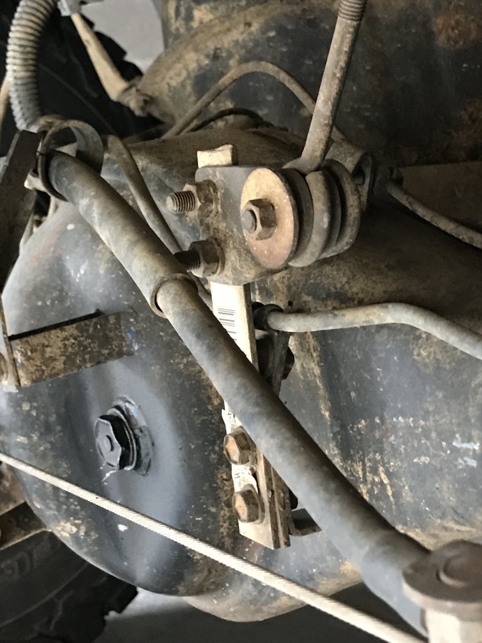

    you could just make one... all you need is a piece of the flat square aluminum and drill a couple of holes and get another bolt/nut/washer.

    I'll take a pic of my setup when I get home

    If you have a drill and a hacksaw, you can made your own for like $5.

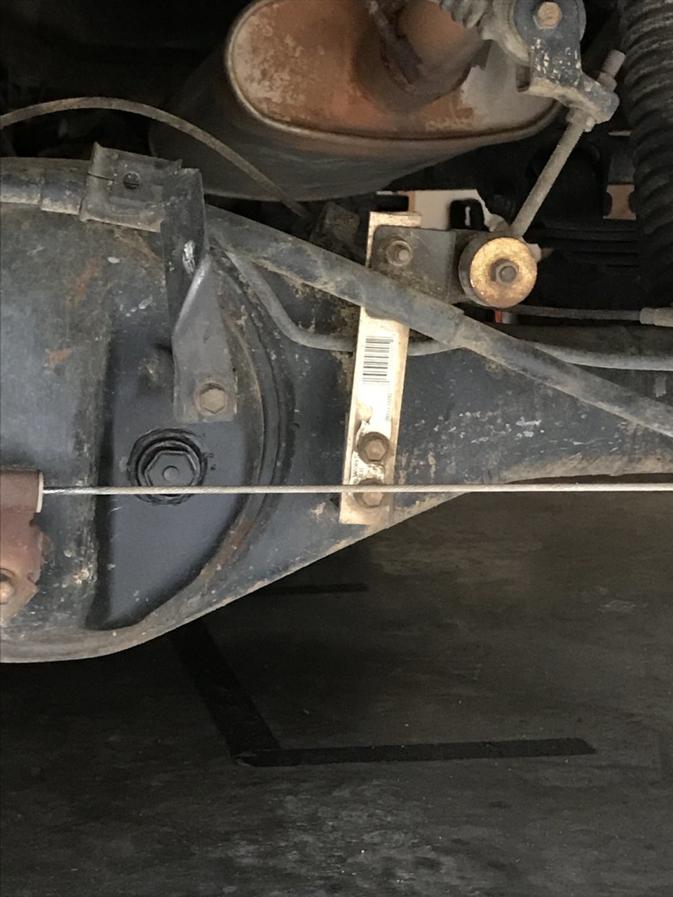

    I said I was gonna paint mine years ago but... still haven't gotten around to it. I was able to make mine to the exact amount of lift I got.

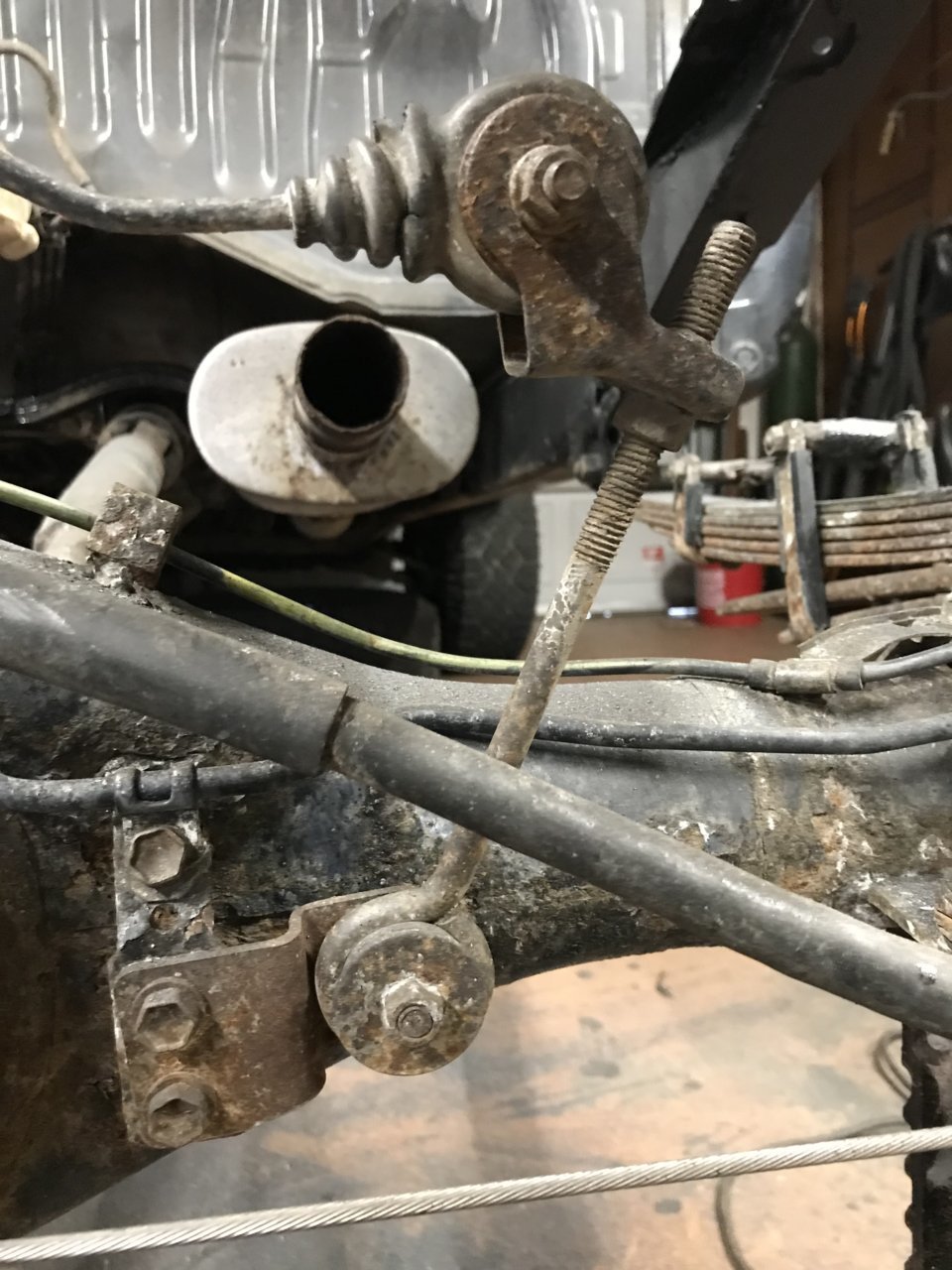

    Is this trying to re-align the BPV with something?
    I'm trying to understand how much to raise it.
    Thx

    the higher the arm, the more braking force is allowed to the rear wheels. it's supposed to "sense" when there is a load so that more braking can come from the rear.
    so when you lift the truck, the arm actually goes lower, making it seem like there is no load at all in the bed or on the rear and will never correctly proportion the braking at the rear wheels.
    I honestly noticed only a slight improvement when I put the bracket on. the Tacoma in general doesn't have a lot coming from the rear brakes. hence why you see a lot still have original pads on the rear (I'm at 175k and still plenty of pad life left)
