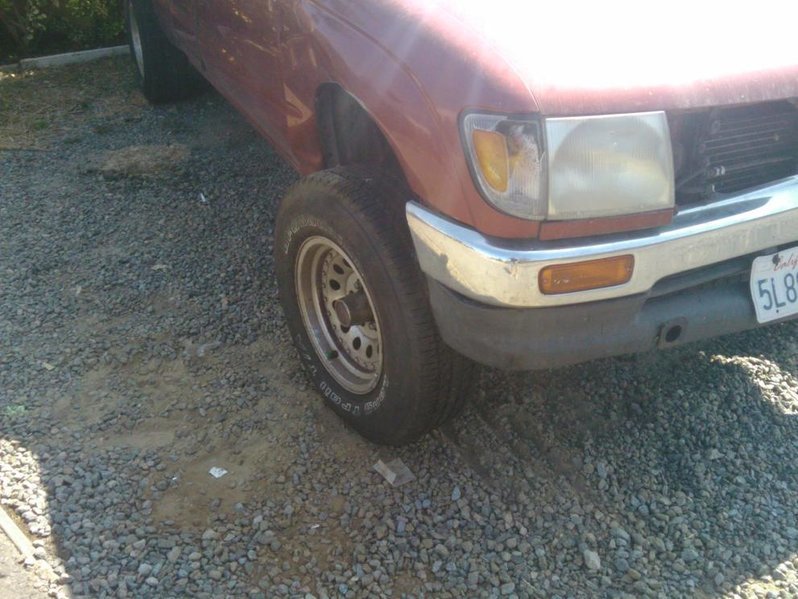

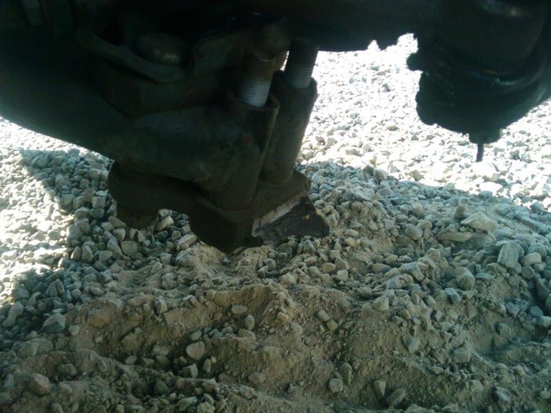

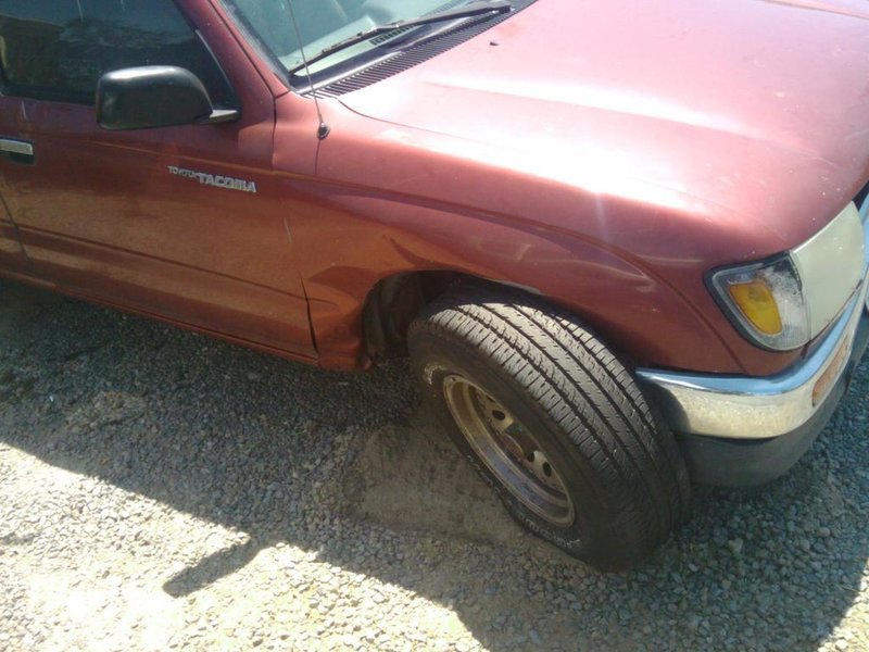

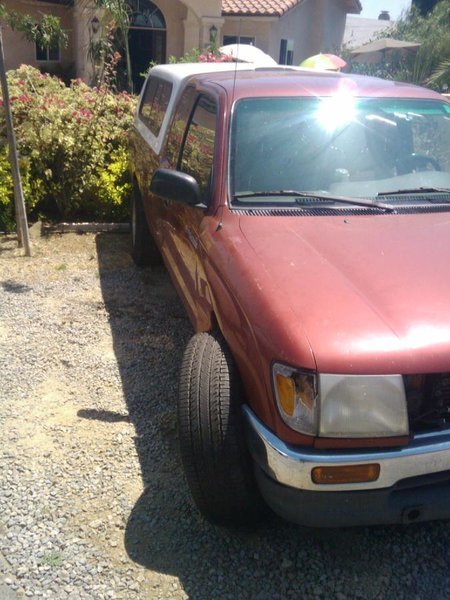

    here are some pics of my truck before and after i fixed it and the bracket that keeps on breaking

    I can't really see the break. Would you take a pic from the ground looking up at an angle toward the break. The bright parts of the pic were making the dark parts hard to see.
    Bottoming of the suspension is when the tire is forced as high as it will go into its stop. After it reached this point, the spring and shock are no longer absorbing anything. It is the frame and suspension that absorb/break.

    It is a 5 lug thing. I broke a lot of these things (including at high speed) before I just went long travel to eliminate the issue.
    Bottom line is that this bracket is not meant to carry the load of the bigger tires and the lift. Especially if your suspension is really stiff or shocks are shot.
    I sold my spare brackets to a guy on here that was going to try and have some machined instead of the cast ones you get from Toyota.
    Overall you will probably get a better response on the 5 lug forum since this is an issue that only 5 lug trucks have.
