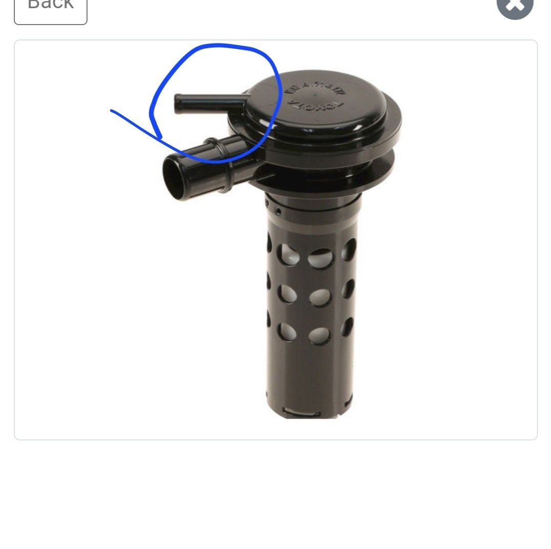

    Now that I've had the truck for a few days and driving it I hooked my code reader up and I have 3 pending codes P0440, P0441, and P0446 so all evap codes. Could those have something to do with it having the slow, weak, or hard starts? I have replaced the vapor canister purge valve under the hood because it was easy to get to so im assuming the charcoal canister itself is probably shot. If it was summer and I didn't have 5 feet of snow sitting in my yard id just pull the bed and mess with it haha.
  17. Mar 18, 2023 at 12:42 PM
    #37
    bowhunter13
    bowhunter13 [OP] Well-Known Member
    Jan 19, 2019
    #279828
    201
    2002 silver Tacoma
    2002- Toytec Lift/Suspension, Total Chaos UCA
    I was looking at my charcoal canister as good as I could and noticed a small hose wasn't attached to the tank vent valve. What is this and does it really matter?
    cruxofthebisquit likes this.
