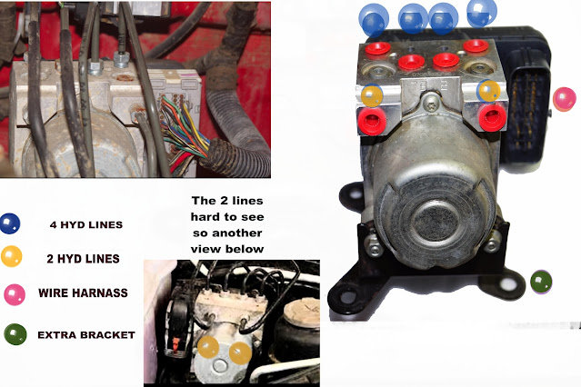

    Rght is what they sent me, guessing the brackets would be removed because they exist on the truck, red plugs there to protect the threads, in the engine there must be a latch on the wiring harness that flips up
