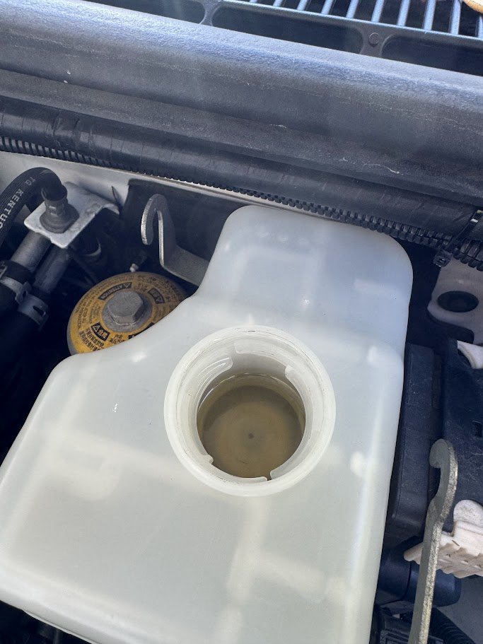

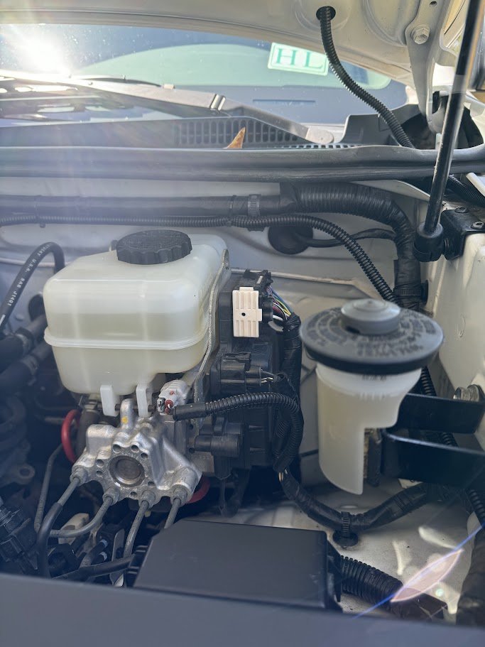

    Any merit in replacing the Brake/Clutch fluid on my 2013 Tacoma TRD Off-Road (Manual), I have had it since new, have 93,000 miles on it, and went to check the fluids and they are both clear, clutch fluid is in the reservoir on the right.
    I know it can't hurt to replace, but should I wait until it gets dirty?
    UPDATE: Thanks everyone for all the responses. I ended up replacing both fluids, and some takeaways for myself + anyone that comes to this forum in the future.
    It might be specific to the Off-Road trim, but to bleed the brakes you need to have the key in the ON position, as there is a pump that engages and forces the bleed, thanks to this thread: https://www.tacomaworld.com/threads/rear-brakes-will-not-bleed.629764/
    The brake fluid in the lines only slightly tinted yellow when I flushed it out, which I feel is pretty good for a 11 year old truck with 93,000 miles.
    One thing to note for the rear brakes, when you depress the pedal the pump engages and stays on until you take your foot off the pedal, it takes approx. 60 seconds to fill a 500ml bottle.
    For the fronts the pump only engages for a few seconds during a pedal press, and the travel of the pedal for the fronts is nearly double than bleeding the rears. FYI it took 47 pumps to pump through 500ml out of each front.
    A couple other take aways, and I feel like such a noob for this:
    • I struggled with the tubing I got to stay on the bleeder, I might have been able to zip tie it, but I feel like I have the wrong size (I followed a size suggestion from a YouTube video), when I was trying to get the tubing above the valve, it kept popping off, needless to say I have a puddle of brake fluid at each wheel, and all over the back of all my tires + calipers.
    • Seems like probably a good idea to use a bigger water bottle than 500ml.
    • Almost 5 hours start to finish (setup and putting everything away). A lot of that time was fiddling with the tubing/troubleshooting why the rears weren't bleeding, and trying to get the wrench in a good position to open the valves.

    Change it. This is basic maintenance. The fluid you'll flush through down by the calipers is guaranteed to be dirtier than what you see in the reservoir. Brake fluid is hygroscopic meaning it absorbs water from the atmosphere and becomes less effective and corrodes over time. Just do it, replace both.

    When bleeding the brakes the 2-person method, wedge a block behind the brake pedal to prevent further master cylinder travel which may damage the internal seal. This MC unit is very expensive to replace - just the part is $1K.

    Thanks for all the comments everyone! Did the transmission reservoir, and the fluid was actually dirtier in the line as it was mentioned here, not super dirty just a couple tints darker than clear. Been on the brakes for a few hours now and I think I might have messed something up, I am pumping the brakes (1-person method and nothing is coming out the bleeder, so I might have introduced air somewhere in the lines? Not from the reservoir though, as I wasn't able to empty that out with a syringe, since I can't get and/or there is no filter in the reservoir neck, so I have a 3/4 full reservoir. Just hopped on here to troubleshoot while everything is taken apart in the drive and it's pitch dark out now! :) Got to love learning, kind of wish I had taken it into the stealership to get this serviced instead.

    Bingo, that was the issue - now the problem is knowing how much to bleed, since the fluid is actually completely clear from the get-go!
