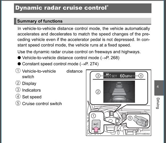

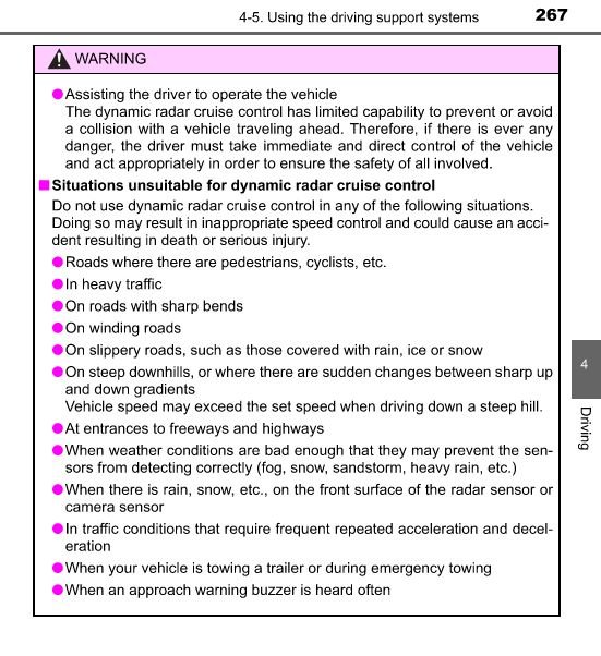

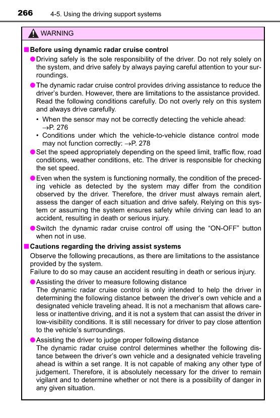

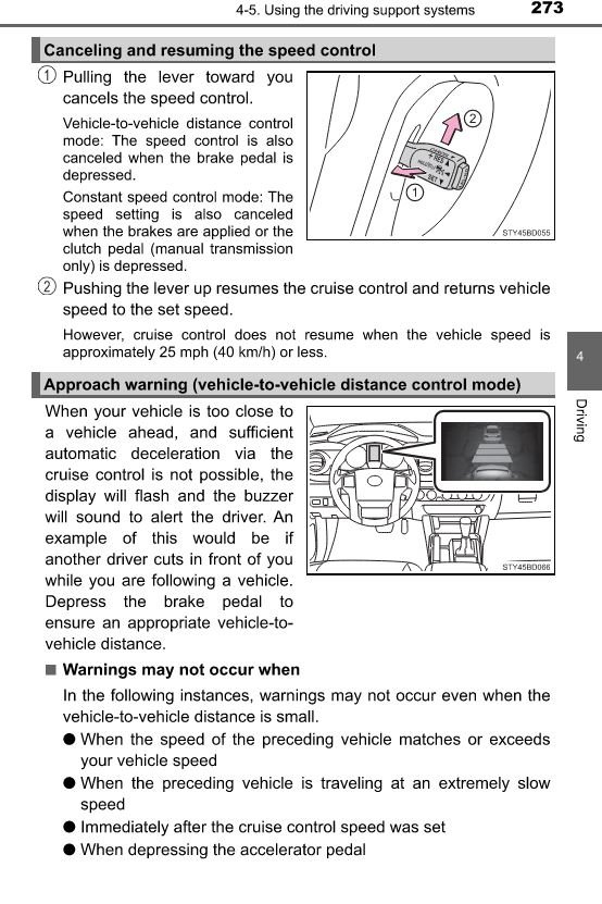

    You're describing the radar cruise control, which disables at something like 27 or 28 mph and below. It is not like some other manufacturers that will completely stop for you and resume cruise when traffic is moving, it will only brake to keep you at a safe follow distance down to 27-28 mph, then radar cruise disables (what you felt when the brakes were no longer being applied), and then the only way it will intervene from normal driving operations is to emergency brake if it detects a crash is imminent. In my experience, radar cruise control is best suited for the highway and not in town driving, there's too many variables in town to rely on it completely. Long press and hold the cruise button to enable "normal" cruise control that just maintains a speed with no adjustment for vehicle follow distance. Use the radar cruise on the highway, but even then it's not foolproof and still requires you to intervene in certain situations (i.e. vehicles in turn lanes close to you sometimes freak it out, and coming up on someone moving MUCH slower than you causes it to react pretty abruptly. Like others have mentioned, it's much safer to figure this out by reading your manual than to test it out to see it's limitations in live traffic. You can look here for a digital copy of the owner's manual:
    https://www.tacomaworld.com/threads/pdfs-of-tacoma-owners-manuals-up-to-2022.746660/
    Some relevant sections from the manual:
