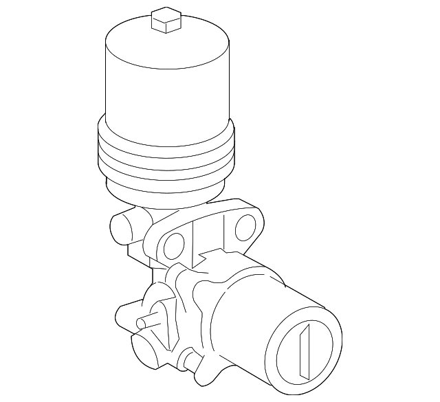

    Update/Edit: Well, I feel confident I bled out the ABS using the method I discussed. Still have the brake pedal issue, going to the floor on a very heavy press, and just soft to start with. Thinking it could be part/item 6 on the diagram. Attached at the bottom.
    Struggling with what I think is air in the ABS module.
    I have bled this system and many another with straight forward success. Read many if not all relevant postings here/elsewhere in regards to fixing it. No e-tool for now.
    Have the vehicle up on jack-stands/5ton lift and attempted to engage the ABS system to drive/bleed air out of that system. Some success, getting what I have experienced as ABS feed back, but in 4x4 mode; confused thinking/thought ABS did not function in 4x4 high mode, regardless I was getting the pedal, stutter feed back and ABS module working noise, hoping air bleed out of the ABS as well. Bled all four brake points again. Did finally see air leave the fronts, after three full 12 oz bled bottles full per line, prior with seeing no air. Thought I was on to success, but still having issue.
    Pedal will be hard but slowly lose pressure heading to the floor; two inches or so from the floor, ABS and brake dash light come on, then go off shortly as pedal bottoms out.
    Basics covered, no brake fluid leaks anywhere, brake reservoir always full and under pressure via Motive Brake Bleeder Kit, new pads/front and shoes/rear/adjusted. I have used just the Motive Bleed Kit, and the trucks built in electric assist pump (item 6 in the pics) to bleed. No codes thrown. No permanent dash dummy lights.
    Going to try activating the ABS system on road/tires and one more bleed round. Then Toyota... *grumbles*
