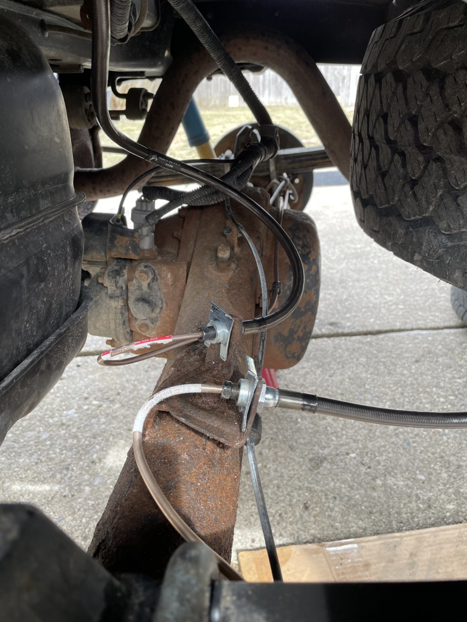

    Hey guys, question regarding my 2007 TRD OR...I replaced the calipers, pads, rubber lines with stainless, hard lines that go to the caliper, rear shoes and drums/hardware, rear cylinders, rear rubbers with stainless, and finally the rear hard lines that go from the cylinder to the mount.
    obviously all of this has led to no brake fluid in the system, so I bought a power bleeder and went to town getting in new fluid. All of this and the pedal is soft and goes to the floor.
    I’ve read on here that letting the reservoir go empty is a bad idea due to it not being possible to bleed the ABS pump, so I took the truck to the dealer to have them bleed it.
    The tech bleeds them but comes back saying that the pedal is still super soft but will firm up after being pumped and that I need to come back for further diagnosis for what he believes to be incorrect rear installation since the adjuster doesn’t line up perfectly with the window on the hub. Also that he didn’t need to use techstream to open the abs since the brake booster will let all the air out? I have an 07, so I didn’t think it worked that way.
    So fast forward to today, I take the rears apart with a buddy of mine who’s a mechanic and says that they’re installed correctly and that the tech is a moron who clearly didn’t get all the air out of the lines.
    So now that leads me here: is it more likely that the rears are installed incorrectly or that the tech didn’t bleed them properly by not opening the abs pump that’s causing a very soft pedal?
    ill provide photos if anyone has an idea regarding this. I also adjusted the rears so that they’re barely grinding when turning the wheels by hand like I was taught.

    Update: I adjusted the rears again following the diagram above which seemed to help. Still not perfect but much better than they were.
    no luck with the scanner, it just says not available when I try to auto bleed the abs. I might not be doing something correctly but regardless it didn’t work. At least the truck is drivable again, I’m going to do take it to a dirt road this weekend and go from there
