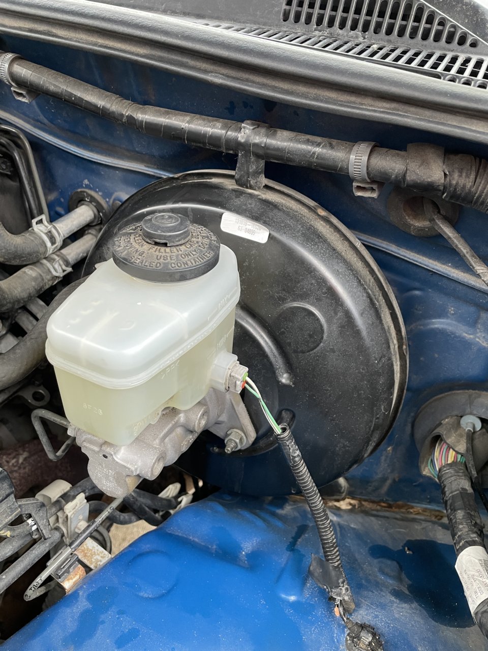

    standard vacuum booster.

    Background: by not paying attention during a brake fluid flush I let the MC go empty on my '09 and ended up with a very soft brake pedal and excessive travel. Repeated bleeding at the wheels helped not. And I did not have a bi-directional scan tool at the time.
    My '09 had VSC but also the same vacuum assistance you shown on your '07. I decided to bleed the MC using the factory procedure for the non-VSC system (attached below), followed by bleeding at each wheel, a few ABS stops on snow and then bleeding at the wheels again. This fully restored the solid brakes. If need be you could do this a couple of times.
