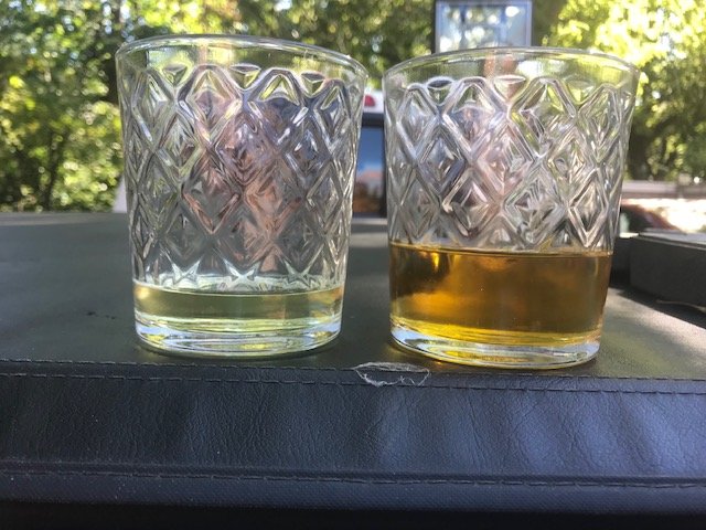

    I do mine every 3 years when I do my switchover from winter to summer tires and rims in my driveway. Since I have the wheel off anyway its just one extra step
    This is 3 year fluid I bled vs new fluid
