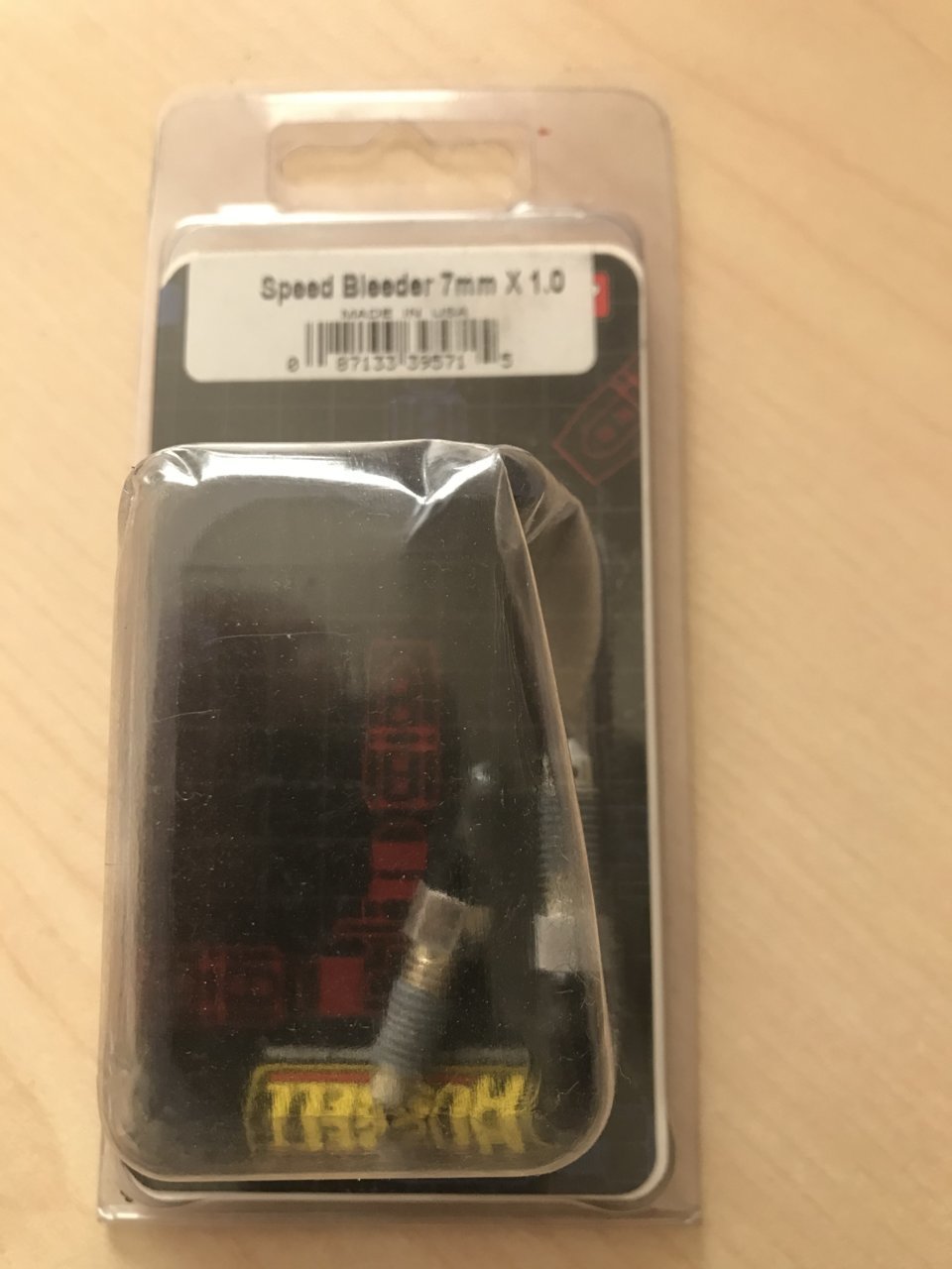

    Same question , am contacting Russell Performance, will post information I find.
    TnShooter likes this.

    Not our experience, they work very well, use them on multiple vehicles; have on the Tacoma front, but could not figure out part number for backs. Thank you for your thoughts and submissions.
