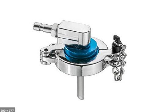

    I already have a homemade pressure canister for brake bleeding that I made with a garden sprayer and dial pressure gauge. I have used it in the past on my Ranger (with ABS) and a Nissan Versa (with ABS) - both with Motive caps.
    To do my Tacoma (have not done it yet cuz of other things going on), I got this Ares cap (18003-43mm) that's supposed to work for Toyota/Lexus (because they have no thread to hold a "normal" pressure bleeder cap):
