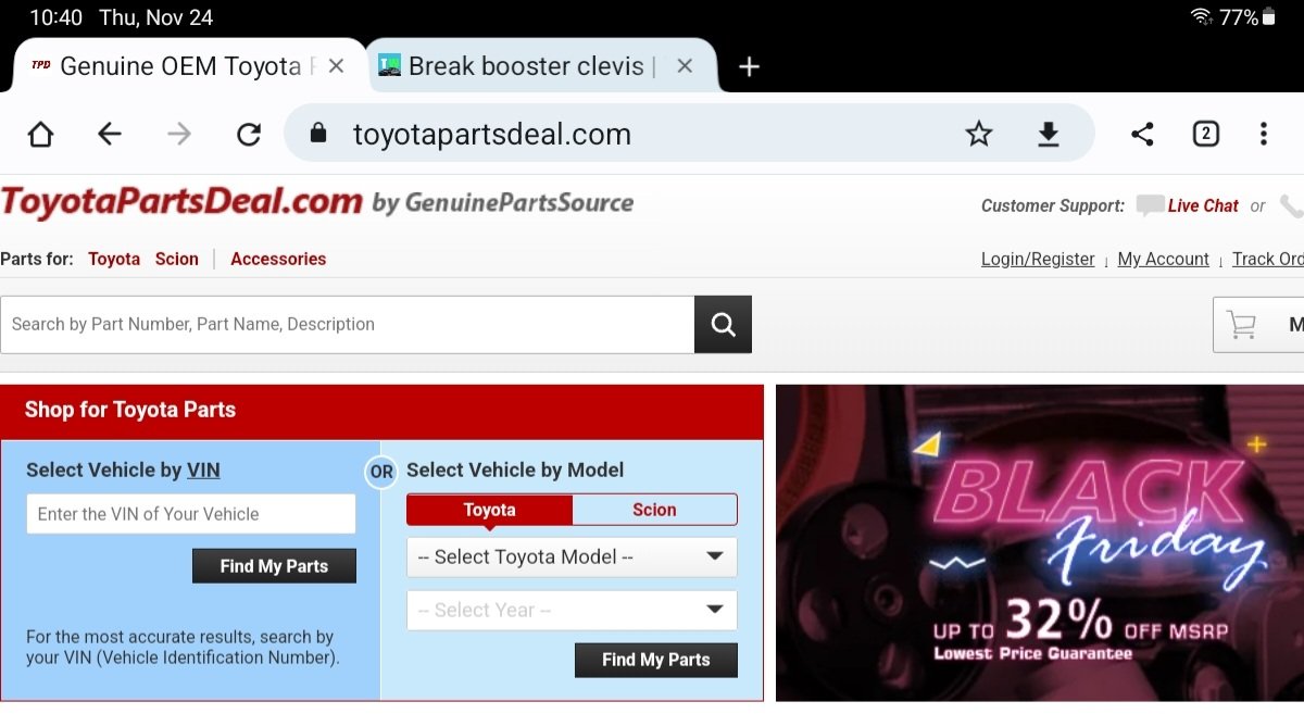

    I didn’t know it was possible for me to enter the vin on a website? What website would I go to in order to do this?

    Call the dealer with your VIN and get the correct part number. Then you can confidently search the aftermarket if you wish to do so.

    "Select Vehicle by VIN"
