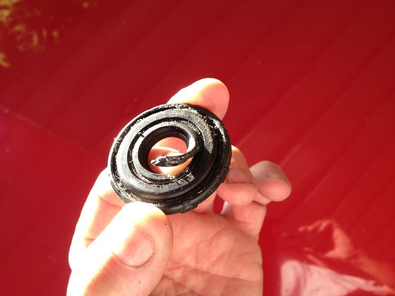

    This the seal that seals the master cylinder to the booster. When you pull the master cylinder out of the booster it stays in the cavity on the booster... you HAVE to install it on the master cylinder before you put the master cylinder back on the booster otherwise you will tear the seal as shown and have a vacuum leak. The symptoms are the brake pedal rises immediatly if you shut off the engine while you have your foot on the brakes. Another symptom is there is no "reserve" vacuum in the booster... you should get 2 to 3 assisted brake applications while the engine is off before the brake pedal gets hard. I put the paper gasket back on my master cylinder to booster flange.

    If its leaking there the seal were the master cylinder slides in to booster is bad.

    Actually just ordered a new master cylinder myself (aftermarket one by Centric 13044725). Would I need to order a gasket/seal to go between the master/c and booster? haha not even sure where to buy the gasket after searching around. Perhaps using RTV would be the ticket?

    Technically that gasket is just to seal it from moisture getting in.

    gasket part number. 47275-12020
    https://parts.camelbacktoyota.com/oem-parts/toyota-cylinder-gasket-4727512020

    Thanks Jon, always such a service to all taco-kind :)! Grabbing one of those right away.
    Looking up "cylinder gasket" for my model master cylinder and figured out I needed this one just in case someone else needs one for the same make: https://parts.camelbacktoyota.com/oem-parts/toyota-master-cylinder-gasket-4727524010
    Its always tricky trying to find the exact magic words to search for to find exactly what you need, haha.
