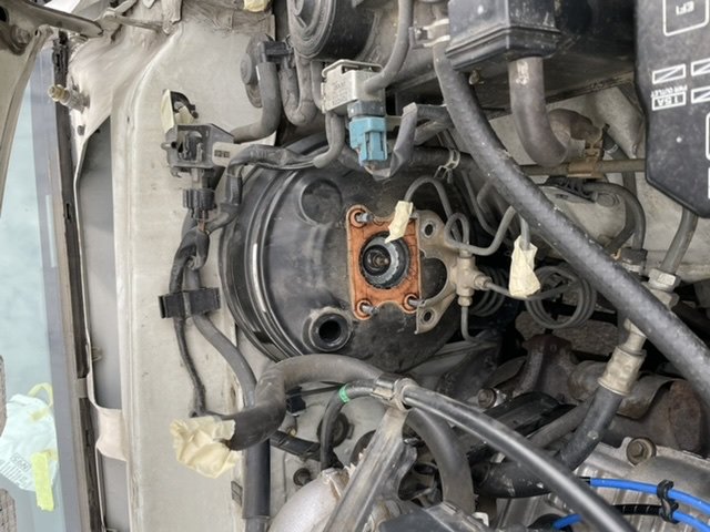

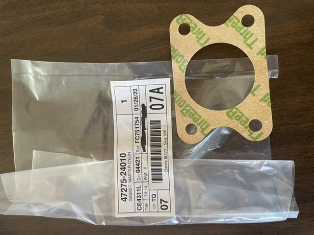

    Does anyone happen to know the orientation for the brake master cylinder and brake booster gaskets?
    Paper gasket separates the master cylinder and the brake booster, it has writing on one side, not sure which side to face outward.
    771A0E38-F3E4-40C0-8980-63E83E0D26EB.jpg 94C4209B-B4F7-427A-99F2-AD2297CE35A4.jpg 6CC6F26C-2164-4111-8A05-886123967C23.jpg

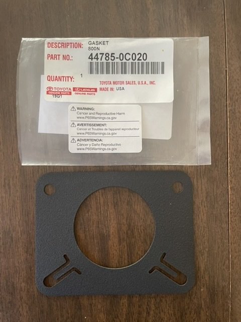

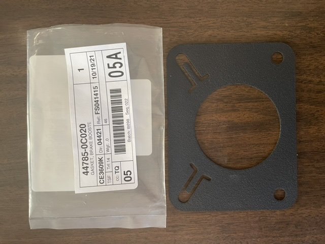

    The other gasket goes between the brake booster and the firewall, not sure which way it faces either, any ideas? It’s same on both sides but there are tabs on one end and holes on the other, not sure if holes go on top or on bottom.
    C257C1D1-7C75-42F5-A4A9-423CC908D031.jpg A9900B06-377C-445D-8AA7-35FBF9710F82.jpg
