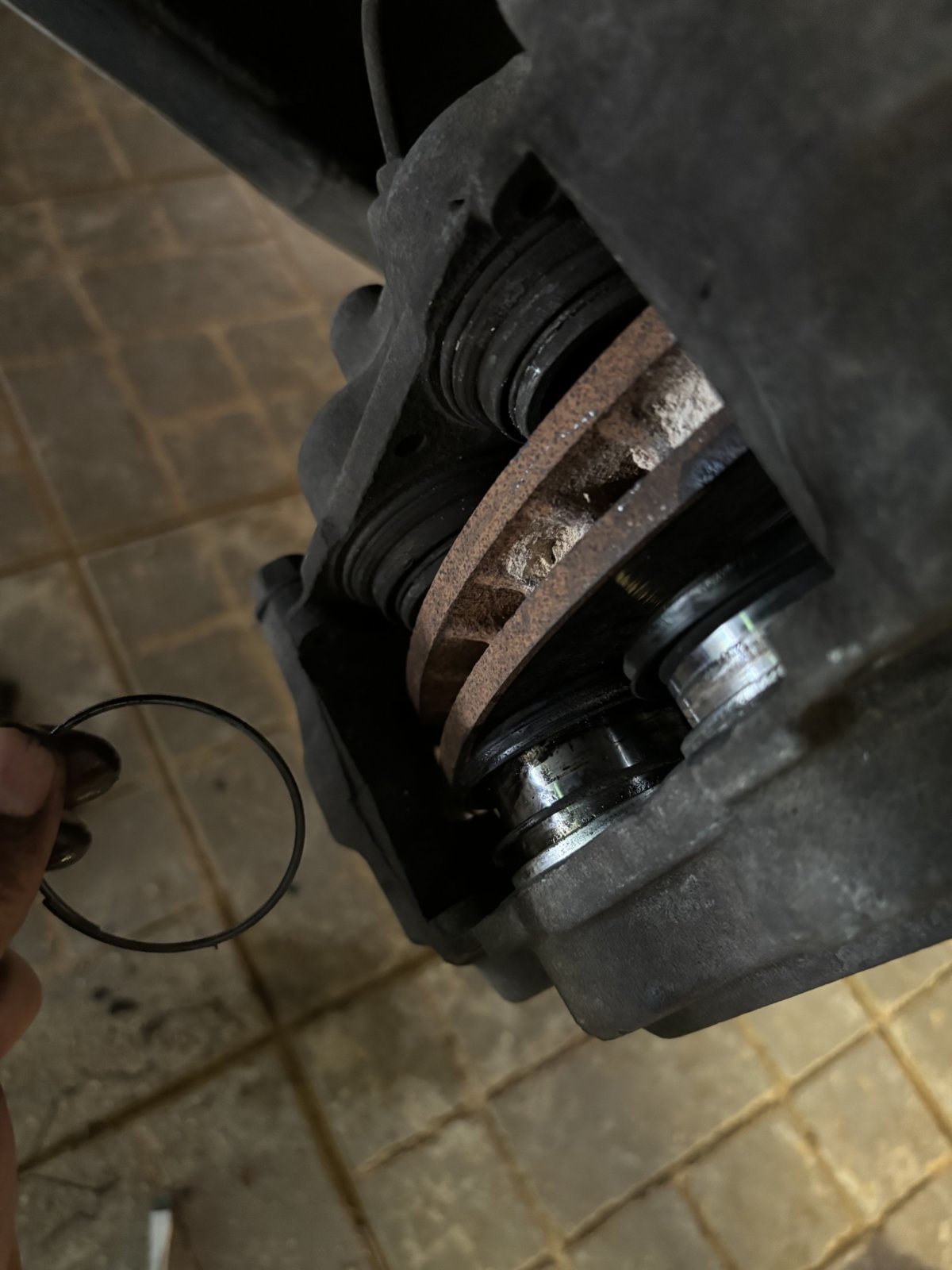

    Hey. I’m changing my brakes and I pushed on the pedal to push those pistons all the way out to fix the boots. Now it’s leaking brake fluid. How do I fix this? The leak and the boots? Thanks.

    Ok I pushed the pistons in and the leaking stopped. How do I get those boots and retainer rings back on?

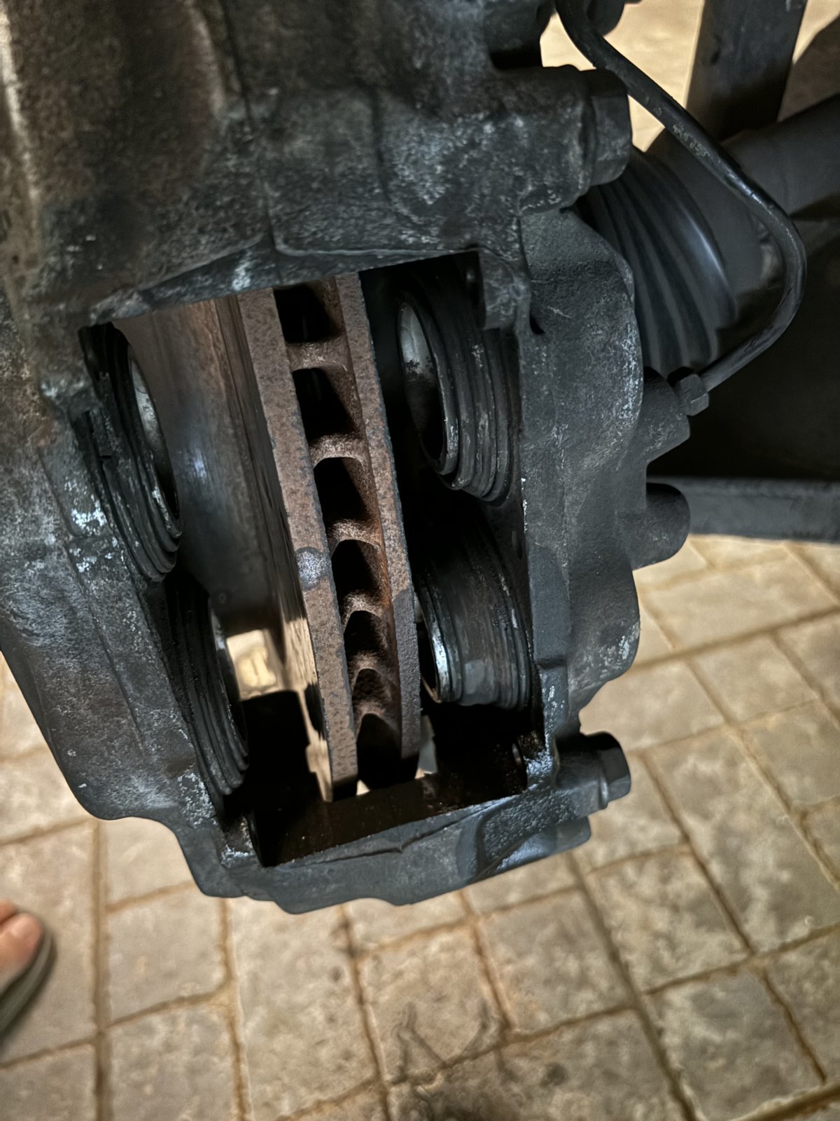

    so on this side one of them is stuck in the out position. I can’t get it to go in.
    any suggestions? I just want to fix it for now so I can drive.

    for any multi-piston caliper design, you really need to use a caliper compression tool like this
    https://www.amazon.com/Caliper-Ratchet-Expander-Spreader-Sextuplet/dp/B0BX693Z15/?th=1
    the issue is that you need to equally compress all 4 pistons equally at the same time to retract them-- without a tool like that, it's almost impossible to do--pushing one piston in will force fluid to another piston, making for a very long game of whack-a-mole. many local auto parts stores also stock a similar tool, and some also rent out tools like that if you're not interested in purchasing it.
    if you have two pieces of steel flat bar stock and 4 c-clamps, you might be able to get away with that, equally tightening the 4 c-clamps, but it's going to be a lot of monkeying around.

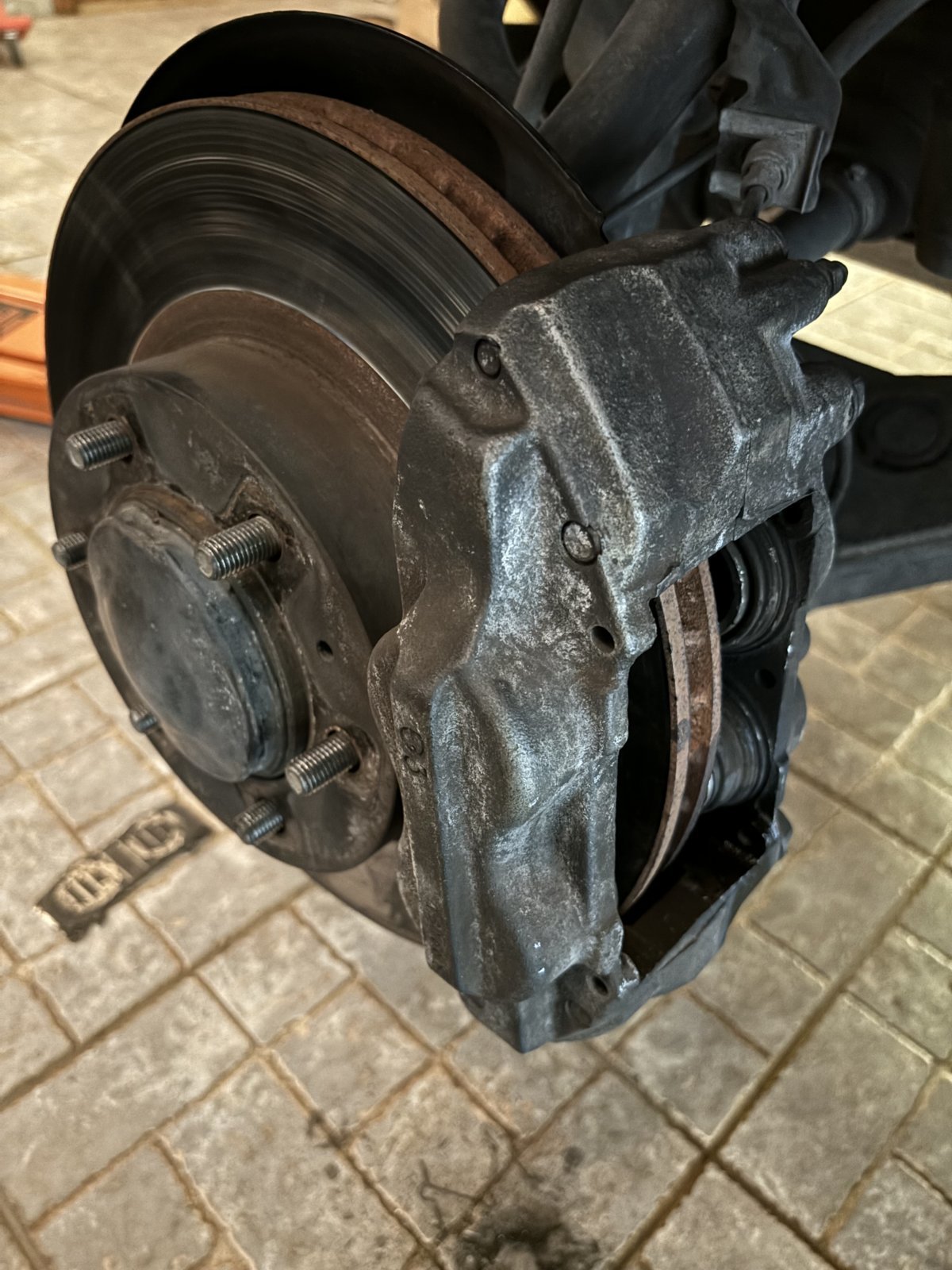

    also important here, you need to check your disc rotor wear-- more than likely, the rotor is worn down most of the way as well-- in the picture, there's a significant visible wear edge. it might only be halfway worn, but typically requires resurfacing to properly mate with the new pads.
    i typically replace pads and rotors at the same time. doing so also lowers pad-transfer issues, where the old pads developed rotor deposits, which then transfer to the new pads, and require rotor replacement later anyways.
    and critical because you leaked brake fluid on at least the one side-- you need to clean the components with brake cleaner to remove any brake fluid of the rotor surface, otherwise you won't be able to stop safely for some time until it burns off.

    To get both pistons in loosen the bleeder on the caliper and push them back in that way the fluid is not just going from one piston to the other. This will let the fluid go out the bleeder. If you do it slowly there is a good chance you won’t get air into the system and won’t have to bleed the brakes.

    It looks like you stepped on the brake pedal without one pad in and it almost pushed the pistons out, at least far enough to tear the boot. Never apply pressure to your brake pedal without something to press against. I could be wrong but looks just like what my nephew did.

    That’s exactly what I did lol. My bad.
