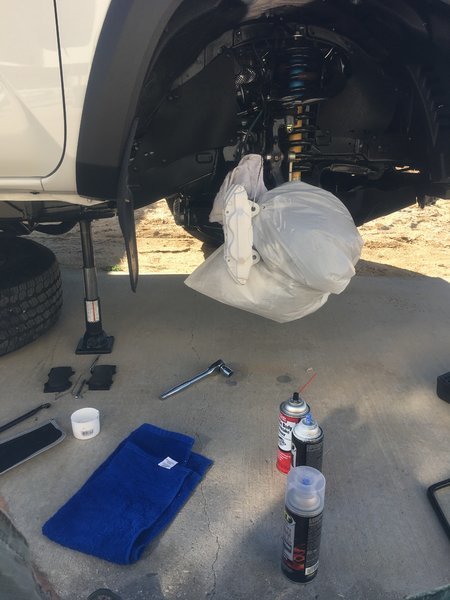

    Paint them man, I did mine a week ago and they look awesome, white is a little easier.

    Pictures would be nice

    image.jpg There you go

    How long did that take? Did you have to be careful of anything in particular?

    it took about 2 hours for both sides you just have to watch overspray getting on anything and use caliper paint, you could take them all the way off but then you would have to bleed them, I just wanted to mask it up..

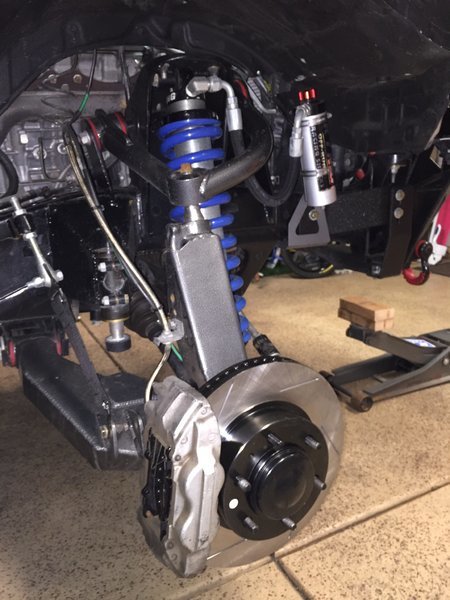

    It's a piece of cake, just unbolt the calipers and pull the pads out and tape off the actual Pistons. Re grease the back of your pads with some copper grease where the Pistons contact when you reinstall them. Just be aware that you will have to touch them up over time even if you use caliper paint. Brake dust is seriously corrosive shit it even eats chrome and brake fluid wipes the paint off like it is water colors. I kept mine silver because I didn't want the ricer look...just wanted them to stay bright and clean looking a little easier...but you can see that they need to be resprayed after approx a year :

    That spindle is beefy as F$#&

    Ok, your (LT?) front susp. Is sexy as all get out. Jus sayin.
    And so clean!
