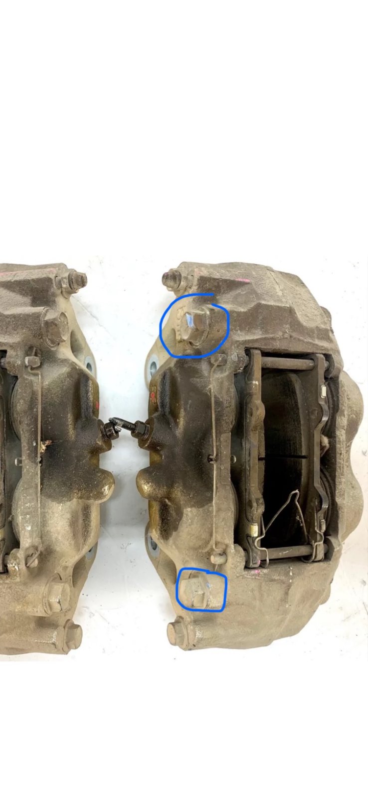

    I was replacing my pads and rotors on my 2019 Off Road and accidently took out the wrong bolts on the back of the caliper. I took out the 2 bolts that hold the caliper halves together.
    Does anyone know what the torque specs are on those bolts?
    I have not found an exact answer but one I saw said 90 ftlb. Is this correct?
    Thank you

    90ft-lbs sounds like a calliper to knuckle torque. I don't know the spec but I would guess somewhere in the 15-25ft-lbs range.
    Don't go crazy but i'm sure the torque isn't critical there. Just tighten it reasonably...

    uhhhh, that info may be found from a brake specialist.

    Post a pic of what you unthreaded.

    Not sure if same for 3rd gen but under 2nd gen sticky's says torque spec 91 ft lbs for 4wd and pre-runner. Standard was 80 ft lbs. Check it out. It has pages from the manual.
    Sorry, Mis-read where you un-bolted caliper. Still take a read. Might find it

    thank you, that is the best thing I found as well but wasn’t sure if it was the same for third gen’s.

    Is it a 17mm……like the 2nd gen?

    Yes it is a 17mm
