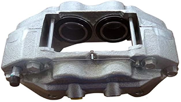

    need some help.....did toyota change the design of the gen2 front brake caliper at some point?
    further to the point....my OEM calipers have two micro cotter pins for the caliper pins (one for each pin)
    & the new calipers I got at the dealership have one long strange shaped cotter pin (of sorts) that ties both the caliper pins together & tucks itself into a predrilled hole on the caliper body
    thanks folks!

  10. Dec 13, 2020 at 6:42 AM
    Chiloquin_Car_Care
    Chiloquin_Car_Care [OP] homie dont play that
    Feb 6, 2019
    #282033
    960
    Oregona
    2021 voodooblue DCSB 4x4 3.5l v6
    nada....maybe a license plate one day & BA bumpers
  11. Dec 13, 2020 at 6:56 AM
    Chiloquin_Car_Care
    Feb 6, 2019
    #282033
    960
    Oregona

    I never liked the dual cotter pin design so I used some aviation grade safety wire to hold the pins.
    If you look closely, the inner pad was installed backwards so I had to do this twice!

    I run two micro cotters on the pins. It came that way stock and is still that way now. They are supposed to be that way. No issues. Ever.

    My 2011 has the single cotter pin. My 2000 had the same.

    1 or 2 pins doesnt matter. as long as the pad pins are captured thats all that counts. as far as an "upgrade" IMO the single one just idiot proofs the fact that techs didnt forget to but both in. would just think it all depends on what year your truck is and if you or the person before you took it in for a factory brake job.
