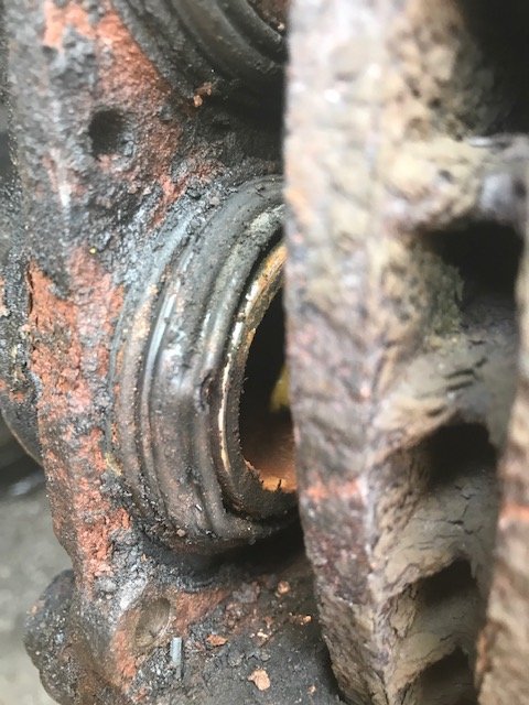

    after only 4 years the passenger side caliper is in bad shape. torn piston books and one of the piston is siezed and cant be pushed back.
    Anyone had calipers go bad this soon? :frusty::frusty::frusty:

    i have never seen this type of damage to a caliper piston boot. These is nothing i can think of that could have cause the visible tear/hole shown below..
    Its only been dealer serviced so am suspicious that this was done when they last cleaned and serviced the brakes... :annoyed::annoyed:
    Piston above this one was frozen.

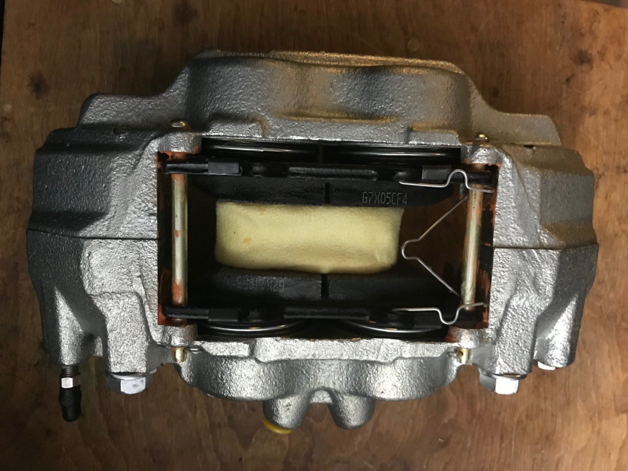

    rebuilt caliper all setup and ready to install. looks like aftermarket is using a piston boot seal with a wire ring for retention. didnt see this on factory boots.
