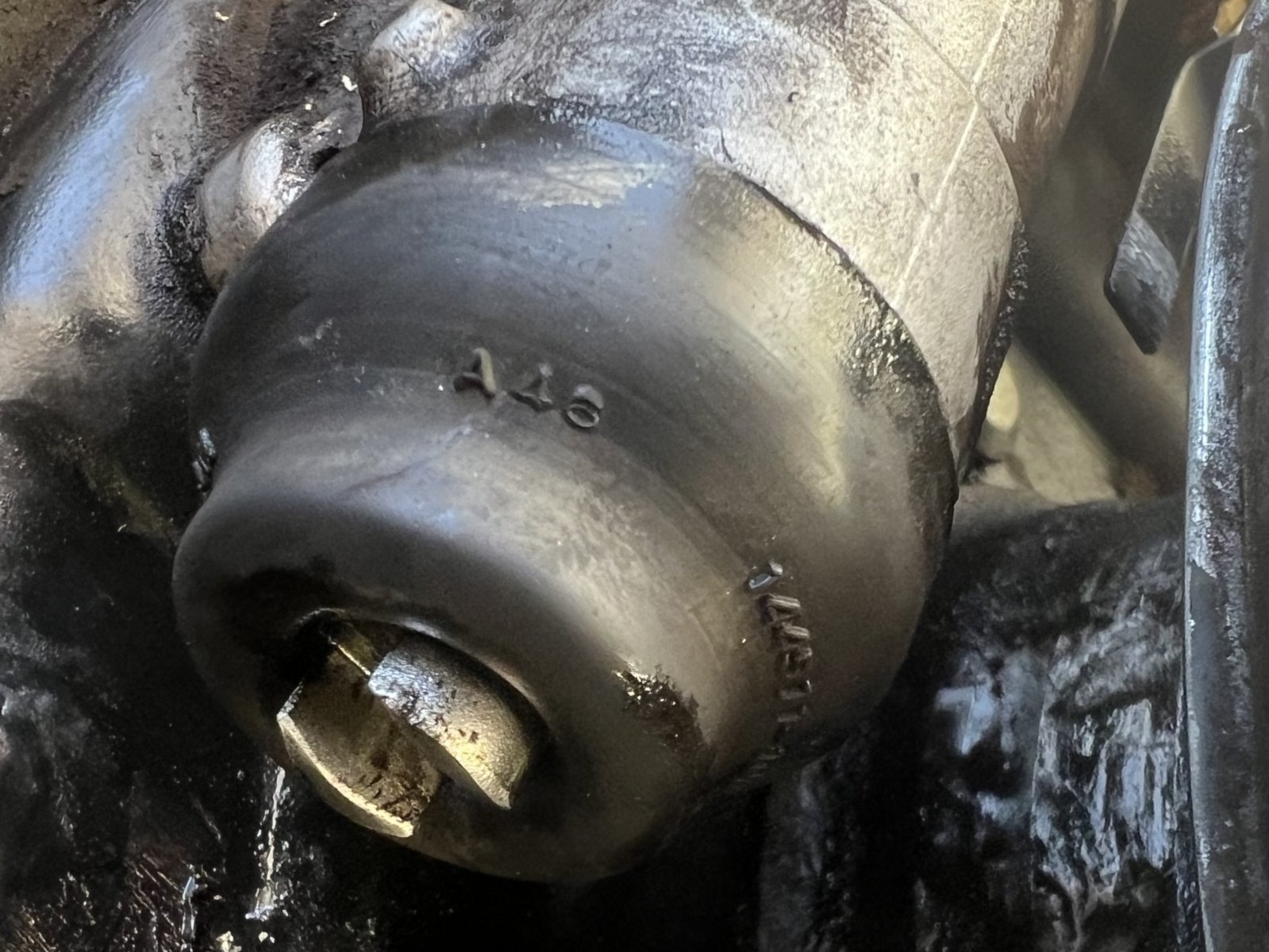

    So I’m changing my drum brakes and I managed to do this. Anyway I can fix it or do I have to replace it now? Thanks!IMG_3666.jpg

    slide it back in and bleed.

    It's kinda like sex, just wiggle it around a bit until it slides in. Yes, you may have to bleed it. If it did leak, pull off the rubber .........boot and rinse it all out with brake cleaner or it will attract water and then rust.

    Thank you did the replies. I did manage to get it back and all reassembled.
