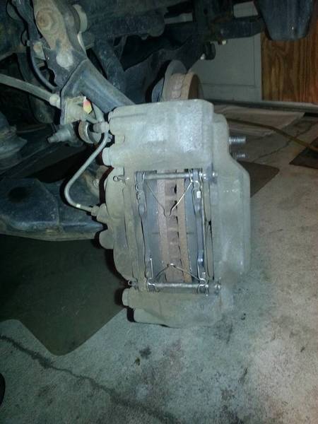

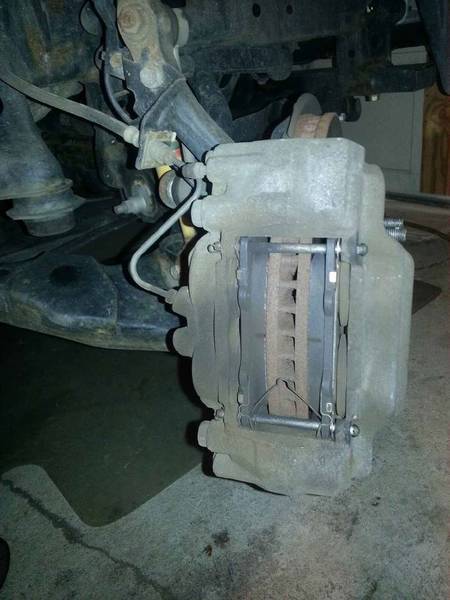

    Big thanks to JBCjr http://www.tacomaworld.com/forum/member.php?u=89421
    JBCjr beet me to a possible fix and came up with some springs that apparently take care of that nasty clunk we all get as our brake pads age . He sent me some pics to post .
    You got a part # ? I want some of these bad !!!!
    With this said , the additional spring will fix a click sound on a slightly worn brake pad and is a cheap fix to keep the noise to a minimum . Use the brake quiet stuff I have listed above or similar to lube and seat your old brake pads . Just adding the spring without any additional maintenance to the brake pads may not help on a trashed set of pads . When I say trashed , your brake lining may be fine but metal to metal wear points may be above tolerance. The additional spring is not a miracle cure . the additional spring assists the break pads from rocking on the stop pins . Inspect your brake pads closely . The pins are also known to wear over time .When you remove the brake pins , make sure they are the same size all the way through the length of the pin .All it takes is a little movement on an old set of pads and its going to clack or clunk . You are stopping a 4000 pound truck with the front brakes every time you come to a stop .If you dont regularly use your emergency brake which keeps your rear brake shoes adjusted , you are going to wear your front brake pads prematurely . The play in the front pads and hardware will be minimal and difficult to see but it will clunk and clank under load .

    Alloutdrs1
    Alloutdrs1 Well-Known Member
    Feb 28, 2012
    #73780
    1,164
    Andrew
    Virginia Beach, VA
    12' Mag gray Doublecab 4x4
    Distinct Offroad light bar, Rigid E-series and amber duallys, Leer 100xq, Oem roof rack, Oem bed mat, Bullculla trailer plug relocate bracket, Rear diff vent mod, front mud flap chop, Color matched Grille w/Andres devil horns, Wet okoles and weathertechs
    I have the part number posted above, they are the stock Toyota springs you are just adding one to the top of the pads.

    Alloutdrs1, I replaced my original oem;s breaks last December, with Porterfield pads and the calipers didn't look right with just a bottom spring clip. I don't recall the price. I'll be rotating my tires this week and get a pic of the pads for wear, Thanks gearchruncher for your help with posting pictures

    Glad I could help and thanks for this :)
    I get some weird looks from people when i hit my brakes .Very noticeable when the windows are down .
    If this actually fixes the noise , Im gonna be a happy camper . I had a different approach to fixing this problem . The issue looks to be resolved by simply re-lubricating the caliper stops and mounting points but I can sure see where the extra spring you guys added come into play and its an easy fix worthy of a sticky thread .

    I added the spring to mine and it solved my issue, mine were making the noise over big bumps as well and that has also ceased with the addition of the spring. It should have two from the factory IMO.
