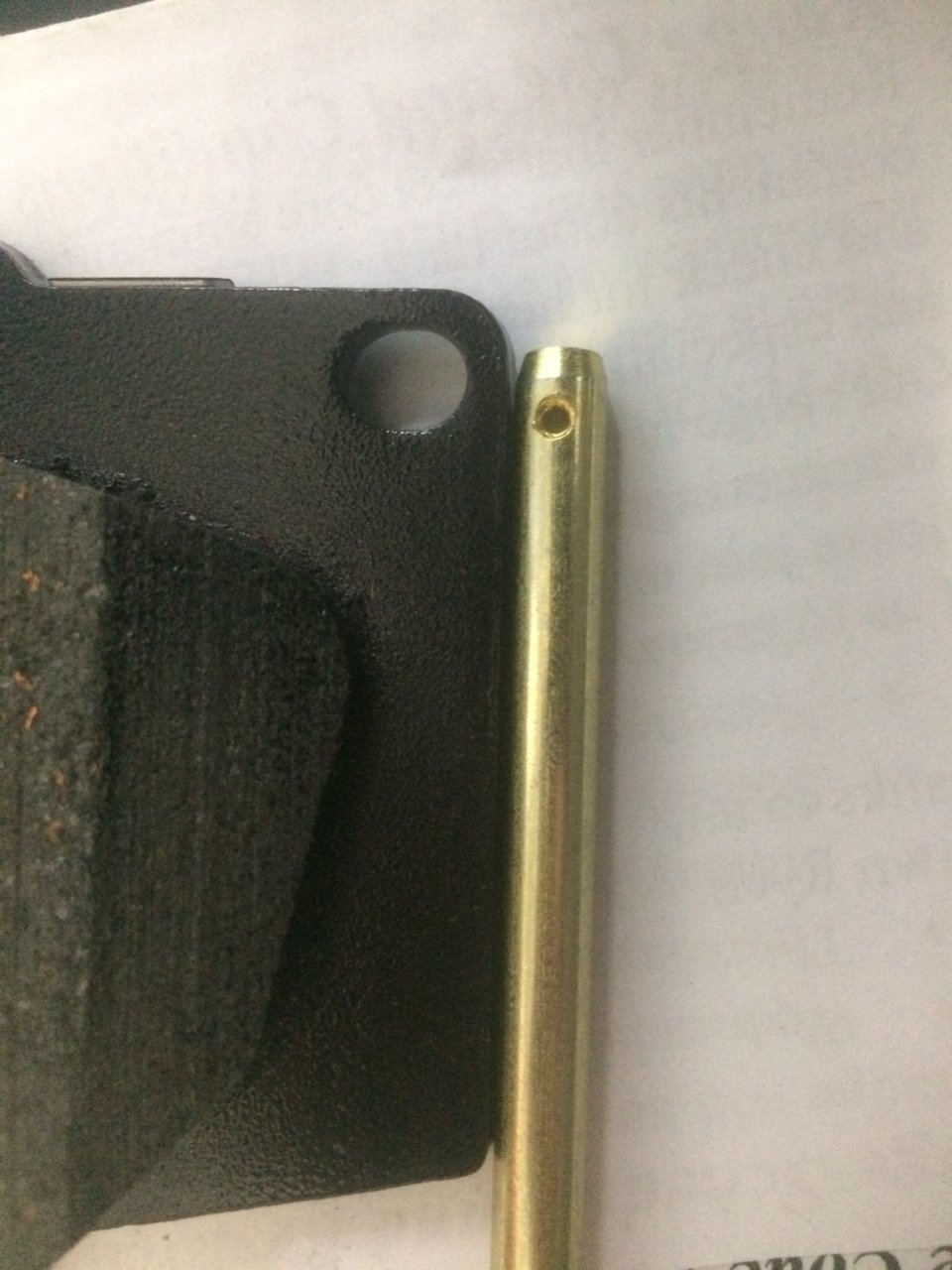

    watched a video of a brake pad change on a tacoma and have a pretty good idea of where some of the noise come from.. the tacoma pads just drop straight down into the calipers (no slots,clips etc) (think paying cards in the box they came in ) and retained solely by the pins..
    now there has to be some clearance between the end of the backing plates and the calipers to allow them to move and not get jammed up when they got hot and expand.. And looking at a brand new akebono pad i have in my hands the slots the pins go through are also bigger than the pins to also allow for some movement also
    So just like a deck of cards can move around in the box they came in, so can the pads move slightly back and forth in the calipers..
    i have uploaded a picture showing the straight end of the backing plates that drops in the caliper and the fcat that the hole for the caliper pin is larger than the pin..
    so i wouldnt worry about a small amount of noise since this means that things can move as they should.
    a total lack of noise might mean somethings jammed up
