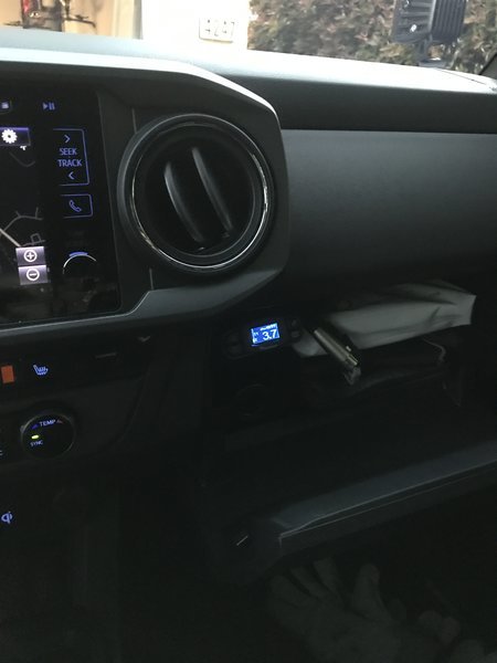

    Hello TW,

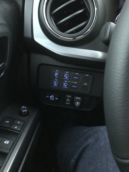

    I cannot find a place to mount the damn controller without have the possibility of ripping the damn thing off with my foot when I get it. I have the Tekonsha P3.
    I was thinking the glovebox, has anyone done this?
    I cannot fit it in that cubby on the right side of the wheel because my switch pro panel is in there.
    Your thoughts please?
    Thanks,

    What about the cubby hole on the lower LEFT side of wheel?

    Thats what I meant to say. I mix up my right and lefts. Sorry. That is where my swich pro's is.

    I mounted it in the glove box. I love having the controller and happy that I found a space that would compromise the clean interior and leg room.

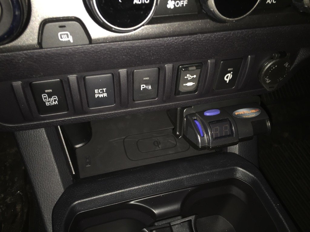

    I mounted mine in the charging cubby. No longer a knee knocker and installed within arms reach. Cubby can still be used. Just make sure you mount it far enough back so you can still use the cup holder.

    In my first write up I made a mistake, in that left cubby I have a Switch Pros panel so that eliminated that option right away.

    I made sure mine is within reach. It's very accessible. Due to the fact I rarely tow with the Tacoma I pray that this is fine. Just annoying that Toyota does not make a stock setup.

    Here are some pics

    Did you have to extend your pigtail for this install? Also how much dissembling did you have to do to mount the base?

    I did have to extend the harness so it would reach the drivers side kick panel. I had to remove the radio and heat controls in order to fish the wires. By cutting the harness and splicing in longer wires, it allows you to drill a smaller hole in the cubby to pass the wires through.

    Thanks for the reply. Ill try it in the glovebox and if it turns out to be unsafe ill relocate it.
    I can still change the gain fairly quickly just pop the glove box. I love not having it visible, thats the thing.

    This is not for me to be in defense of my install, I will be taking extra time to fine tune the gain when hooking up any individual trailer. Just the inconvenience it will case by having it up in front and kicking it every time can be a pain in the ass also. Just would be one hell of a story if the glove box lock fails.
