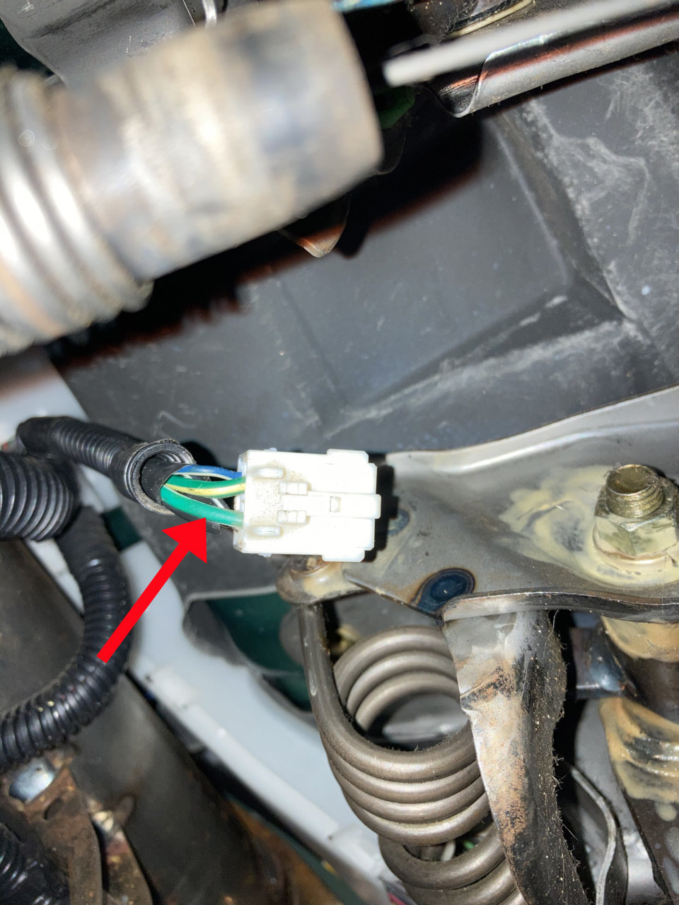

    Hi All, I am trying to wire a Brake Controller into my 2004 tacoma 3.4 MT and can't determine which wire on the stop switch to tie into ? Does anyone have any experience with this or can identify which wire ? From the Harness it appears that there are 4 wires, a Green/Yellow, Green/white, Black/White, and Blue/White.
    From my understanding the Green yellow is power to the switch until the brake pedal is depressed ?
    Also was wondering if there might be another location where I could tie into the correct wire as there is very little space/wire available in the current location.

    From "Curts" instructions, your supposed to tie into the stop light switch on the cold wire which is under the dash, the harness that connects to it has the 4 wires that I mentioned above.

    The Blue/White Stripe goes to the cruise control
    The Black /White Stripe might be cruise control
    Green/Yellow Stripe Always powered from the brake fuse
    Green/ White stripe to the brake lights
    Always double check with your Meter
